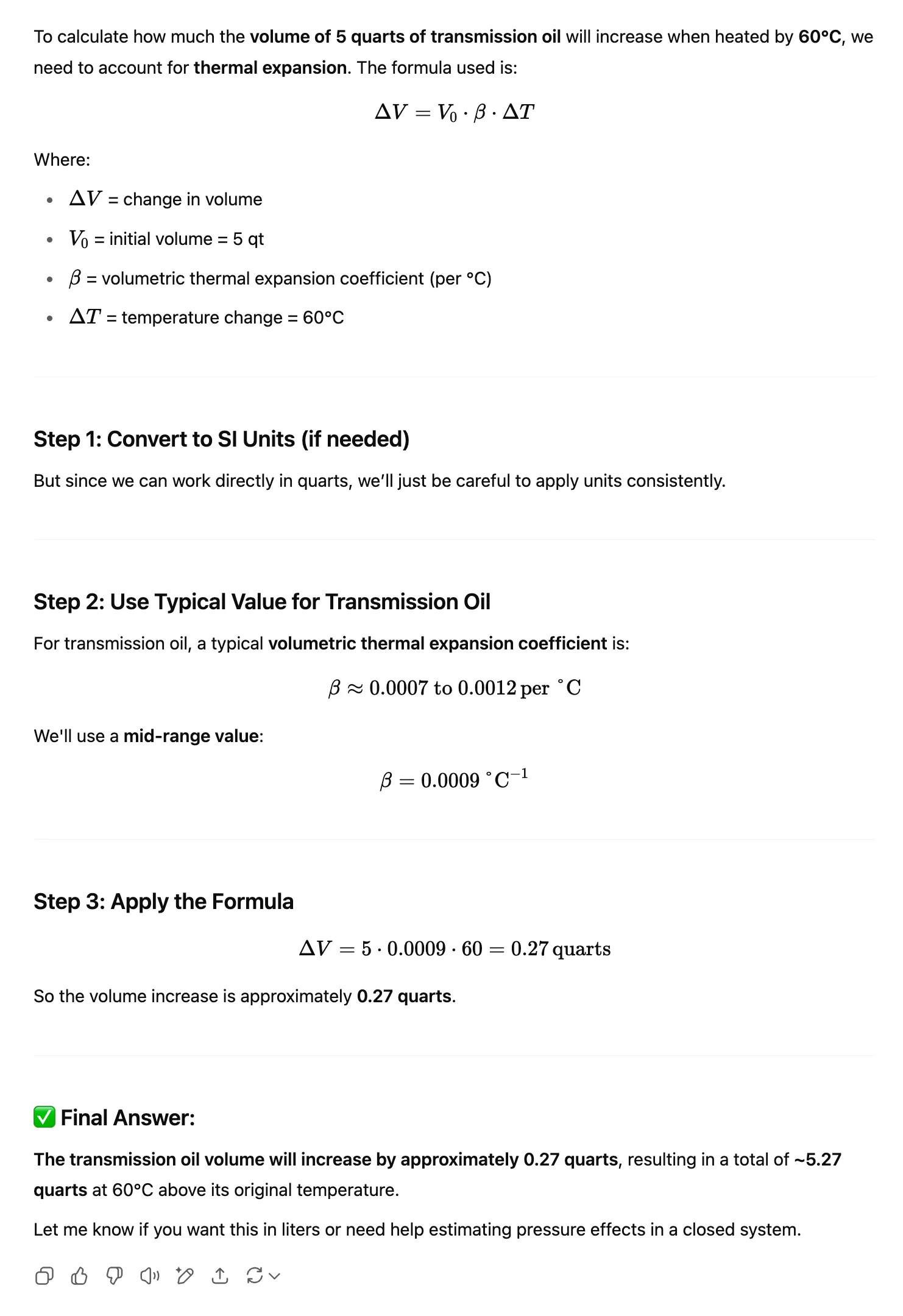

1. New oil pan hold extra 5qt oil when temp reach 90C(running temp) 5qt will bt 5.27 qt. Seems not a big deal.

Not to get pedantic but accepting the invitation to get to that level of pedantic precision with the above nice, neat science textbook equations, several real world variable departures from the artificial lab excitement data: a) the above formulas are premised on 5qts & my 2013 570 with the tow package has a dry 12.3 qt capacity (ie almost 2.5x greater) & b) with the B&M pan’s extra 3.5qts, it raises the cumulative capacity to 15.8qts, or a bit over the 3x 5qts. b) I live in the south and I never see a delta at operating temps of 60C, or 140F. Currently in the summer I’m starting at an ambient temp of 80F and my trans temps with the extra fluid and therefore heat-soaking / dissipating dynamics = my trans temps operating in the 184-189 range (don’t tow, as I have a diesel pickup for that). So my trans temp delta is around 100F, or 38C. Haven’t run the math to derive an expansion of volume level to the thousandth decimal place & will defer to others to do the number crunching to arrive at the expanded volume to 3-5 decimal places, but 1) as the OEM solution would be subject to the exact same thermodynamic fluid physics but 2) as I have greater volume but run at cooler temps… my guess is the delta between each is de minimis at most (quick math in my head maybe 0.1 qt delta at full operating temps when offsetting increased volume by lower temps)… I agree with the science textbook math, sure thing. But these rigs ain’t F1 race cars custom-built by Ferrari with extremely tight tolerances across all operating parameters, nor failing / blowing up due to running some de minimis lesser or greater ATF fluid due to fluid dynamic expansion within that tight of a tolerance. The physics outlined in a vacuum are correct for a 10th grade science test Q, but not especially compelling nor illuminating as applied in the 200-series platform under real world operating conditions…no?
I know that the math isn’t your point btw: you’re agreeing w me that a previous poster’s chest-beating trump card re increased fluid pressure fundamentally misunderstands, well, basic science. To your direct point re replacing all of the solenoids…!contemplated it for PM reasons but the only solenoid for which i was getting an error code was only the SLT solenoid & the symptoms presented were consistent with a crapped out / malfunctioning SLT solenoid. So just replaced the single SLT solenoid. Aaaargh….!transmission internals voodoo is quite opaque indeed!
