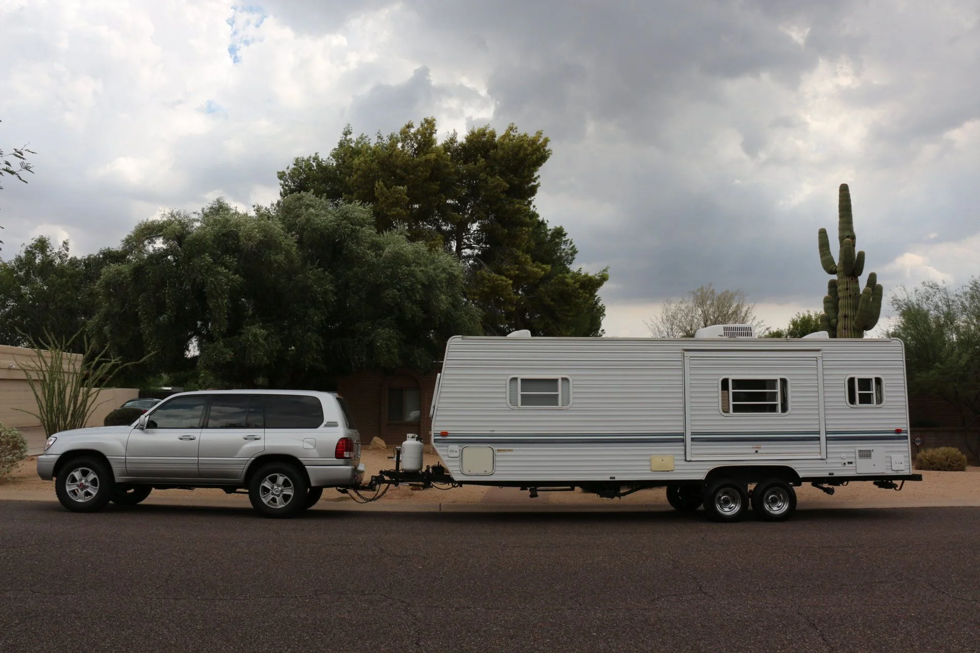

I pull our boat (5000#+) regularly with AHC. I set it up AHC pressures to pull the boat using rear air bags with zero issue. Using the same system I have pull a much larger trailer with an equalizer hitch. I had no problem but a little too much for the Lexus IMO with 850# of tongue weight.:eek:
