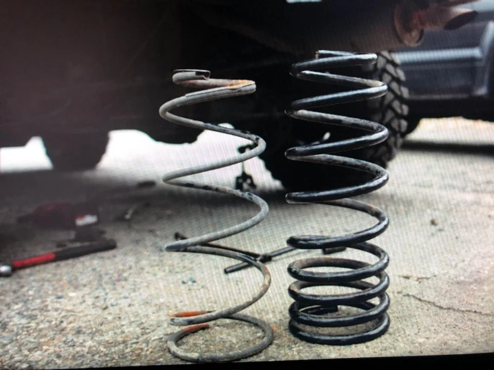

LX470 so different cup of tea but here is what I did over a year ago, still working great! I added Old Man Emu medium duty springs to the rear of the truck, 2 reasons I did this, first of all the rig was starting to have a hard time keeping up with all of the weight added to the rig, second and proly more important running trails like the Rubicon with AHC our plan was simple, if the AHC took a S**T the strong rear coils and LC torsion bars would still get me off the trail. The system works perfect both on and offroad and drives great, only side affect is ya can't go into low mode, but I'm way beyond getting this rig into low mode 🤪

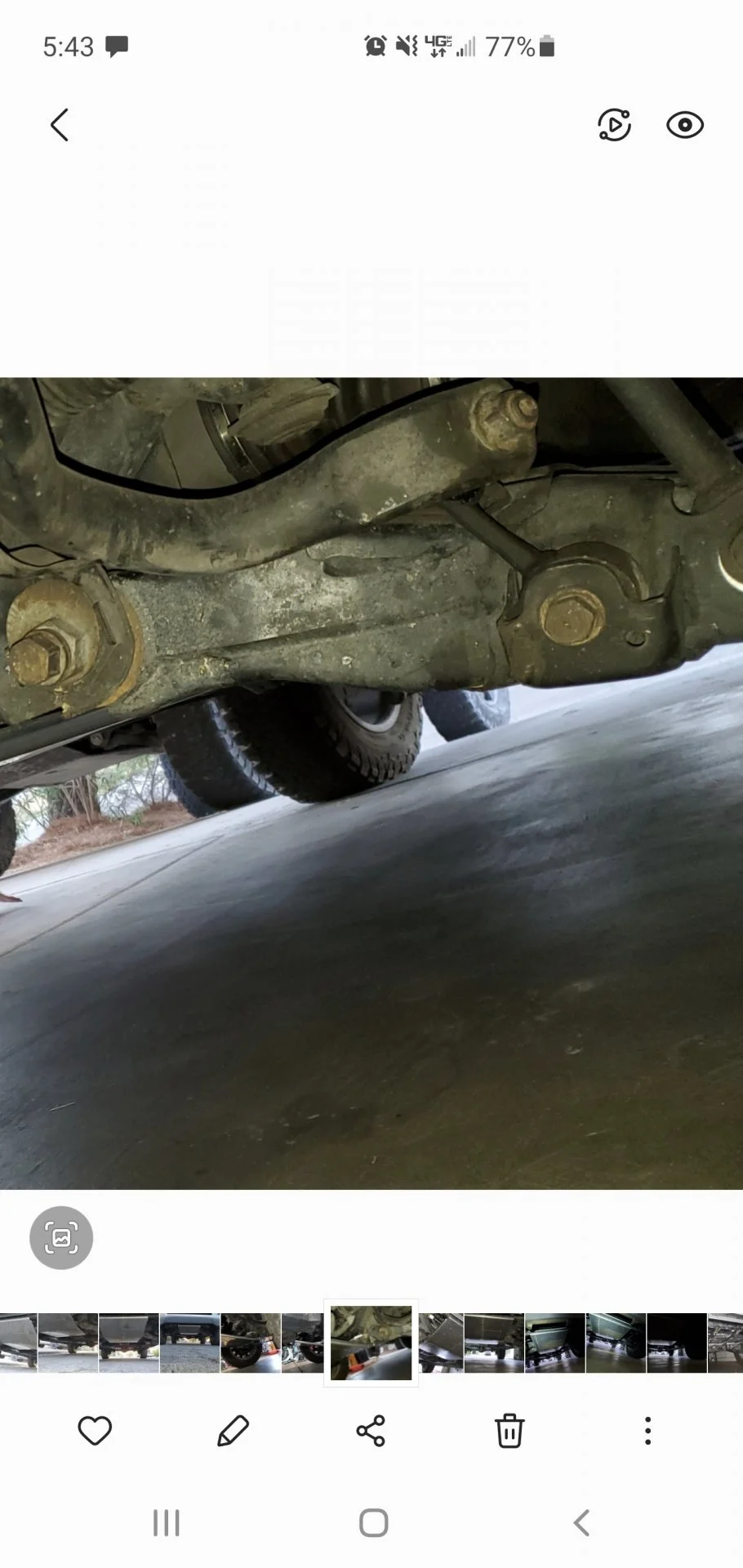

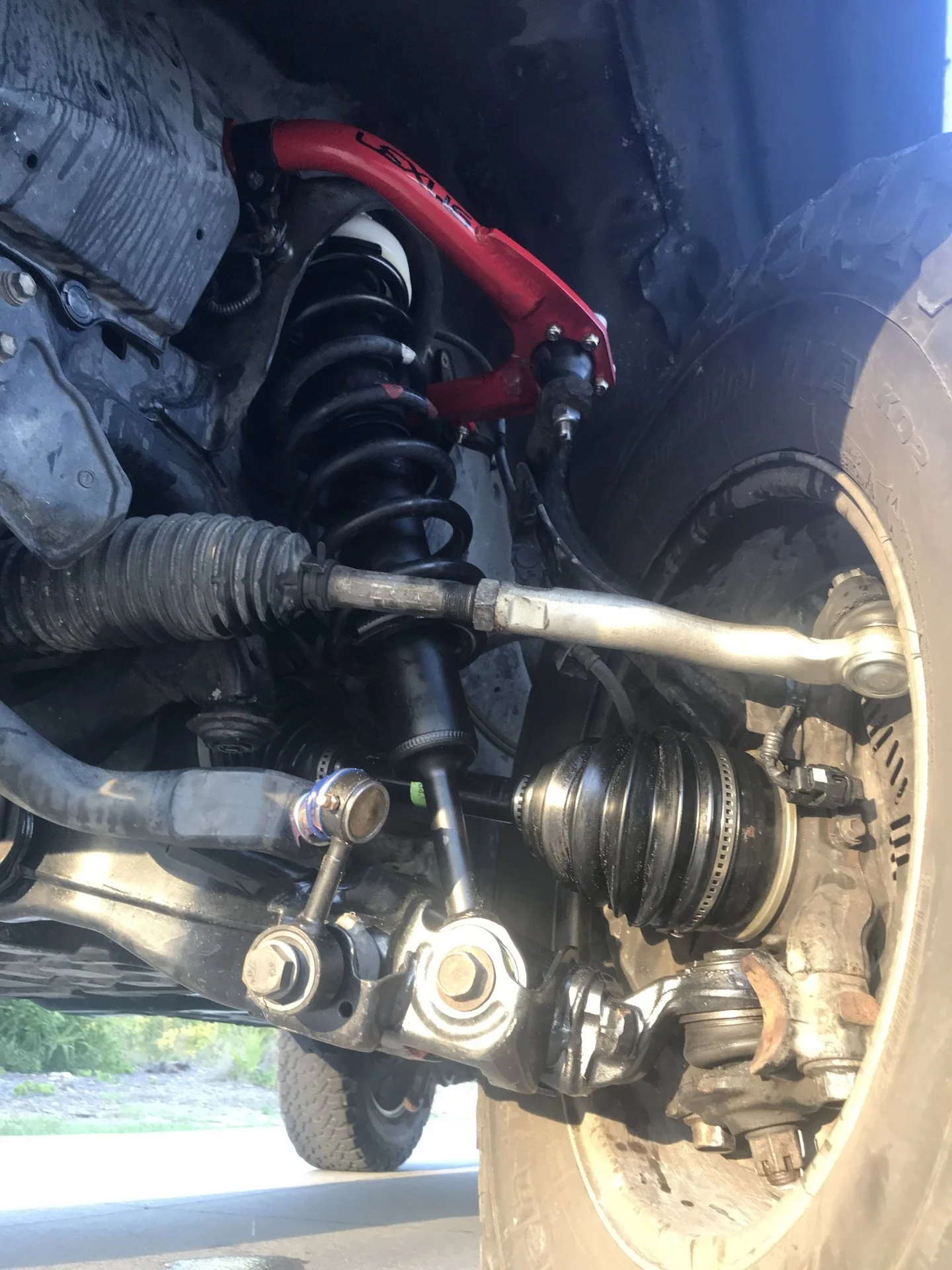

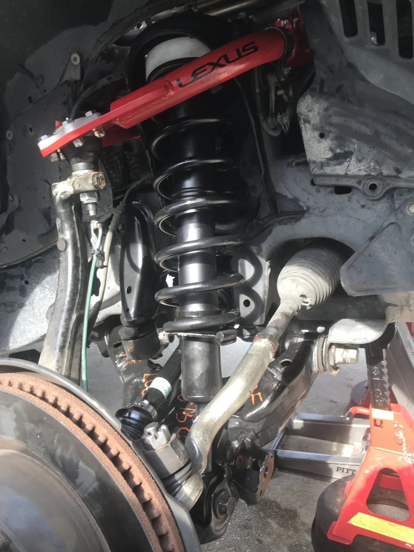

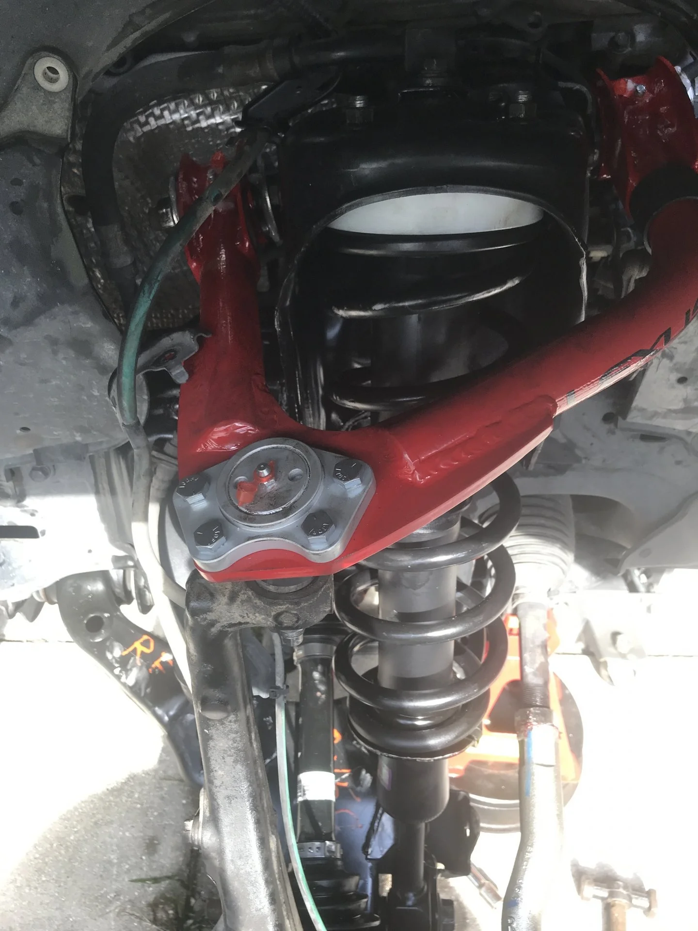

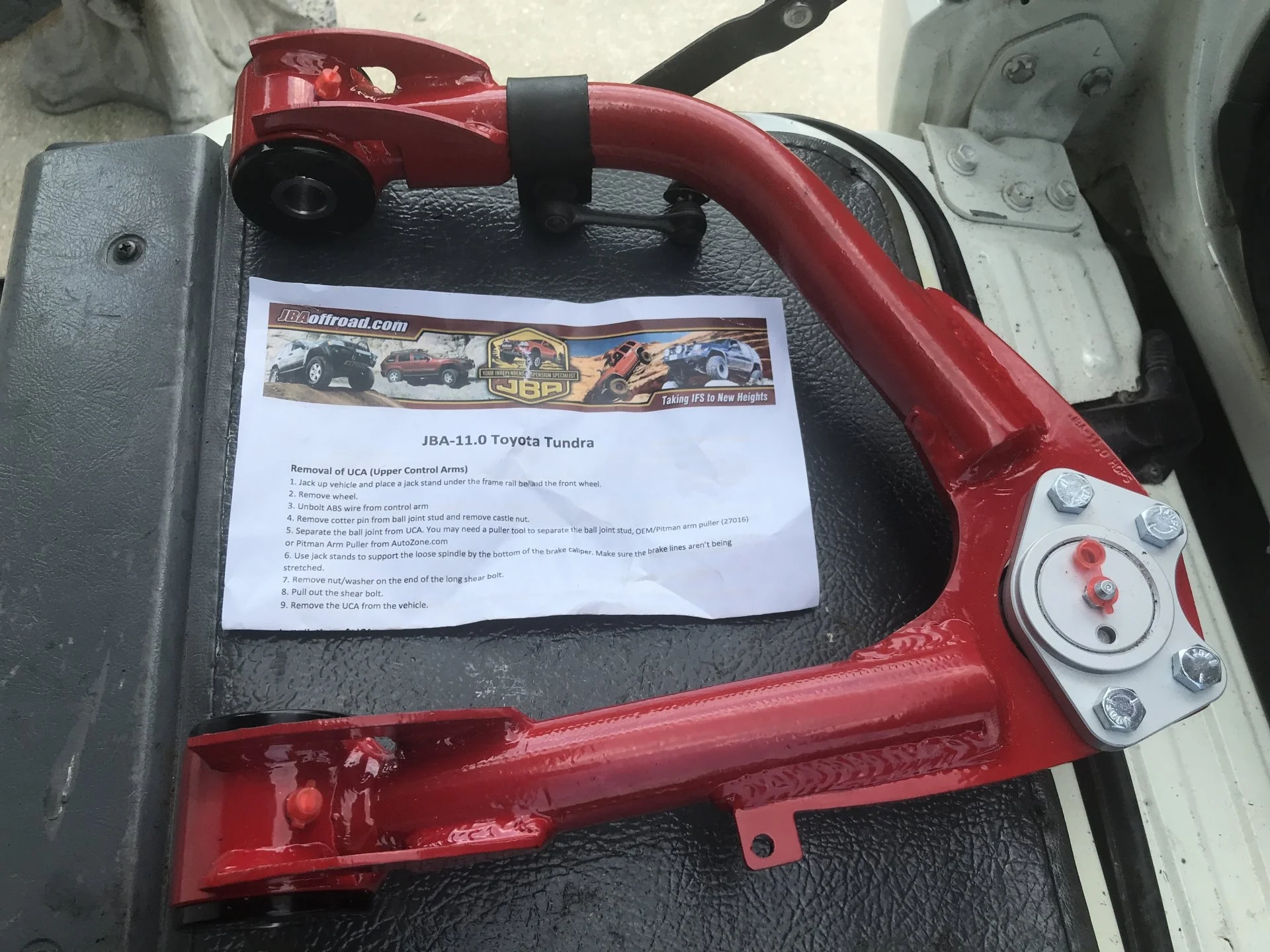

All is good, still trying to figure out the swaybar link. On LX it’s inwards and Tundra it’s outwards. It’s at severe ankle when mounted inwards. I mounted it outwards outside of arm with a grade 10 bolt. It’s still at an angle but just ordered a different type link to straighten it up.
Lol, LX570 Pro. :)
I also think your sway bar links are attached to the sway bar on the wrong side.
What’s going on at the 6:00 position of your LCA eccentric? Optical illusion? Damaged bushing?
It's an 1/8" thick washer, I have one on each side of the mount. The Tundra arm shock mount is about 1/4 narrow than the 200 series. I forgot about that, I probably should get the proper bolt.

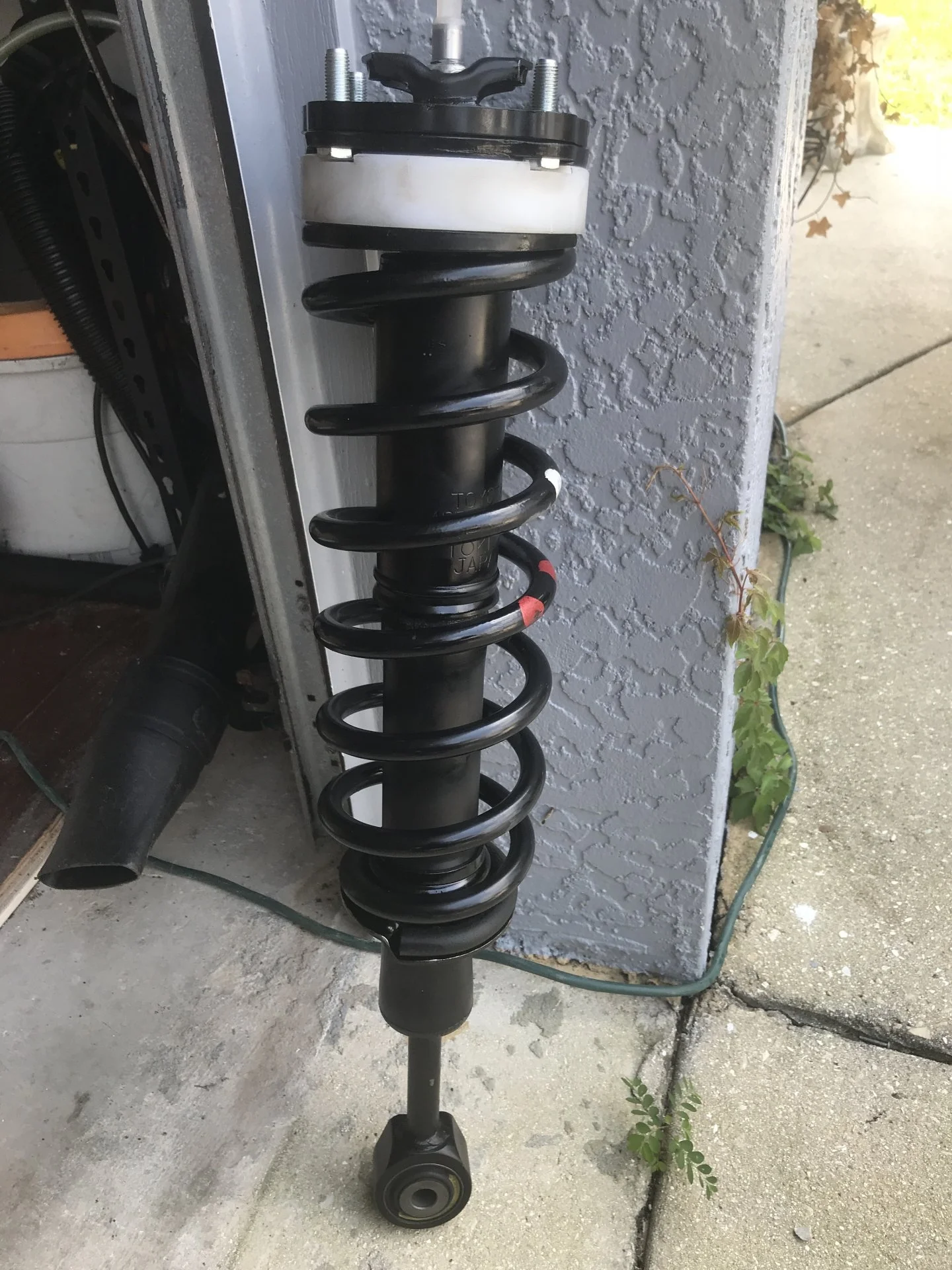

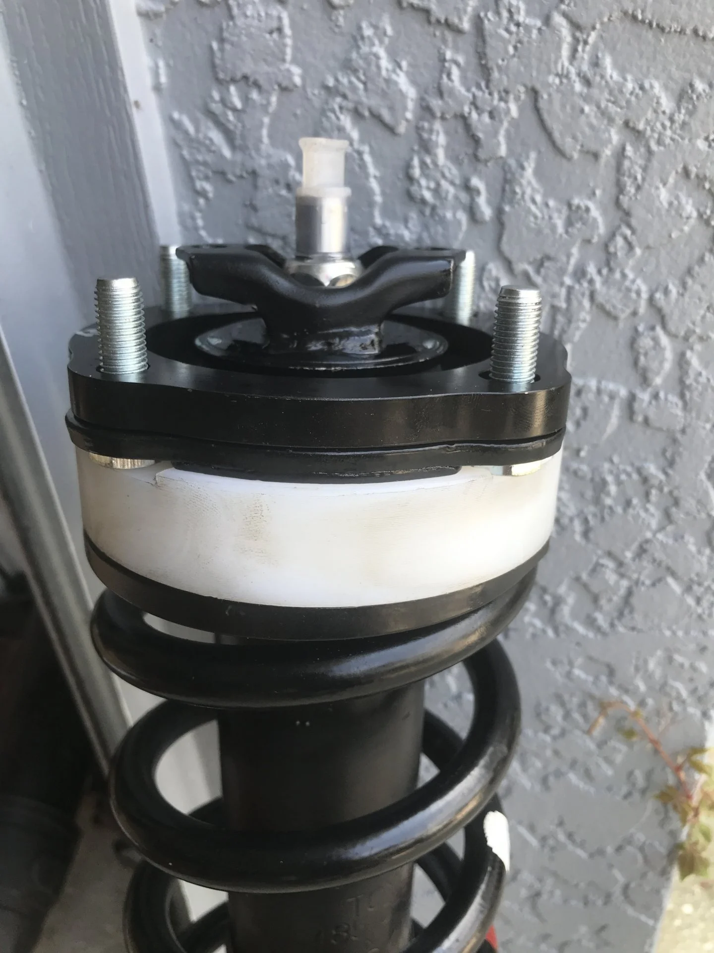

Interesting video on upgrading AHC 200 series coils with uprated Terrain Tamer 100 series coils
Thanks for posting. This may be a dumb question, but I wonder about the front? Why just the rear? And maybe its just me, but it appears to make the rake even worse in High. Hard to tell from this angle though.
