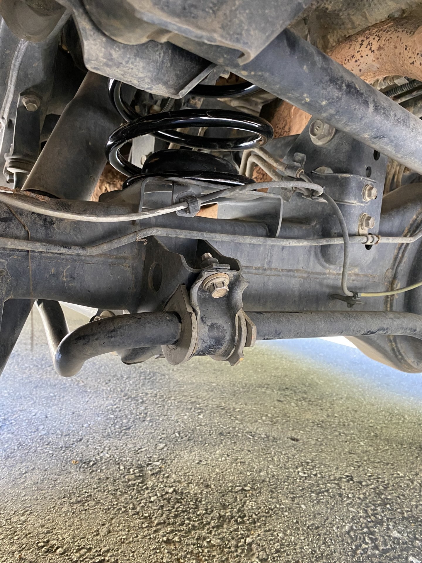

Heavier springs rate that works with AHC
Thanks for posting. This may be a dumb question, but I wonder about the front? Why just the rear? And maybe its just me, but it appears to make the rake even worse in High. Hard to tell from this angle though.
I think that is the 'factory' rake. Similar to how mine looks, though I have some AHC height adjust on mine for the 35s.
I would love to see a vendor uprate the front springs the same way.

Using mild springs from a 100 series or maybe even stock rated LC100 springs would make sense. Not as heavily rated as stock 200 springs but more than what you get
Well damn. Somebody finally tried it. I often wondered if the 100 series ahc uprated coils would work. The king springs variants are the ones 100 series ahc guys most often use to fit when lifting them while retaining the ahc system. Didn't know Terrain Tamer made ahc coils.

‘Verified:
“verified” as in installed and running those TTCS-2168? How does it respond going into low and what are your first impressions for the ride quality?
EDIT: you answered a bit of this over on your build thread, but I’m still curious how it responds trying to lower it.
Installed and running. Rides great. Raises from N to H much faster - low is probably a non-starter. It seemed to adjust fine around 65mph where it usually does, but sitting in the driveway, it seemed to freak out a little when I tried low. I am waiting on Techstream to take a look at everything.

Good question and it is worth mentioning that I have not used low in a very long time. I did not try it before the sensor adjustment, but I did cycle through all modes after the sensor adjustment and it seemed to work fine.
I knew beforehand that here was a chance that this may cause issues with going into low, which is fine as I never use it. Having said that, I will hold out until I can get it hooked up to Techstream and see what the what is with my pressures.
I should also add that when I did the sensor adjust, I moved the fronts all the way as far as they could go, yet it only resulted in about 1/4 inch lift. That is until the springs were installed. Then everything sort of evened out for whatever reason. It was likely that I just needed to cycle through a few times, or maybe having it on a lift, or possibly the perfectly flat alignment rack helped. I'm just not sure at this point, but everything seems to be fine now.
