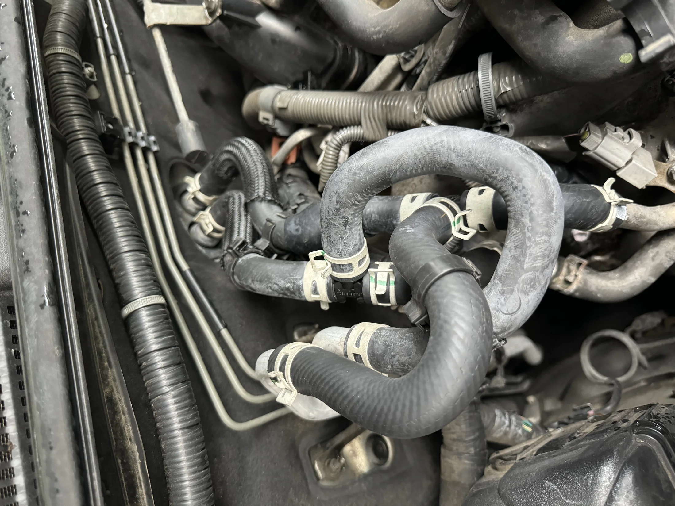

Hey everyone. Just had the Heater Hose T's replaced out my by LX570. Texas car, no abuse, etc. Dealer was well aware of the 100 series issues (as most of us are), and advised that the 200 does not seem to have similar issues. They recommended against replacing the T's.
They replaced hoses and T's. When they removed the old T's, they fell apart. 2008 w/ 210k miles. Looked new from outside. Thought it was worth posting photos for reference.

Thanks for posting. I used to advocate against messing with them as mine and others were factory-perfect at ~125k, but between yours and a couple other people posting, one with an outright failure, I think these should be added to the higher-mileage PMs list.

I agree. Seems much less of an issue at lower mileage as opposed to the 100's....but I think I would be replacing them on any older or 150k+ just for piece of mind. Complete failure, I'm sure, is still highly unlikely. The dealer seemed surprised at their condition, and did say they will likely begin recommending replacement after seeing them. My guess is that 99% of LX owners would never think of it unless told, or leaking.

Old thread, but my 2008 started losing coolant. Started slow, but I noticed steam today. Heater tee broke. Got lucky, just drove a couple hundred miles on a trip.
Had an SAIS CEL that had me under the hood—spotted the leaks just in time. The tees completely disintegrated upon removal. I replaced them with the hose assemblies and OEM clamps - 30 mins taking my time. 2008 Land Cruiser with 250K miles.
