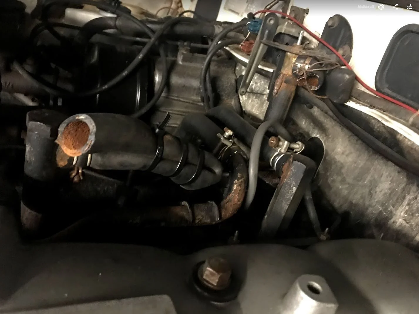

Hi all,
picked up a 60 series recently and only just noticed (what i think is) the heater hose has been cut and clamped shut. Why would someone cut it? The only thing I can think of is a faulty thermostat or similar so the heater is always on...?
Would this cause any issues with cooling, engine rarely goes above quarter on the temp gauge..
Appreciate any advice or theories on why this would have been done and the implications.
Many thanks!!!
Michael
The heater core is not easy to find new. The easiest option might be to have yours rebuilt by a radiator shop. Around here that runs about $350-$400.
The other option is to do a nicer job of plugging the system.
Also, if your coolant is the color of the inside of that heater hose, you should flush that out.
Hey FJACS mate, thanks for the info, yip she has a bit of work to be done and flushing the coolant was on the cards as yes, thats whats in the system... :/ If I can just neeten it up with no adverse affect / no heater that sounds like the go for now. Thanks so much mate!

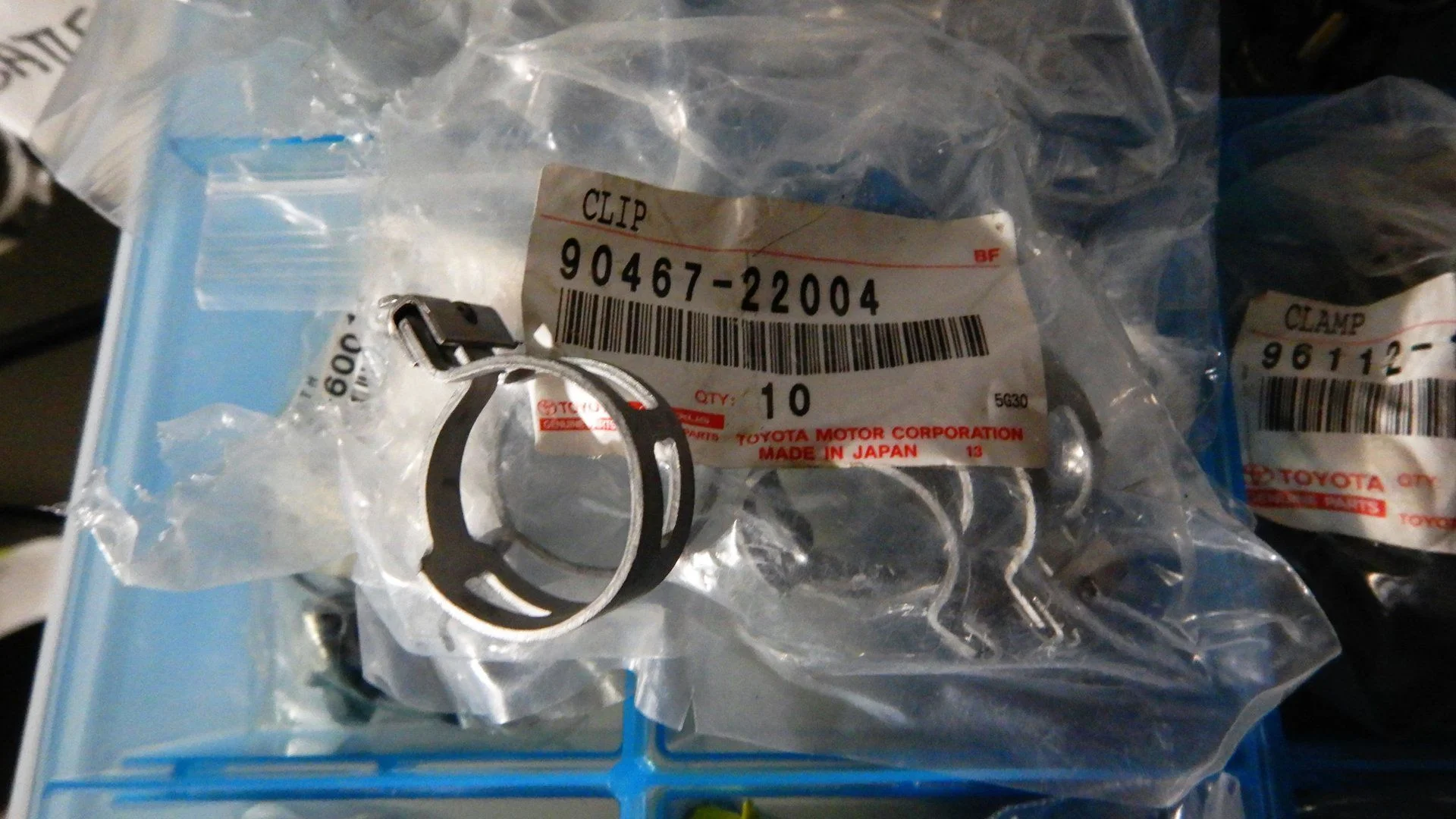

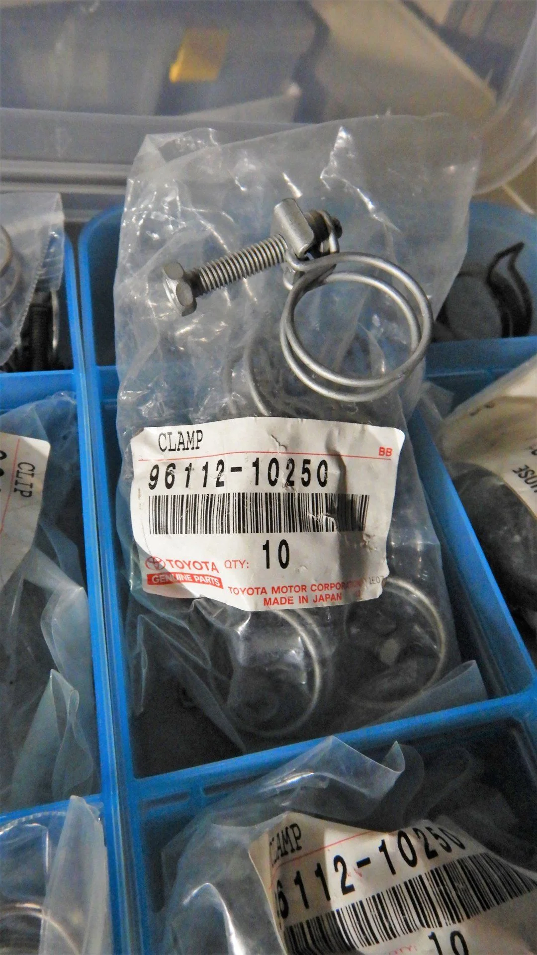

Here are the 2 hose clamps types & part#'s u will need to make your repairs

That being said, I do like the Toyota hose clamps.

The Clamps are Good !
