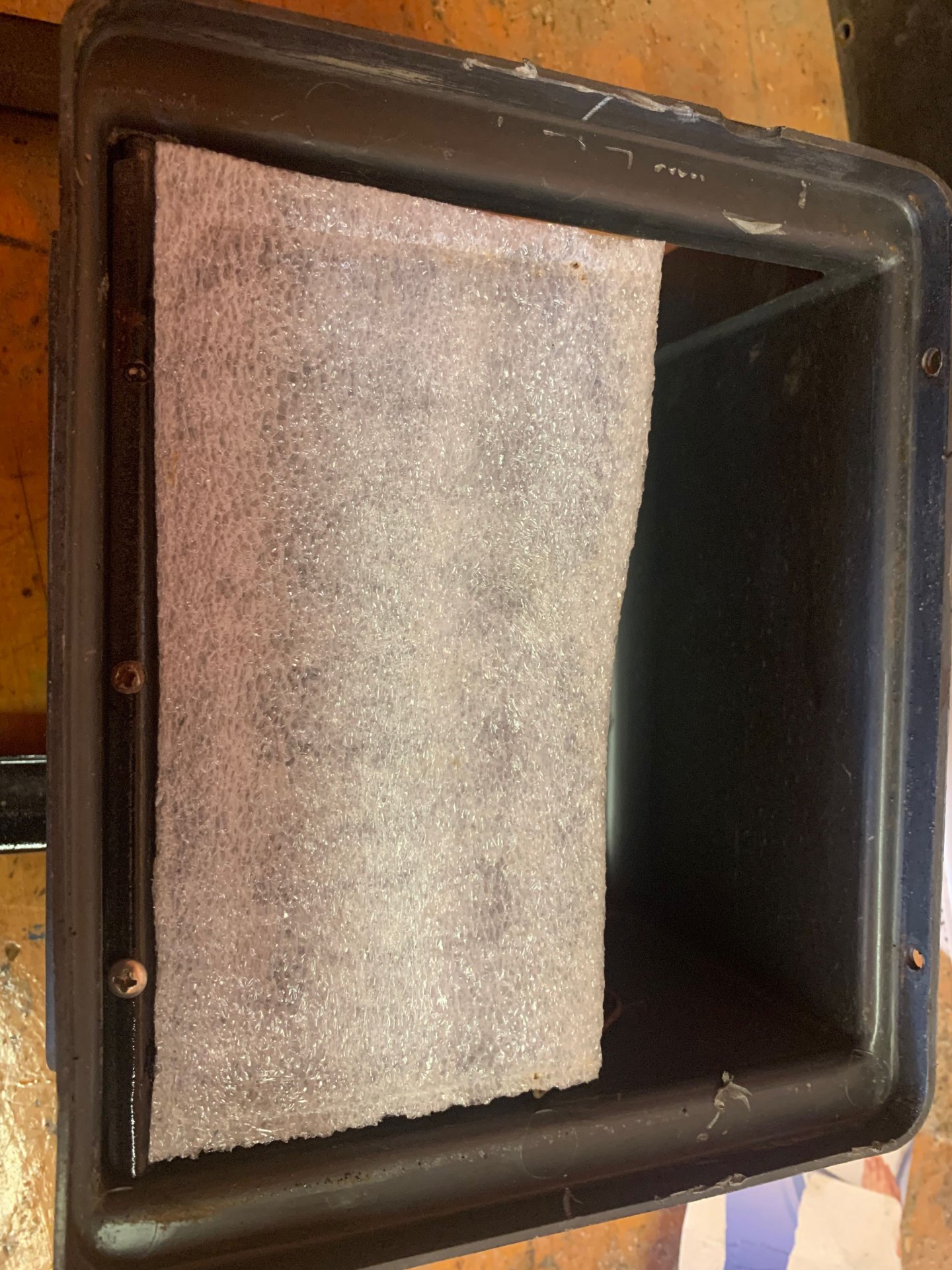

Ok, a few pictures about what the heater looks like, and a few questions:
Lever actuator. I have not taken anything (bushings, washers, etc) off, this is how it was installed in the Cruiser:
The following picture is the 'foam' for the flaps:
On the picture above, you will notice there are only 2 screws. The 3rd screw looks like it is broken off inside the pivot rod.
The final picture is a detail of the lowest flap, at the bottom of the heater:
My questions are- is it important to take the flapper plates off, is the missing/broken screw something to be concerned with, and are there any "missing" parts in a restore kit? I have been looking for a exploded parts picture so I know what nylon bushings, guides and locking clips I need and where they need to be. I have new foam and I'm cleaning the heater core out, but honestly it doesn't look bad. I guess one final question is do you need to put something on the radiator fins to stop/prevent rust?
You are in there so you may as well remove and replace that broken screw. I know Eastwood and some other manufacturers produce paint for radiators that doesn’t gunk up the fins or reduce heat transfer. May as well spend the $20 for a can of that and shipping to do it right and be done with it.
