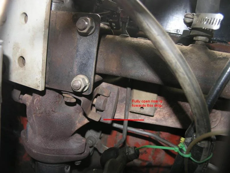

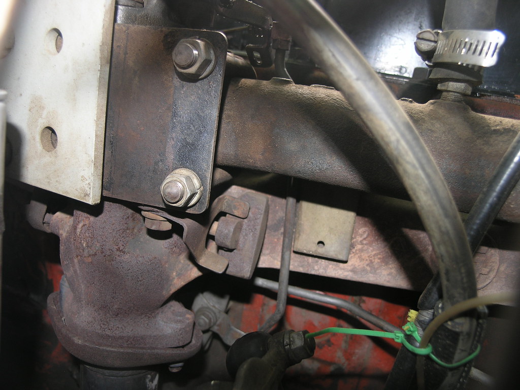

counter weight and counter weight stop:
spring:

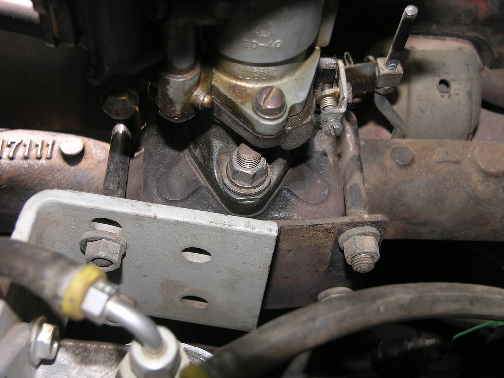

hacky mount from previous owner? ( i have the original oil tower in my basement )

You've got some great pictures! Regarding the riser plate's current position, if it isn't corroded away, I think you could gage it from the clearance to the 'stop' marked on your picture. I don't know if fully open is against the stop, or near it.

Currently the counter weight is not touching the lower / bottom stop, but rather it is completely touching the upper part of the stop.
Assuming, as you mentioned that the riser plate is not corroded, I believe that this would mean the riser plate is stuck open?

Your heat riser appears to be closed, not open. That said, it is when it is closed that it is directing heat to the bottom of the intake, and that's not what you want, as you are aware.
You can try Kroil, PB Blaster or something like that to try to loosen it, but I've tried on several exhaust manifolds and never gotten a seized one to open. :frown:
Unless you drive it in freezing weather, the heat riser is not critical, and having it open is far more important than having it closed. So, one option is to cut it out.
