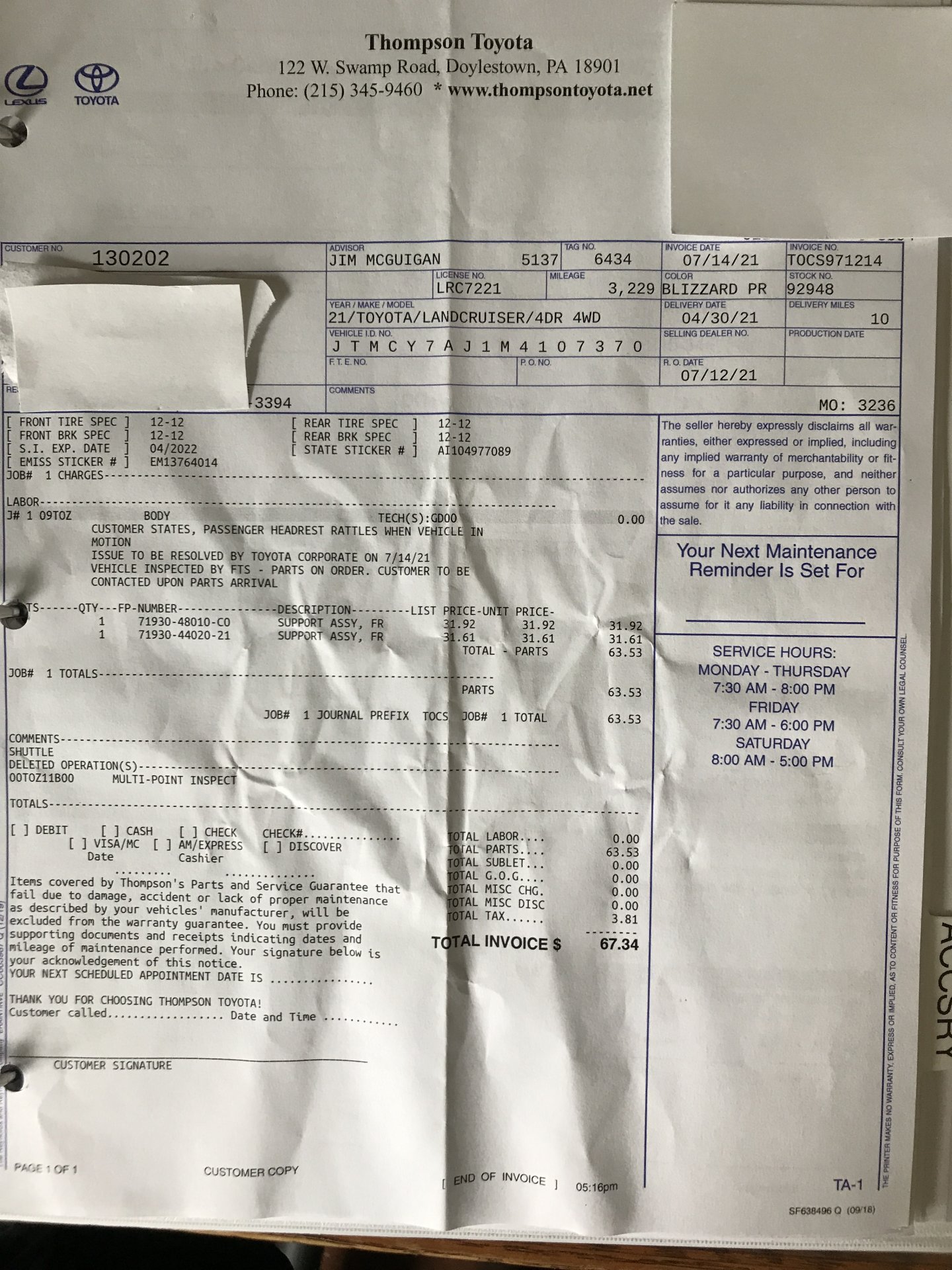

Headrest rattle is finally fixed! Toyota replaced the headrest and mount tubes. Pic shows parts ordered. All under warranty.
Thank you for posting this information. I just bought my ‘21 a couple months back and the rattling has been driving me nuts. I also lower the passenger headrest to dampen it. I ordered the parts however it looks like you might need to remove the seat leather to get to the posts. I’m leery to do that as the LC is still so new for me and don’t want to mess something up and regret it. Do you think this would still be covered under warranty? It’s past the 3 year mark obviously. I kept my 4th gen 4R and its doesn’t have any rattling or creaks.
I’m pretty sure it’s isolated to the headrest posts particularly in the front passenger seat. It only has 20k miles on it and I had a pre purchase inspection don. The tires on it are new as well.
I called the dealership yesterday and since it’s past the 3/36k warranty it would be out of pocket. I think I’ll just save the parts for now and try bending the metal inserts as others have mentioned.
