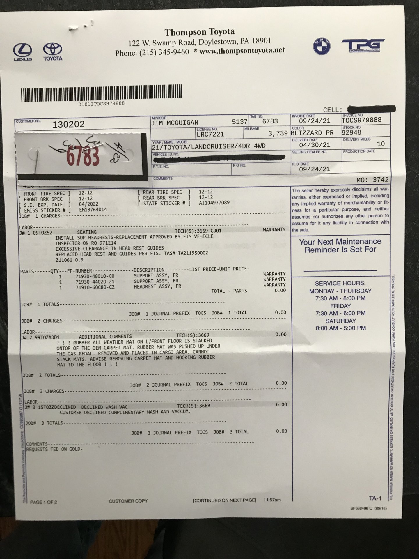

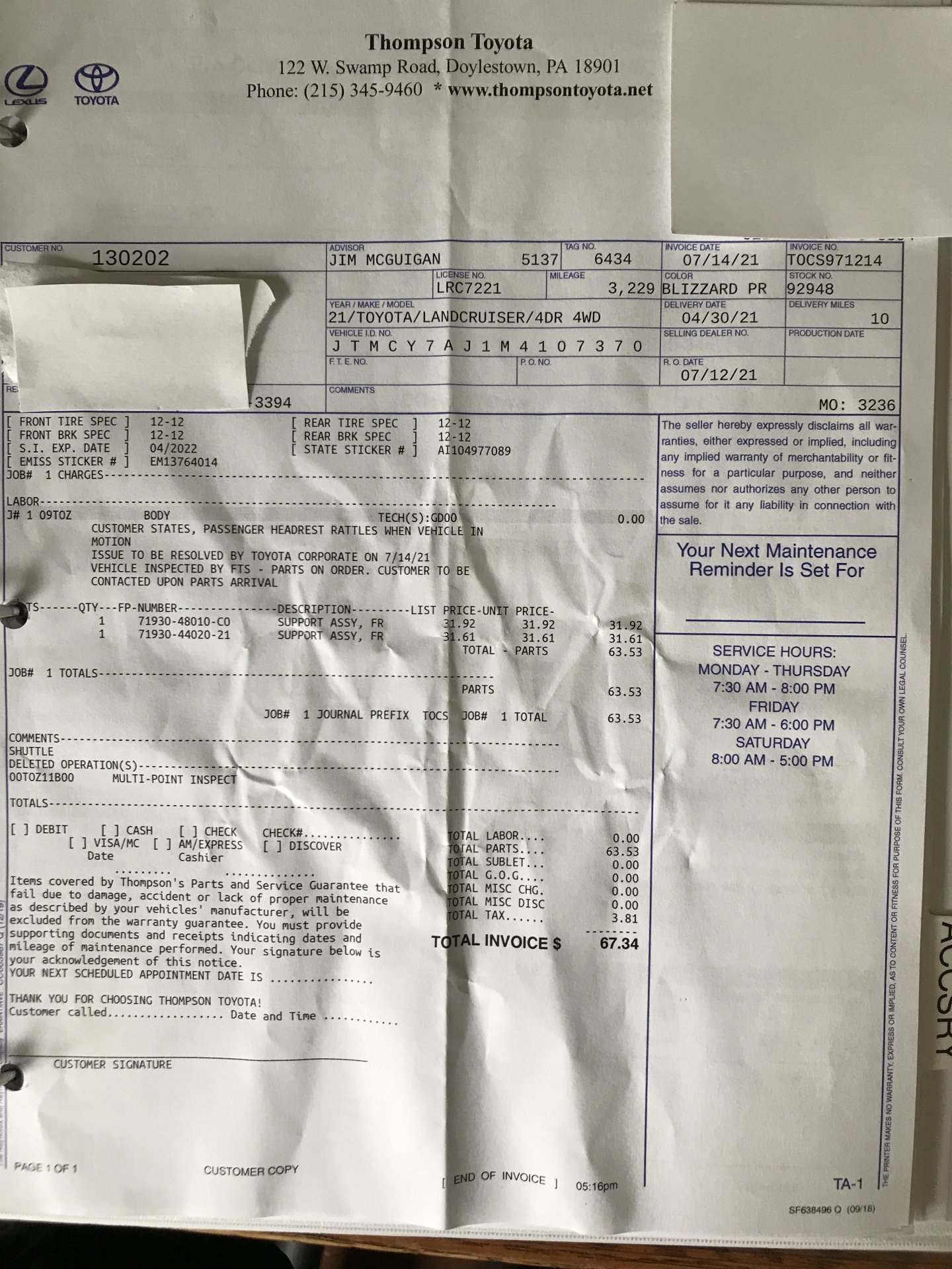

I just got an update from my local Toyota dealer. Parts guy had to make a couple calls but here’s the latest. They are still awaiting the parts. Apparently these parts have not been manufactured yet and Japan is still working on that. I’m told there are other dealerships awaiting the same thing. I did not get a time estimate but that I should just keep calling back every couple weeks for an update. I’ve also attached a picture of the parts that they ordered for me.
Great. I have parts number. Sorry you are stuck waiting. Let us all know when it comes in and if it’s a fix. Hopefully they assign a reference or case number so we can all quickly benefit from your homework. I doubt a recall would be likely but i would gladly fork over a few bucks for fix.
Headrest rattle is finally fixed! Toyota replaced the headrest and mount tubes. Pic shows parts ordered. All under warranty.
Thanks! I just called the dealer with your parts number. They ordered the guides but held off ordering 600$ headrest. I told them to call me when parts came in and I will either schedule them to do it, or see if guides alone will fix it.
Glad it worked for you. I think Toyota may have to make a lot of headrest if this is the fix.
Glad this fixed the problem!
I need to ping my Lexus dealer service rep again, I sent him this thread to order the parts.

Thanks for the update. Interesting. I guess I will be pursuing this. I also wonder if your fix lasts. Please report back after few hundred/thousand miles, thanks!
The Lexus dealer ordered the parts, got them within a few days, and the rattle is gone, yay!
Thank you @jackbflyin for the parts info, that helped the service rep order the parts.
Just adding to the data…..had headrest fix per parts listed above. Rattle gone! My LC is so quiet now…never knew what the rattle did to interior noise! LOL

Any indication whether the parts are specific to the updated leather 16+ interior or are they internal to the head rest?
How did you engage the dealership to get the repair done? Did you provide them with a parts list? Did you have to go in first and have them inspect before repair? Glad to hear issue is resolved!

They replaced the black “runner” inside the actual seat…where the metal poles of headrest stick into. So i assume that this applies to all years???
