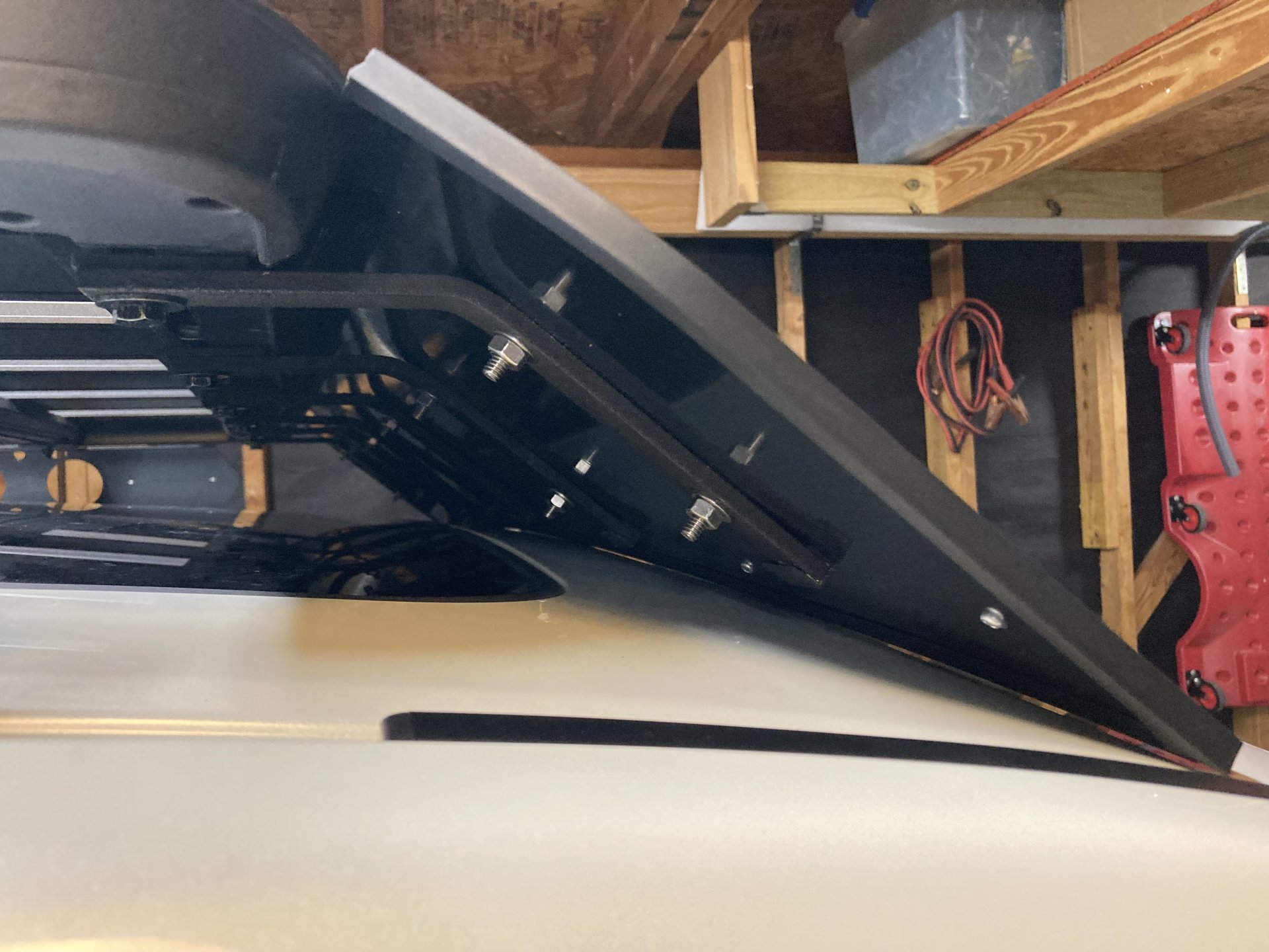

Update:
Installed a self made wind fairing cut out of 1/4” black ABS and supported by 6 self made aluminum strips/clips attached to the front rail (under side) with rhino rack washer/bolts.
Seems due to the full width and full coverage bottom to top of the pioneer platform, wind noise and noise through the sunroof is about 80 to 90% down. Very happy with the result and looks. Even moved and riveted the rhino logo at the front to the fairing to enhance the looks…

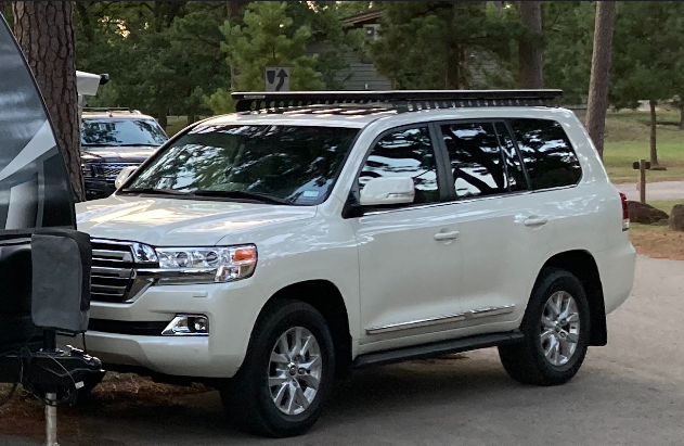

Worth mentioning that my fairing bottom edge is 6 inches or so away from the sunroof whereas the rhino fairing fitted to a LC200 (see picture in this thread above) would pretty much sit on the glass. One of the drivers to go the self build route.
Those black clips are bended from aluminum strips and painted, as well as the spacers.
Also bought a rubber strip to go on the edge of the fairing to protect the roof paint.
For the rest some stainless nuts/washer/bolts, a vice to bend the aluminum (after heating it with a torch for 30sec) and some patience to measure it all out. In the end I managed to make the strips and items all dimensional close to identical and the fit/alignment is good (or good enough I would say).
