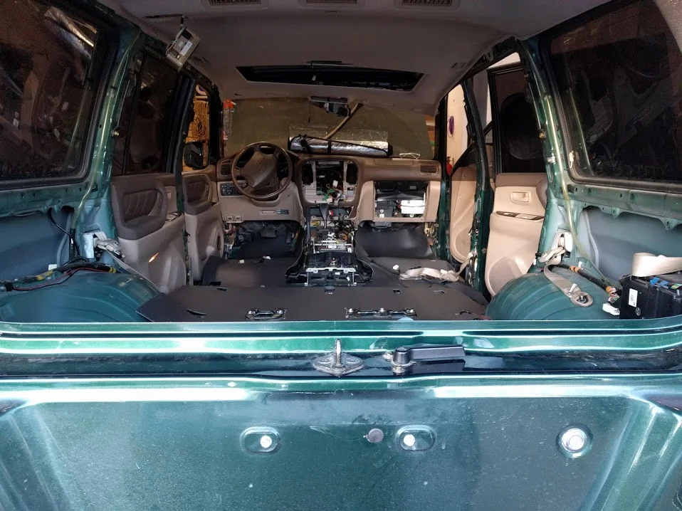

The side pillar and lower interior stuff needs to come out first to drop the headliner. I gathered that info from some pics that @suprarx7nut posted below. You can see some tabs over the doors and other areas holding the headliner in place

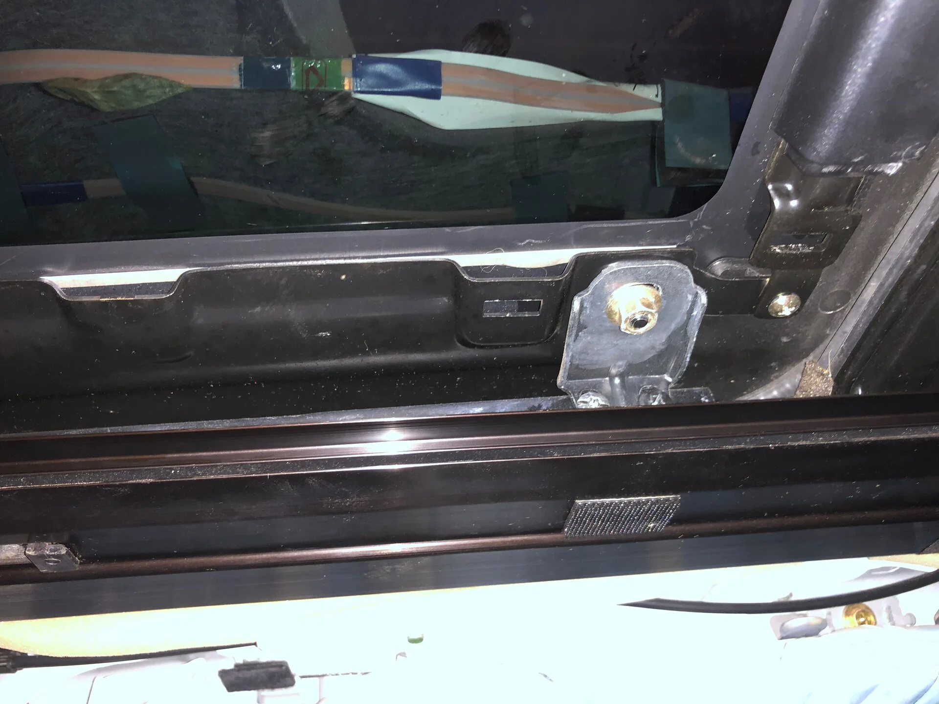

There are a few pieces of velcro, really strong velcro, holding the liner up around the sunroof area. If you pry down gently and try to look in there as best you can you can see where they are. I think I may have put something long in there to pry it down at the velcro strips but it's been awhile so my memory is fuzzy.
In any case it's the velcro that is your problem.
Here's a photo from when I fixed my sunroof showing one of velcro pieces. I think there's maybe 2-3 on each side? I don't remember it being difficult to detach. I think I just pulled it down with two hands so it wouldn't crease.

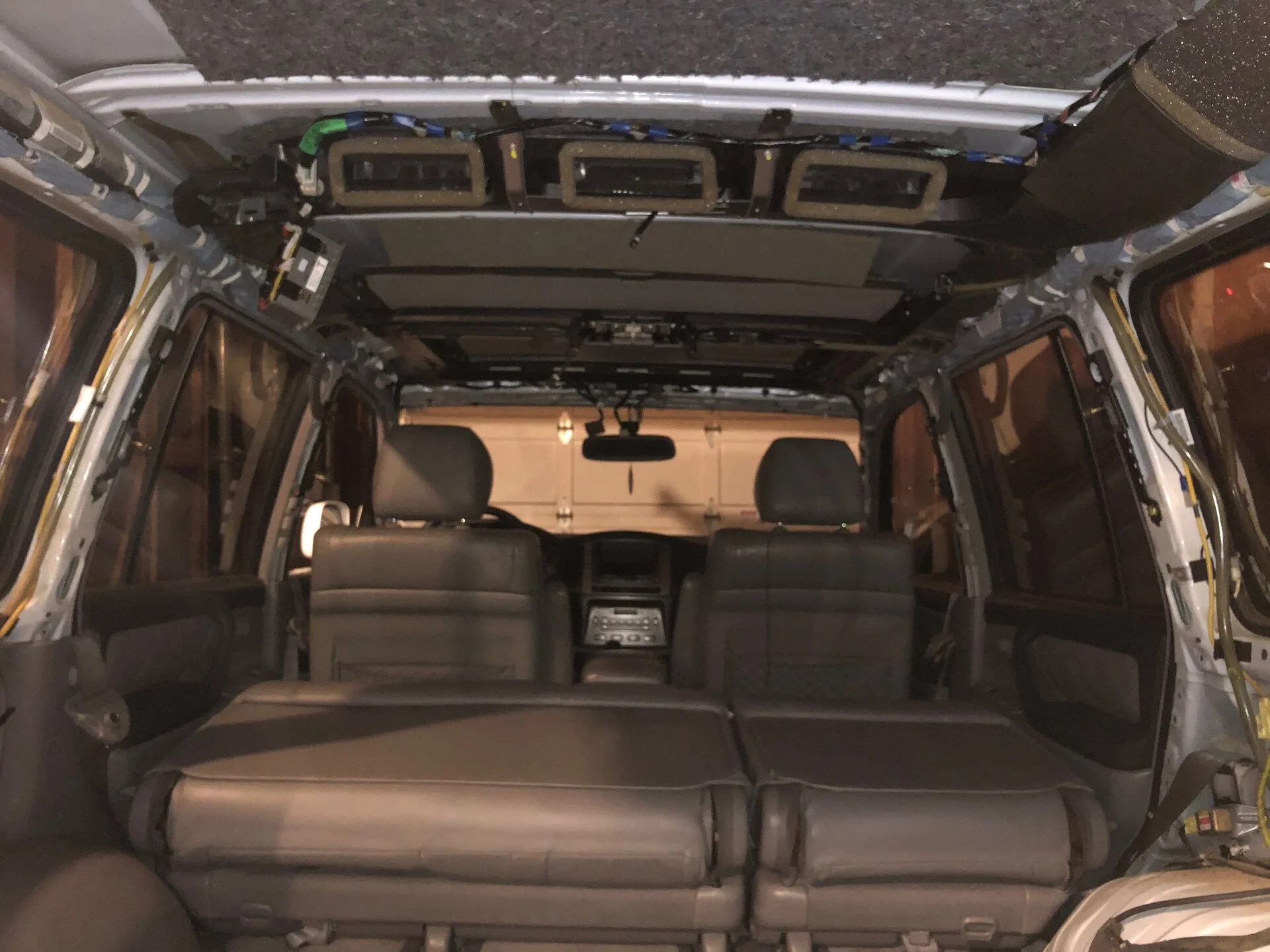

Don't have any rear entertainment. It sounds like it's right behind the sunroof, like there's a large area just over the rear seats that has something rattling up on the headliner. What are those large brown panels in the picture?
The large brown panels are the acoustic foam from the factory. The rattle you might be hearing could be the roof skin delaminated from the roof structure.

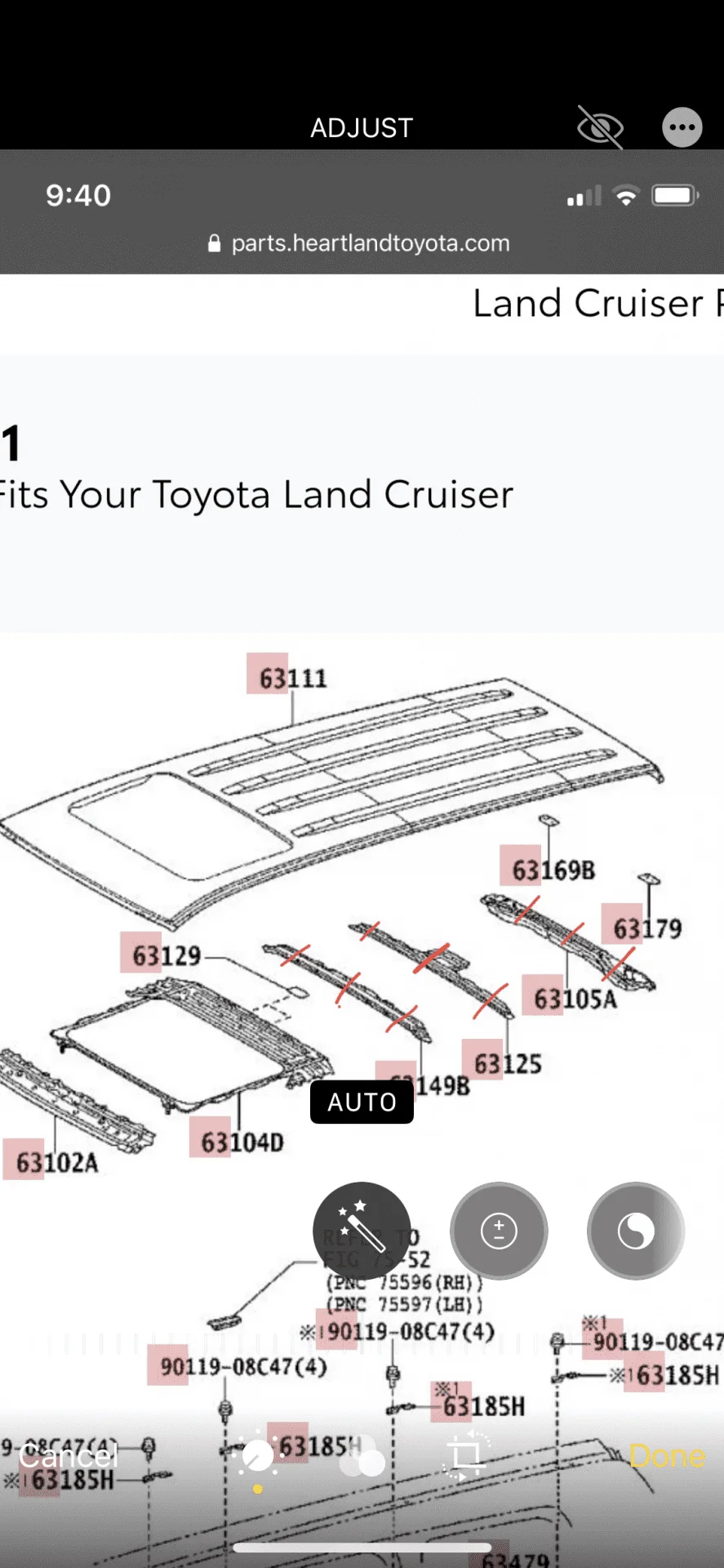

Follow up posted here. In short, dropped the headliner, solved the problem. Def a long project though, did it over two half days.
It was the roof support rattling against the roof. The adhesive between the two was hard, cracked, and no longer adhering the two together.
