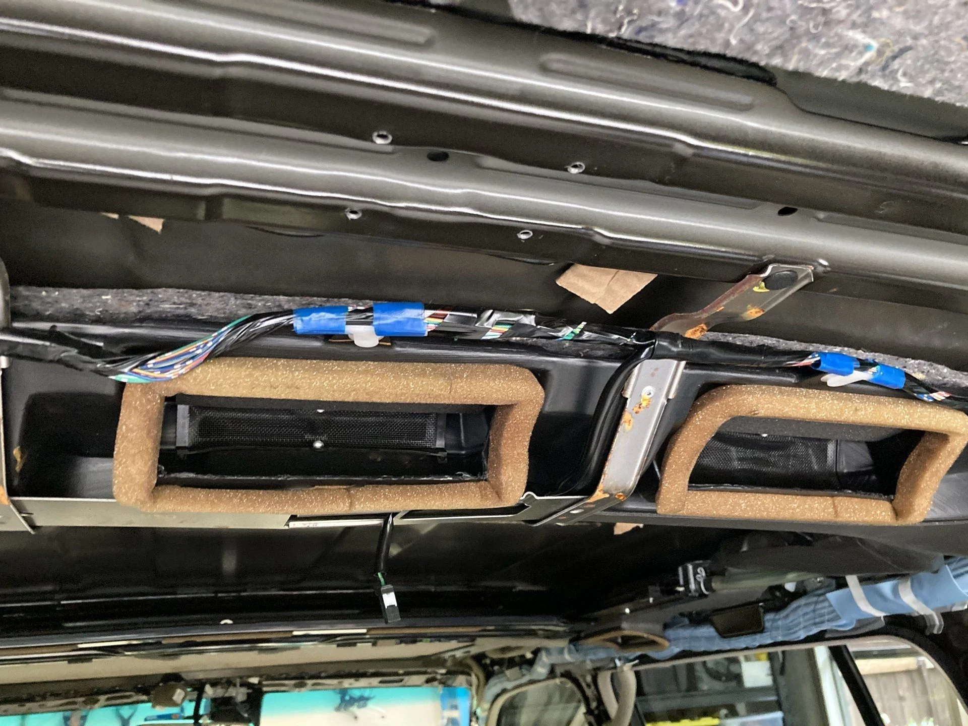

I inserted some temporary cardboard pieces and drove around today, with sound diminished (and no headliner). Thoughts?
I see the 2 pieces of cardboard stuffed there. Is that where and the only place it rattles? i have had this sound now for the last 1-2 years. getting very annoying

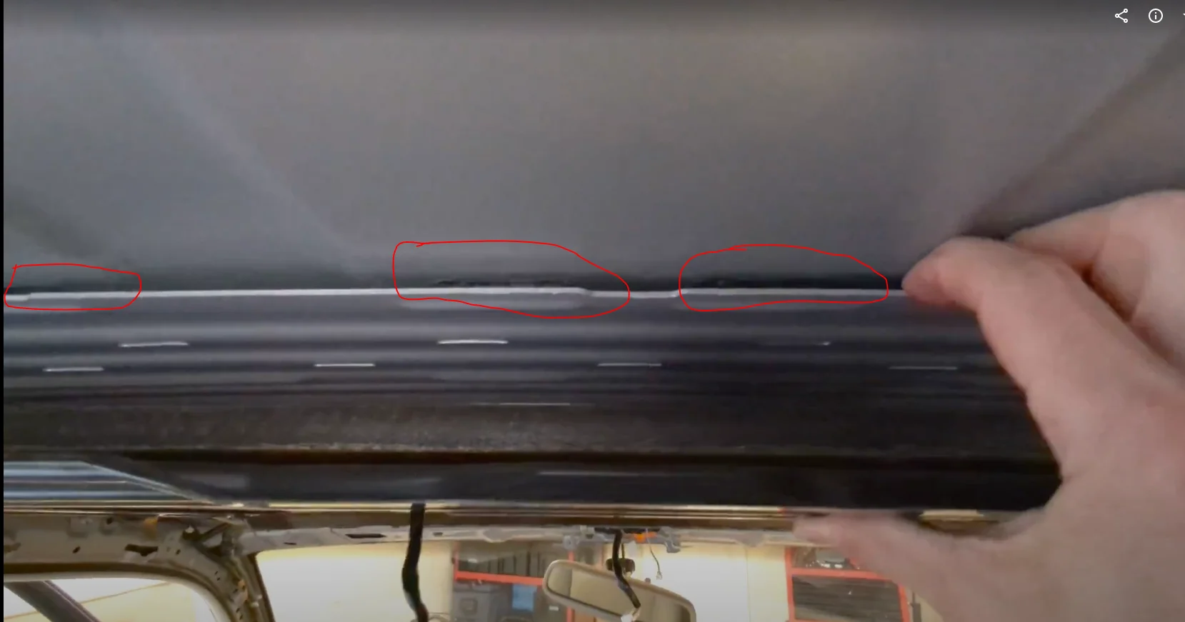

I just tackled it this weekend for the same exact problem. The adhesive between the roof support and the roof essentially gets hard, cracks, and then you get some metal to metal type resonating/vibrating/rattling. (see red below.) It was driving me nuts for almost 2 years. I had some extra headlight sealer tape lying around from doing my HID upgrade, seemed like the perfect replacement for the factory adhesive. I stuffed quite a bit of that butyl rope in there and it did the trick. The headlights see some pretty wild temp fluctuations so this stuff should be fine. No idea if this is the best fix, but it's what I had and I'm pretty sure it will work for a very long time.
Amazon product ASIN B01N5PM29J
I also covered that naked roof panel with some stereo sound deadening materials I had laying around also for good measure. It's a large patch of un- insulated resonating sheet metal, so it can't hurt.
10/10, would do again. The rattle was so bad I almost wanted to sell the damn thing.
Tips: Use plastic panel tools to pop and pry the panels off, use a headlamp or flashlight to find the fastners before you pull and later push, don't force anything. take your time. I did this over 2 half days. Half a day to drop it, half a day to put everything back. I wish I had thought to add felt tape to all the joints for extra rattle resistance but I didn't think about it until I was done but I did spray them with dry silicone lube to eliminate squeaks hopefully.
