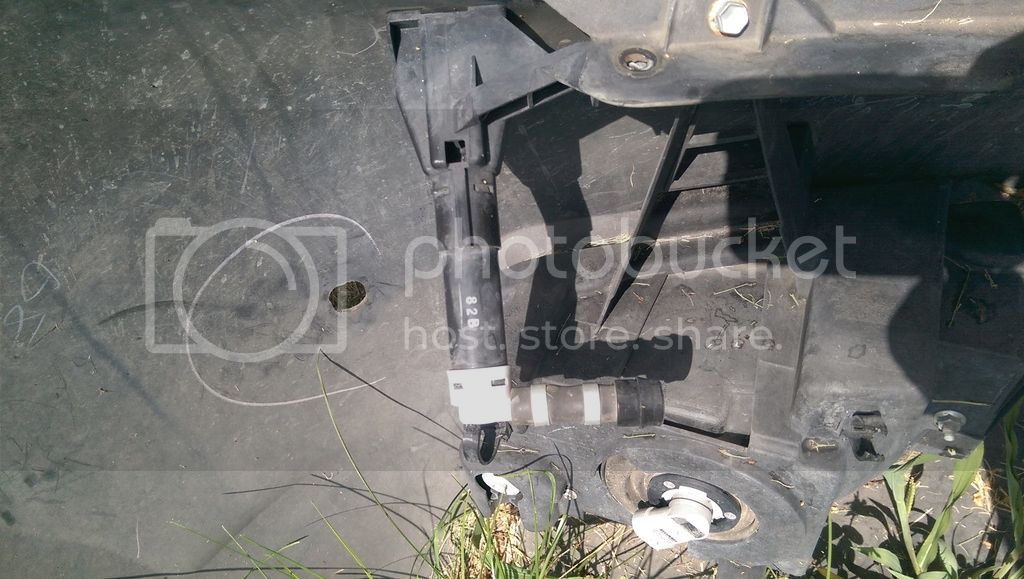

If you need any pics of the back of the mechanism behind the bumper let me know, mine is intact in the garage.
@Archtaan That would be awesome. Please snap a shot for me.

Here you go bud. It looks to me like you need to replace the whole insert(pop out part). It connects at the bottom of the washer system where you see the white 90* elbow.
Thank you so much for the photos. It definitely explains it.
