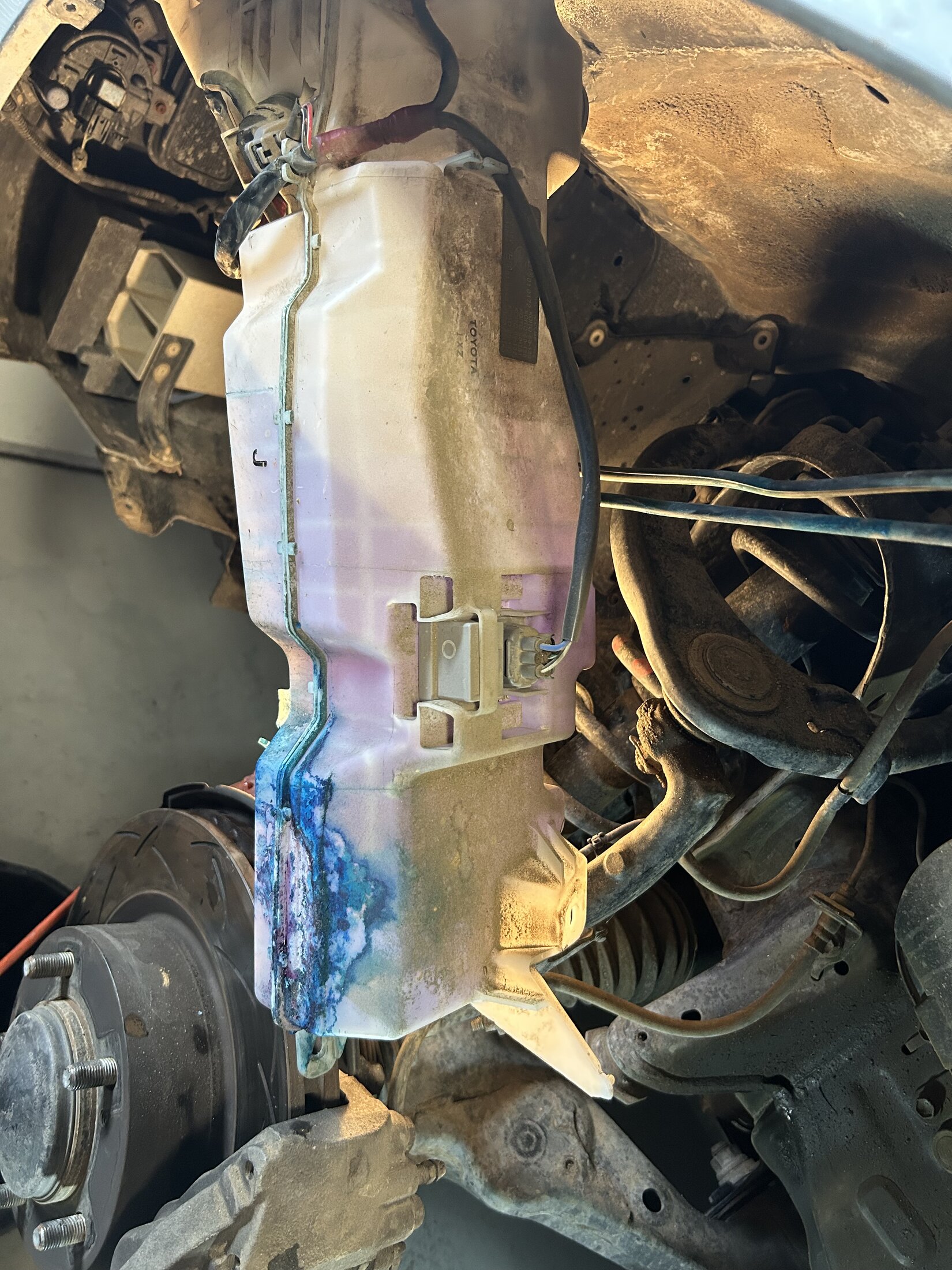

2010 lx570 . When I'm parked nose down on an incline getting washer fluid leaking onto the ground. Thinking maybe a seal between. the neck and the bottle? Any other occurrences here?
2011 lx, I had a small leak from washer res. Turned out to be from the seam of the container itself, along the top. It only leaked when topped off, so I just ran some superglue along the suspect area. I doubt it completely fixed it, but not worth buying a new tank for.
Mine was leaking from the base of the headlight washers.
there is a product called Water Weld available at your local auto parts store, which works for exactly this type of thing (and pressurized radiators and overflow tanks). It works well BTW..
Yeah, if you've ever had your bumper off, you can see there are a lot of connections it could be leaking from, along with the tank of course.

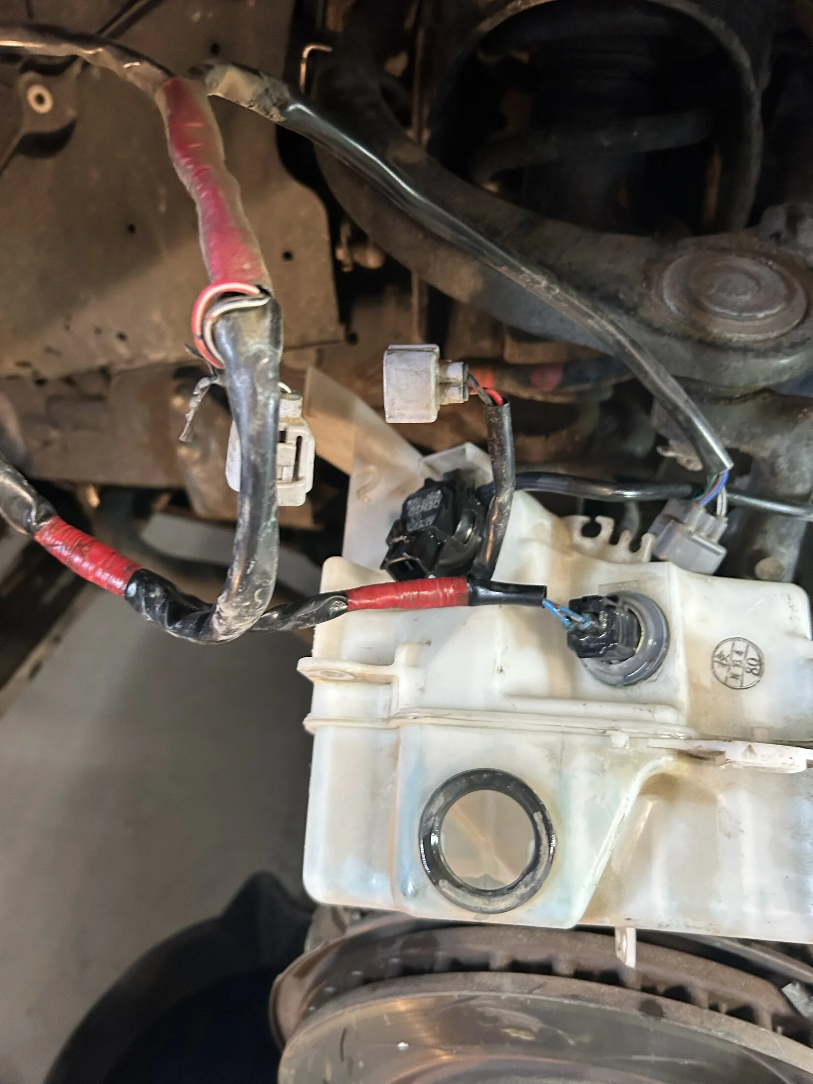

What fixed that?
Pictures here:
