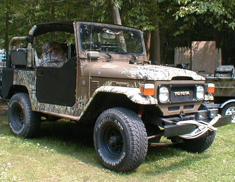

FYI. I fit a square 1/1979 manufacture Bezel on a Grill from a 73 with no modifications. That 1/79 was a wierd transition model. I would say get some measurements if you are planning on buying or trading.
79 with 73 bib
This was from 9 years ago. Has since gone to the Rust Demons although many part live on. Had a 73 bib and hood.
change the bib to a 79 plus and the square bezel fits. bib fits without modification
Find the bezel for your 78, I made the mistake and bought a 76 Bib and thought I could fit the newer 80 bezel on it. It didn't work. So now my 80 looks like a pre 79.
