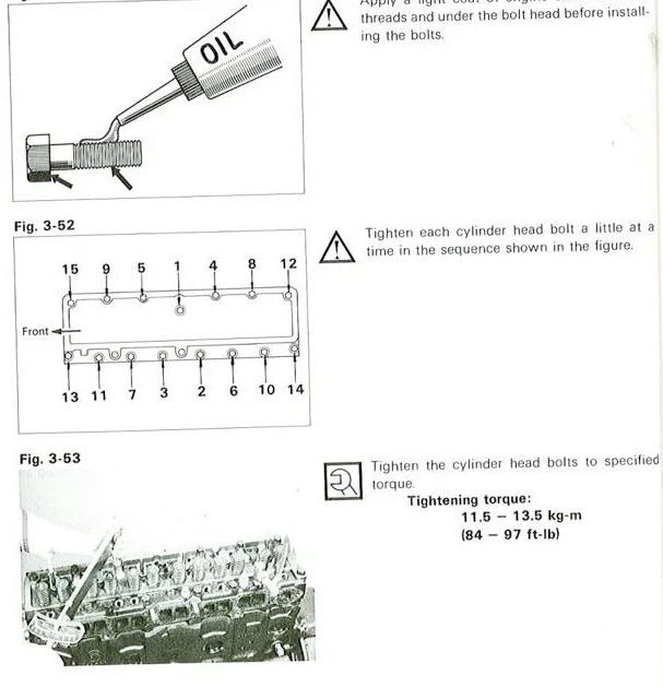

I’m about to start pulling the head on my 82 FJ60. I’m installing new head bolts when the head is rebuilt. Should I use never seize on the threads of the new bolts ? My biggest concern is snapping the head off . Has anyone ever had that happen ? Should I use an impact on them ?
Don't use antiseize on the bolts. Toyota recommendation is to coat the threads in oil when you install. There is a specific tightening pattern, it's shown in the FSM. Tighten the bolts in several passes, 30 ft-lbs, 60 ft-lbs, 90 ft-lbs. The last torque may not exactly be 90, check the FSM for that.

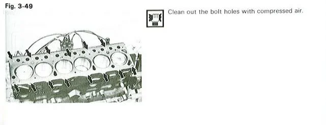

Clean out the bolt holes in the block before installation, run a tap through if you have it.
My engine builder who has rebuilt a hundred 2Fs (used to be Man-a-Fre's builder and K&H LC) used Never-seize regular. I watched him do it. He coated the entire bolt, with a dollop under the bolt head. He wiped excess off the bottom flat of the bolt, leaving a thin smear. Head was cut so he used washers under the Head Bolts and coated the washer with anti-sieze. After torqueing sequence, he wiped away excess.
As stated above, important to clean out the block holes with a flat-bottom tap. They're a little hard to find. If you have new head bolts you can cut a couple grooves into an old bolt and use that.

Interesting. I wonder if the Toyota recommendation of oil preceded the development of anti-seize and either serves the same purpose.
No idea on that - I had read Lub'ing Head Bolts was to get a more precise and consistent Torque reading over dry. Dry head bolts increase friction and REDUCE clamping force (a lot) at the same torque reading as lubed. Both oil and anti-sieze (light grease w/ powdered sacrificial metal) do the same thing.
