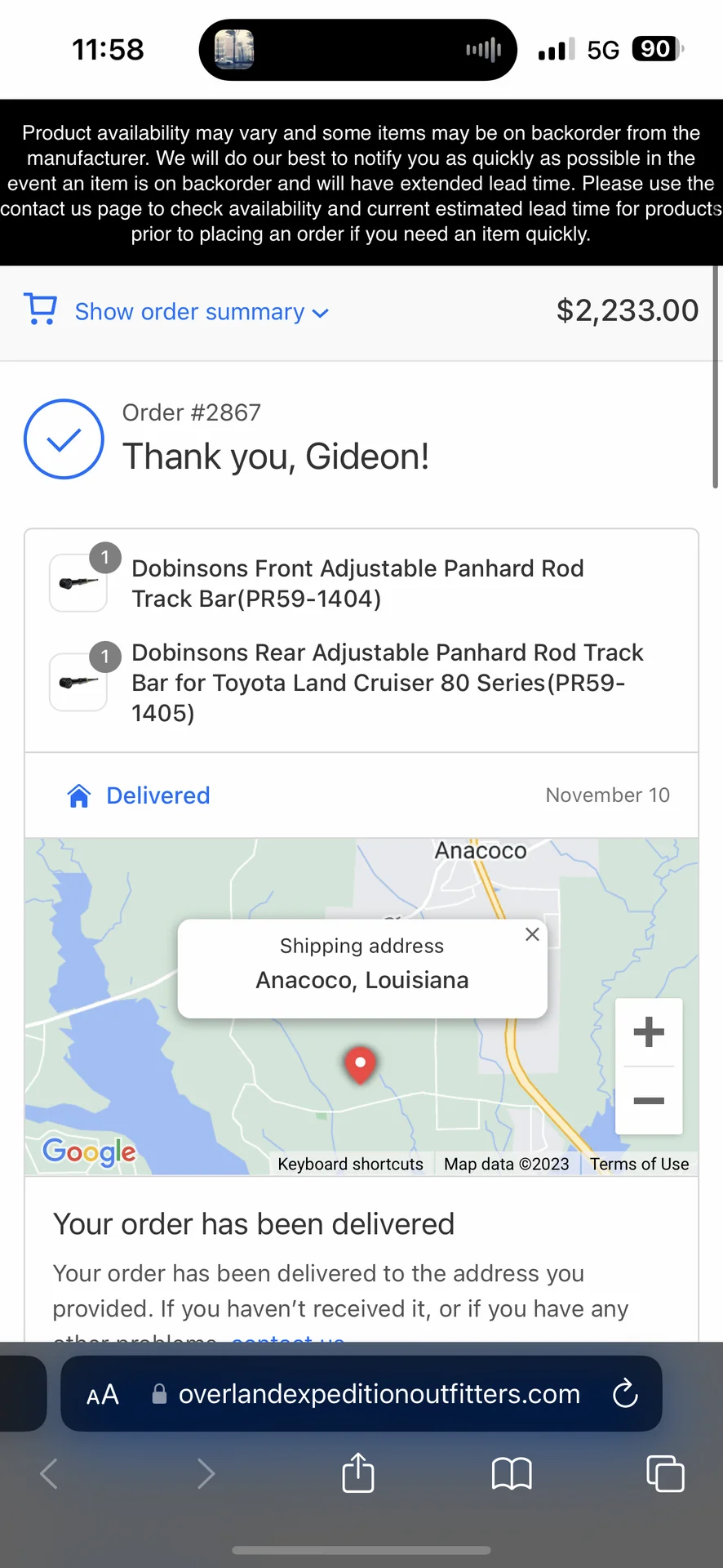

I have a dobinson kit for my HDJ81. I am wondering if I will need extended brake lines or anything else. If I do can someone send me a link? I also do need to replace my brakes and maybe my rotors. If someone could link stock HDJ81 front and rear brake pads + rotors that would be greatly appreciated. Also, does anybody actually recommend upgrading my brakes?

Honestly I have no clue what is on it right now and its running like s***. Which is why I bought a dobinson kit. I'll put it on as soon as I get the castor plates and the brake lines.
