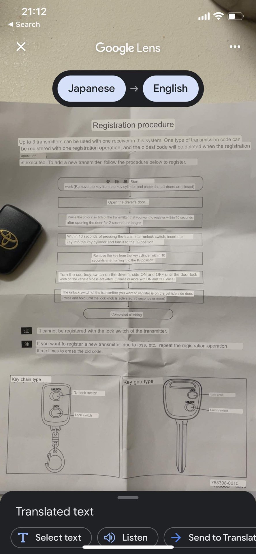

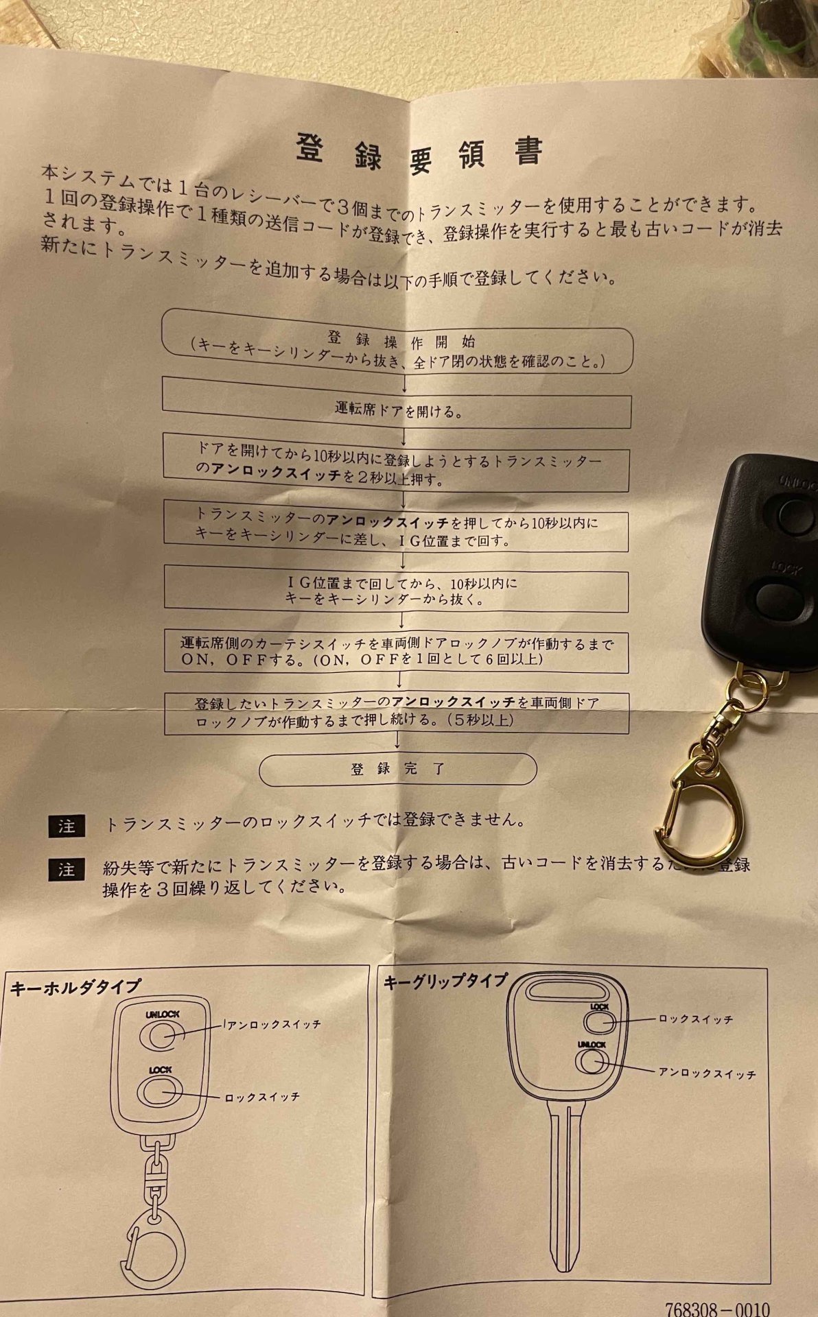

I was able to track down a spare key fob for my JDM Land Cruiser. The instructions I received with it are in Japanese and don't translate well. Anyone have one of these and know how to pair it?
Any idea what the "driver side courtesy switch" is?
I've figured it out! Seems like this factory remote system is uncommon and not at all the same as what was sold in the US. I could not find any information on this system on the internet.
The "courtesy switch" is the switch that lets the vehicle know the door is closed. You just have press that switch 6 times, which causes the locks to switch a few times, letting you know you're in the programming mode.
Hopefully this helps someone in the future who imports one of theses JDM 80's. The part number for the keyfob is 08192-00200.
