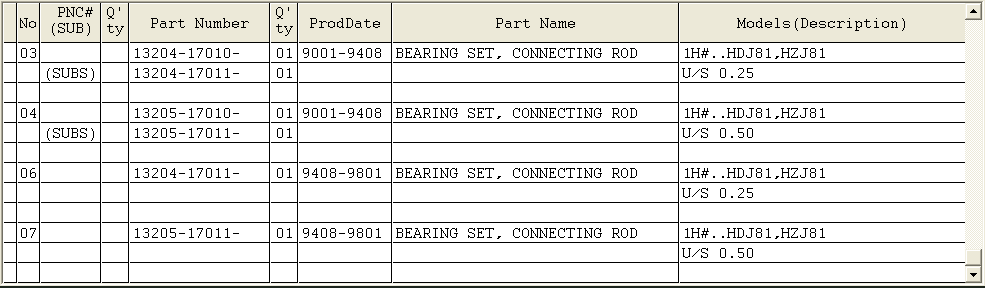

I know this has been discussed a lot on a lot of forums, but I want to make sure of this piece of information. A friend of mine told me that Toyota has different BEB's on the market and if I check the parts catalog I should find the old part number "obsolete" and the the new part number that should work fine. If this is true can someone post the the two part numbers, plus the ACL part number as well to avoid any mistakes.
Thanks in advance
Issa

I'm going mad choosing the right BEB.
I have a HDJ81 japanese imported also, year 1991.
First time I went to purchase the stock BEB in Toyota, they told me that they had different sizes, so I had to tell them the size. They couldn't tell as my track is japanese and the frame number doesn't mean anything for the spanish Toyota software.
Then a friend told me that was wrong, that is the same size for all 1HD-T engines, but the thing is each cylinder has different sizes and, he added "it's quite confusing to choose what bearing size matches each cylinder, due to a weird japanese numeration system, so take care with what you do".
Then another friend told me about the ACL BEB's, and he said: "you can't go wrong with those, cause they are one size for all".
Then I rang the ACL dealer and he wanted to know if I wanted standard or oversized bearings.
And now, I see wussywup thread, and, if I understood it well, ACL bearings are also different sizes for each cylinder.
To make things worse, I have just bee told that maybe not all the 1HD-T engines have the same bearings.
Can somebody help me to clarify what size of bearings do I have to order, I might be so stupid or this thing too complicated.
I was advised to use ACL standard size, plasti-gauge each during the install, and buy over size if any did not plasti-gauge within spec. All of mine were OK and I haven't read about anyone needing to use over size.
My inexperienced guess is that the over size bearings are intended for use if the crank journals have been machined.
G'luck, -Steve
Thank you Wussy Wup.
The problem is that I order the bearings from England, and takes 5 days or so to arrive.
So if I find out I need oversized during the install, I'll have to leave the car in the garage for five days or more. But that's not very likely to happen as you said.
So, are the all 6 ACL bearings the same size or are they different sized for each cylinder like Toyota ones?. I'm worried about this cause I heard of a guy that installed Toyota ones in the incorrect order and found himself rebuilding the engine 15000 Km after.
Canonero, not saying it would never happen, but we have yet to see, or hear of a set of ACL's not fitting to spec on an HD-T engine.
Sure, I don't worry about the ACL's not fittig to spec, I just worry about my mechanic not being able to choose which bearing is the right one for each cylinders. (You don't know spanish mechanics, I could write a book on them).
That's why I want to know if each bearing from the set of 6 ACL bearing is the same as the other 5, or, like Toyota's, they have different sizes for each cylinder.
