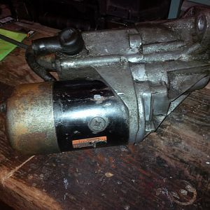

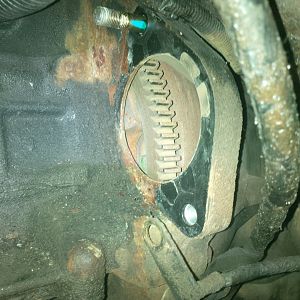

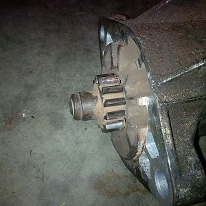

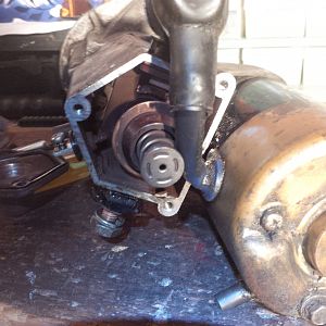

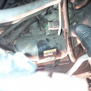

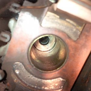

So I was able to pull the starter tonight. I will say that top nut was very hard to get at, but was fine after that and not getting the little screw nut off first. Here are some photos: the truck will stay in garage till parts come in (28235-17030, and contacts: 28226-54320, and 28226-54220) starter did seem to be open/ extended in flywheel when I pulled it and had to push in after. I am sure with just a cleaning it would work if I wanted to reinstall till part arrive, but that starter pull was too difficult to do
unless necessary. [URL="https://forum.ih8mud.com/media/hdj81-starter.55335/"][/URL]

Well yes. But I found it very hard to pull the starter. When I reinstalled I noticed that it sounded like the starter was still protruding on flywheel. I pulled the starter again and reused the same plunger and now it works. Both parts looked the same. I picked up the rebuild parts at a local starter shop.

Got this done last night, the top bolt on the starter is definitely a PITA, before putting it back in I pushed the wiring harnesses up and out of the way, made reinstallation much easier.
