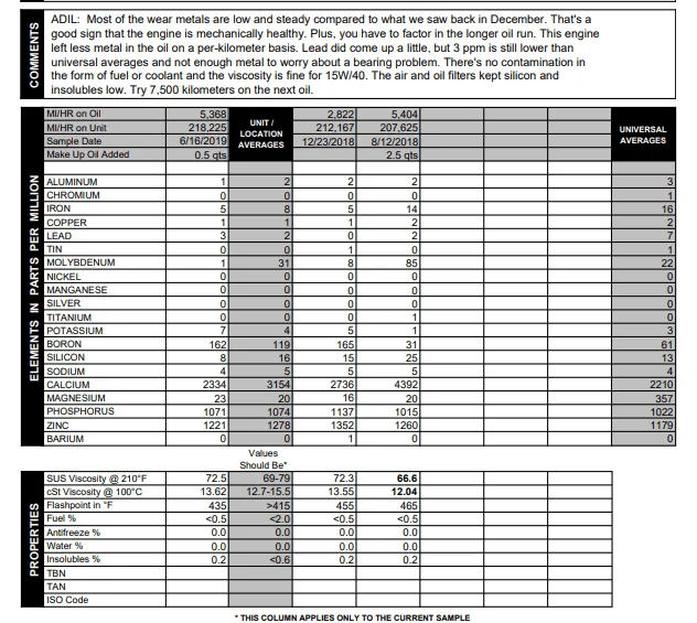

Hey man - Hope all is well.
I'm not a chemist or chemical engineer by any means so take my words with a grain of salt.
I also heard similar news about Shell removing some of the zinc properties from their Rotella line. However, I heard this was actually done a few years ago (source diesel mechanic). I am a little concerned as well but my oil analysis confirms it's still slightly above average for the 1HDT.
Schaeffer oil is supposed to have "more" zinc, maybe something to look into.
From left to right on the oil anaylsis.
15W-40 T4
5W40 T6 (Winter)
15W40-T4
I've also used Delo in the past but they are SN rated now, which I believe is rated safe for gasoline engines w/catalytic converters. I've used Motul in my race car, but I never did a oil analysis to confirm properties/wear.
Hope this helps a little.

Also to add he's claiming T4 and T5 as junk or in-superior compared to other oils. I don't know, my oil analysis says it seems fine. I'm not a brotella fan by any means but he seems to hate Shell.
