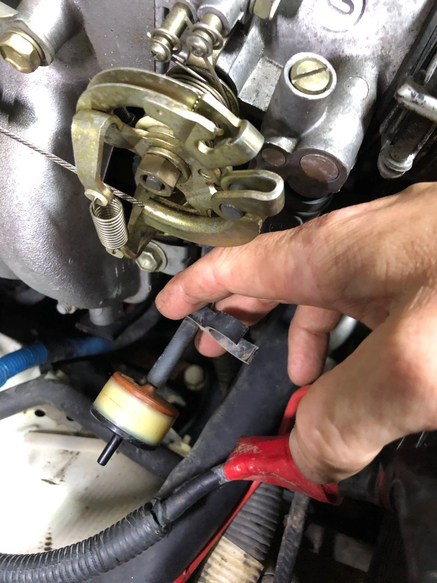

@gnob where is that valve? And would you know how to troubleshoot it?
Anyone know where this thing is supposed to connect to? It's connected on the other side via a vacuum line just under the throttle cable.
