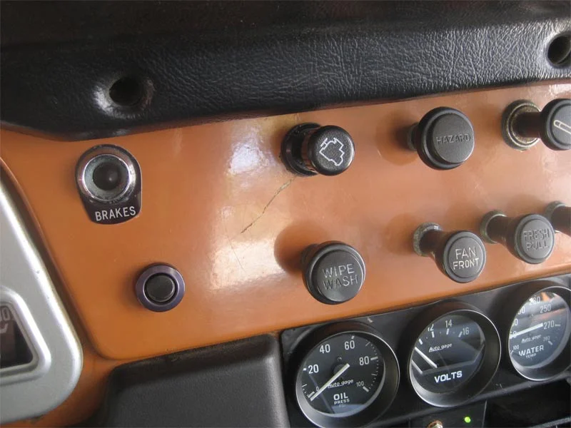

First I slid it through the firewall to determine the distance and how it lined up. I chose to use the hole just above the factory wiper switch on the dash (73 FJ40). I may have to spin the wiper switch behind the dash as the electrical plug won't come off without removing the throttle at the dash but we'll see. Then I determined I needed to add another throttle attachment at the engine. I ended up settling for a generic choke kit in the "Help" section. It's way more than I needed but did provide for the small bracket I needed to attach to the throttle.

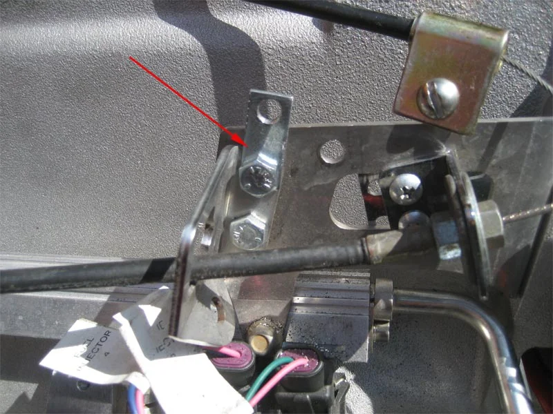

Next I determined where the throttle cable mount would bolt to the bracket on the motor and where the throttle cable ended. I drilled a hole in the aluminum bracket and attached the mount, then used an existing hole on the throttle linkage to attach the new adapter used from the choke kit. Two bolts and away I go! Wow this was too easy!
Yes it was. I had the throttle screwed all the way in (clockwise) and as soon as I spun the knob (counterclockwise) the cable slacked instead of tightened. Oops. So back to the drawing board.
After setting the knob correctly I reset where the cable mount should go (used an existing hole this time) and fabed a quick extension to lift the new cable up and out of the way of the primary throttle cable. Then I determined where the end of the cable would be and I was able to use the same bolt as before to attach the second cable attachment.
Pic 1: extension
Pic 2: attached throttle mount

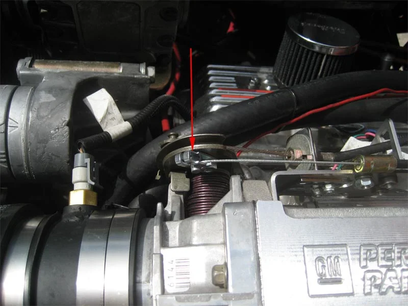

You can see how the cable is attached to the throttle assembly in PIC 1. I was careful to make sure the bolts and attachment were nice and narrow as it would interfere with the throttle body at wide open throttle (see PIC 3).
Pic 2 shows the final assembly and how it sits nice and high. It's not going to win any awards at a car show but it works nicely. :)
