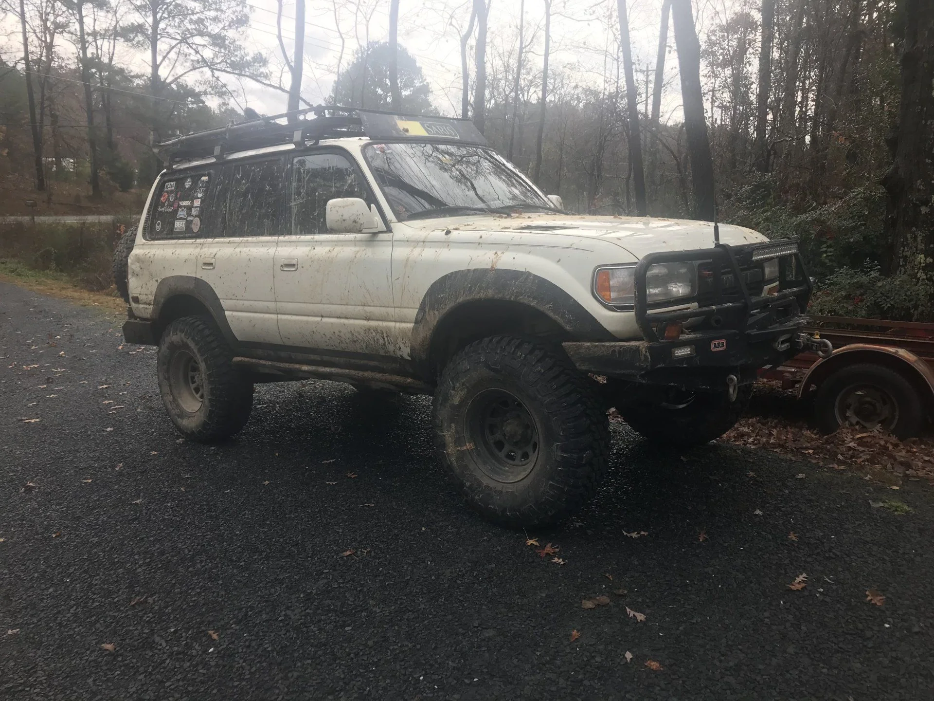

4LowandSlow came by after his URE adventure today and looked over all three of my sick vehicles. According to our up and coming Toyota specialist, it is only the bolt that is needed for the tensioner on Logan’s PS pump. Evidently the bolt is not difficult to find and Gman gave me the part #. We also came up with list to replace radiator and other parts in the Hundy. I have radiator and ps pump. This is what we came up with:
Top and bottom radiator hose
4 clamps
Thermostat & gasket
Transmission fluid x 2 qts
Distilled water 2 gallons
Radiator cap
Power steering fluid
Bolt 88446-35010
Efi relay
PCV hose
2 hood struts

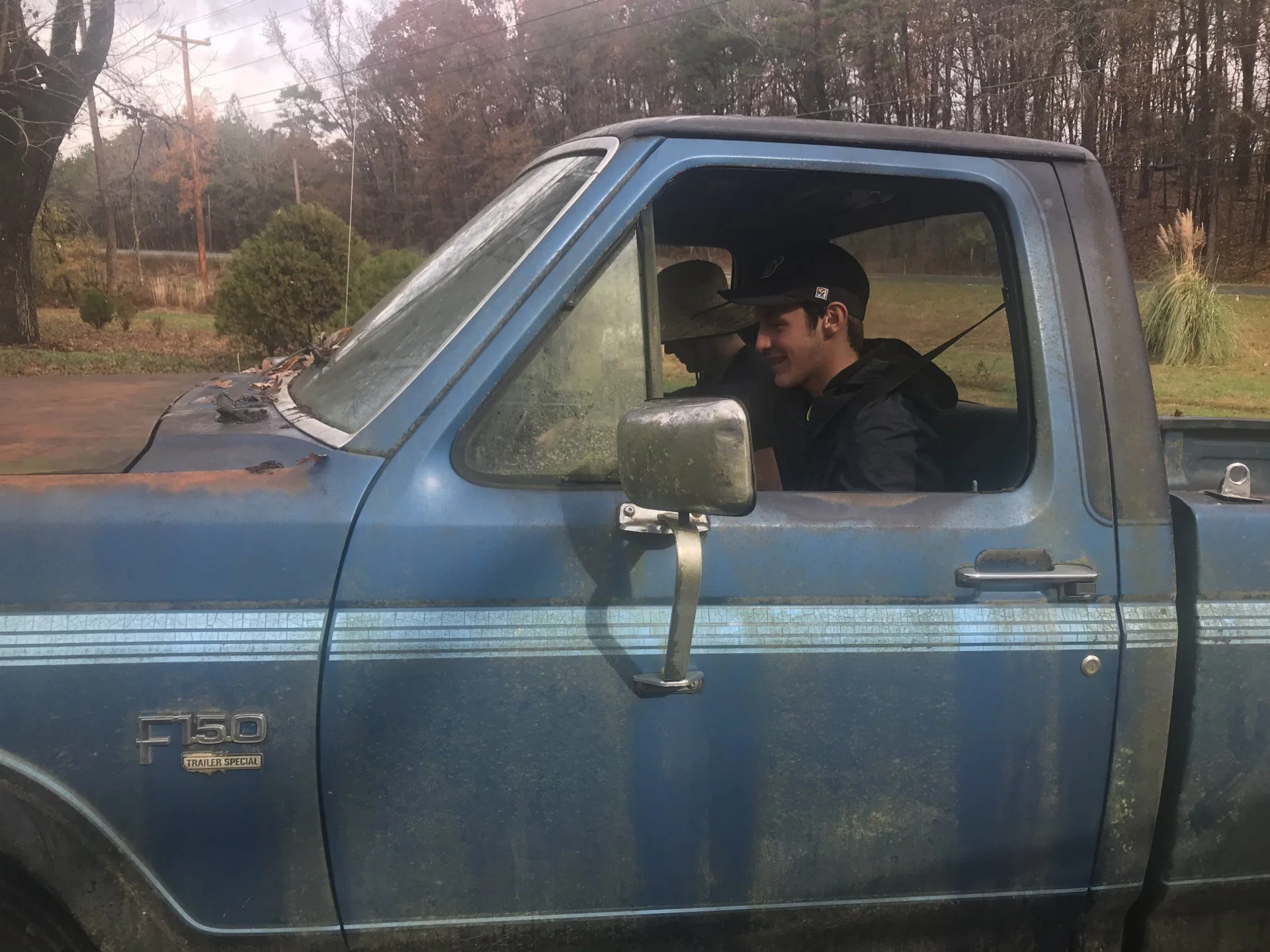

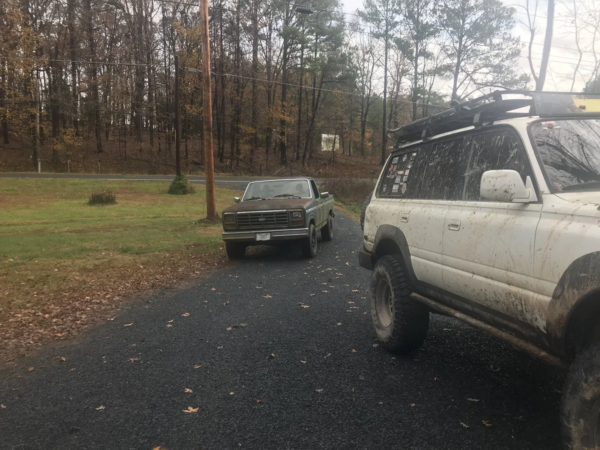

Gman also got my 84 F150 up and running for me. It’s been sitting in the woods for about a year and It took him all of 10 minutes to breath life back into the old girl. You the man Garrett! Thank-you
