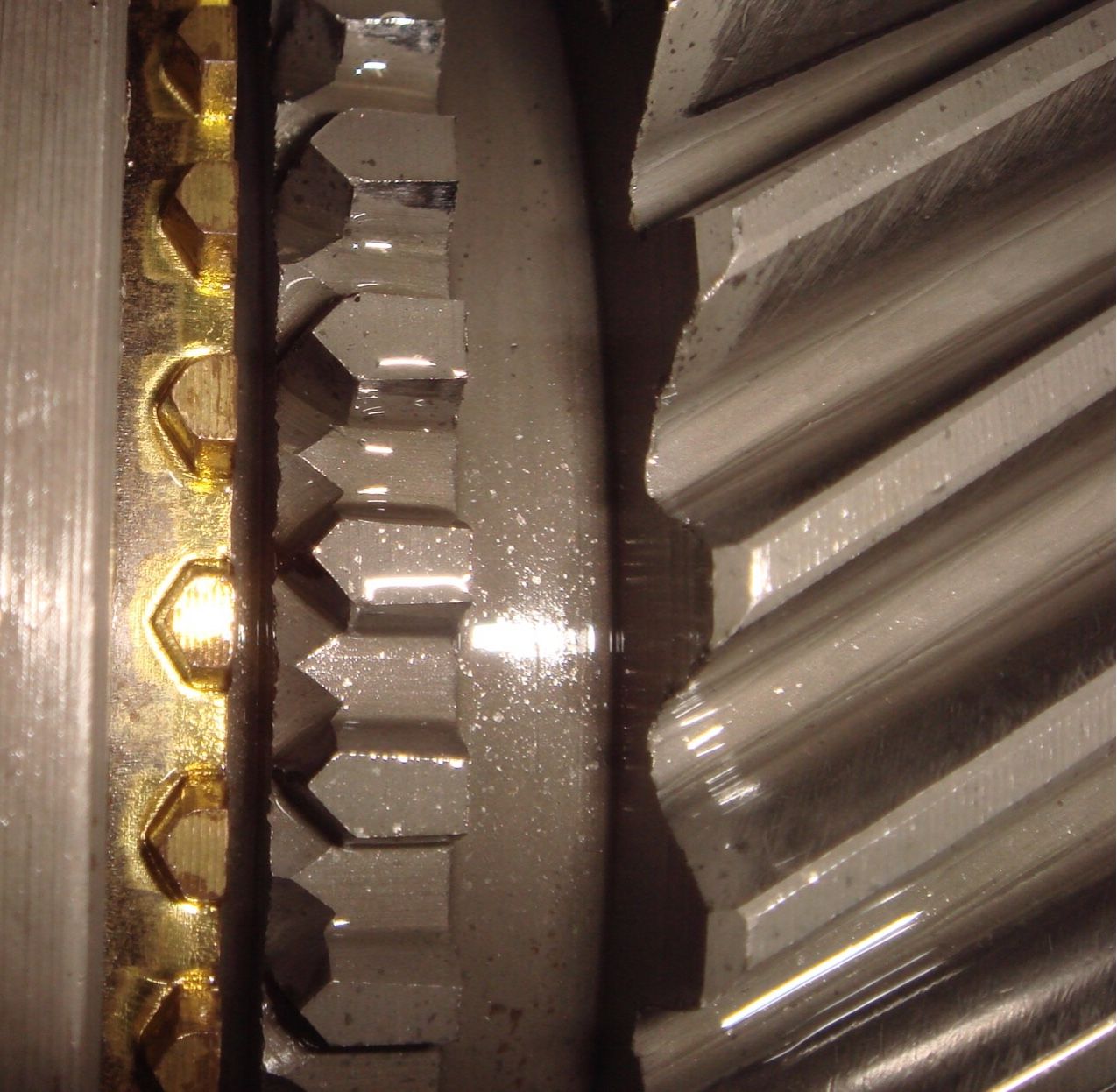

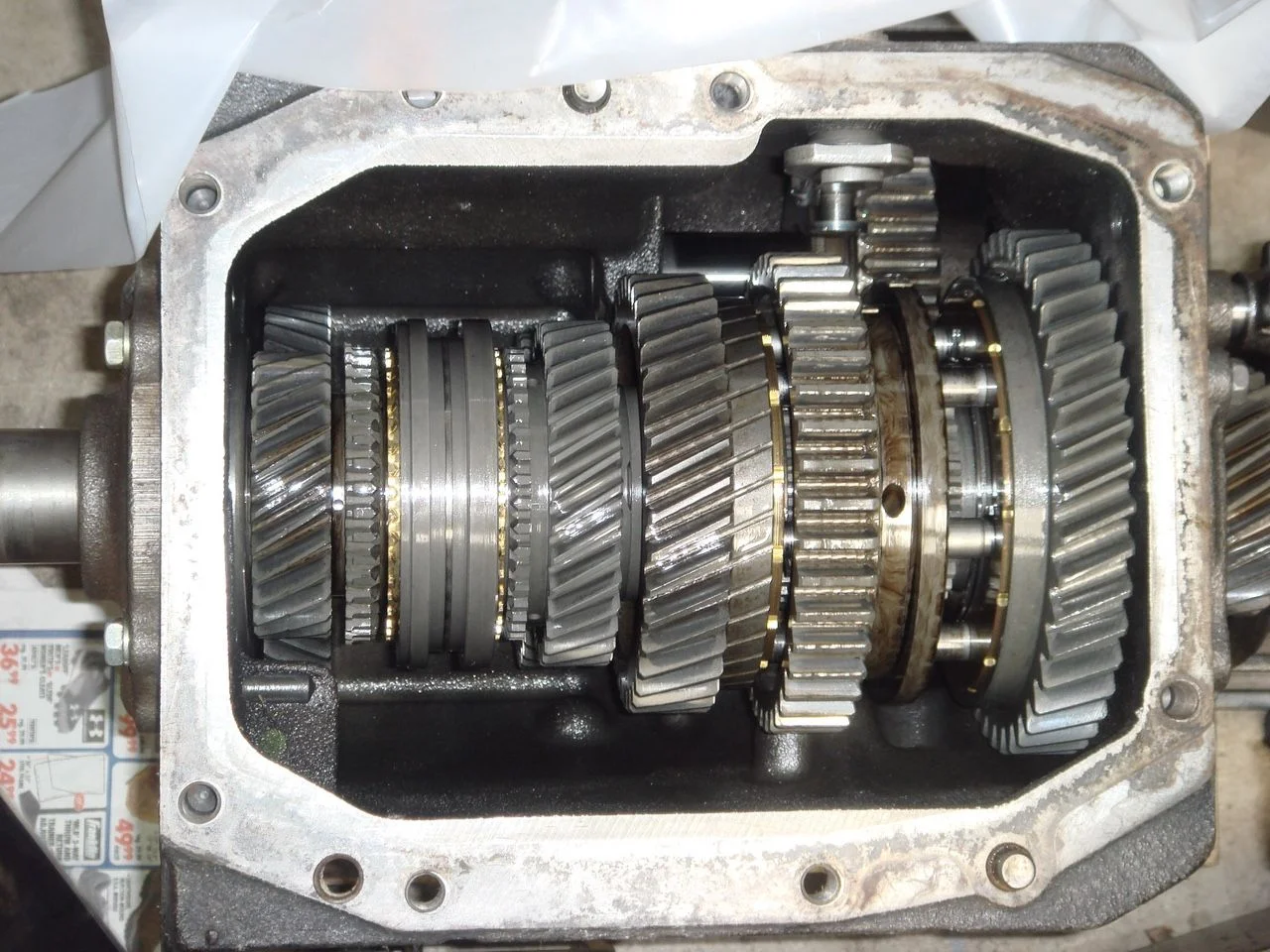

Here's a picture of its innards after 210,000 miles and 27 years.
Synthetic oil keeps everything sparkly clean.

those pics are amazing. I have some autozone 80w90 in there now, which i guess I will run for about 1k. After that I am switching to red line MT90 (already ordered).

@Output Shaft x2 Those pictures are amazing. Your 5 speed has lasted longer than my 4 speed did, and you definitely have more miles on your rig than I do!
