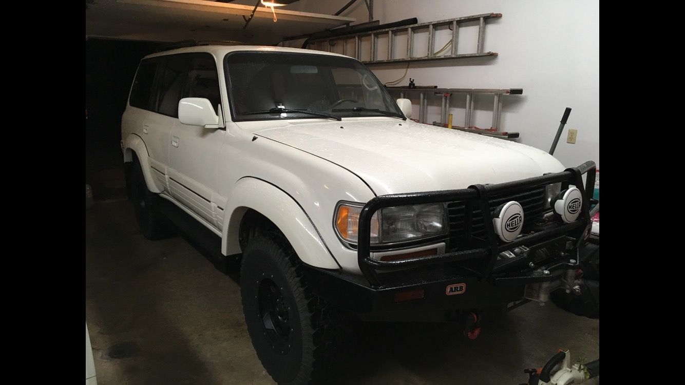

I bought this 1996 modified LX450 on BAT
The seller is a Landcruiser enthusiast with a lot of experience sourcing parts from South America, Dubai, etc. He has a complete package for MT conversion, including the interior trim pieces. He has offered them to me for $6k. Amazonia is a shop in FL that he used for his build and they are prepared to install them.
The truck currently has 4.88:1 gearing and 17” wheels with 315/70 Maxxis.
I would love to have a MT but am concerned about compromising an already somewhat limited highway use that I require from the truck...to begin with, I will be driving it from FL to NM
Any suggestions? Does anyone here have direct experience with Amazonia?

I looked into a manual swap and from the few people I spoke with who had done the swap, they spent roughly $6K all-in. However, they did these as a DIY or had a buddy who was a mechanic do the work on the side. I'd imagine that if you were to pay a shop do the work, then it could be closer to $9K. With that said, this assumes you wouldn't sell your transmission and related parts which could help you recoup the costs of the swap. I'm also not sure if you'll need the 4.88 gears, but given the tires you're running, you'll probably want to stay with the 4.88. Anyway, the swap isn't a simple job, but it's also not rocket surgery (from what I was told), but you certainly want someone who has done this swap before do the work. If it were me, I'd get in touch with @SNLC or another known shop on this forum to price it out and potentially do the work.

That’s a cool rig. If you enjoy manuals, I’d convert it if I had the cash. If anything, the H151F should make it MORE enjoyable on the freeway. It should make the engine more efficient in getting more power to the rear wheels and perhaps slightly more fuel efficient.
While you are at it, consider a part time conversion and Delta rear panhard bracket.

@Hidesert Welcome to MUD and congrats on starting the money throwing hobby with a bang! Seems like you got a very nice rig there and I am sure you will enjoy it. I read through the BAT listing and figured I would let you know, if you don't already, it looks like it has not had a head gasket job, so it is something to keep your eyes on throughout your ownership. Not all HGs go on these but its something to just be aware of and take extra care of your cooling system.
second the cd changer is still installed and currently useless, so you are going to need to obsess over that like everyone else does here on what you are going to put in there to replace it! (hint: the plug to it provides both an ACC source and +battery source for something else you can put in there.)
Third and answering your question, the cost of that swap isn't very cheap so I don't think the price list is too far off for the parts. I will say that those who have done the swap claim that it significantly increases the MPG (memory seems to be to about 17mpg or so) and it apparently really adds some pep. It is your cruiser and if you want to do it, do it.
forth and pretty important, that swap will need some ECU magic if you want it to pass emissions in most places, in the US, where emissions are required, you will need the stock ECU to be fooled that the automatic is still there and there are people on here more capable to talk about that. Where I live in Georgia, any vehicle 25 and older is exempt so if I did the conversion i would be getting one of the MT version of the ECUs from South America or other OBDII nation to put in mine and is going to be an additional cost. Don't get confused that OBDII in say Venezuela are the same in the US, they aren't exactly, the readers still work, but the emissions equipment don't.

As a price comparison, 6k sounds about right (at least for not trying to source and piecemeal a kit yourself):
I'd try out the auto transmission for now and see what you think. I used to think I wanted a manual in my 80 but the auto has been great, and much better offroad than I expected.
