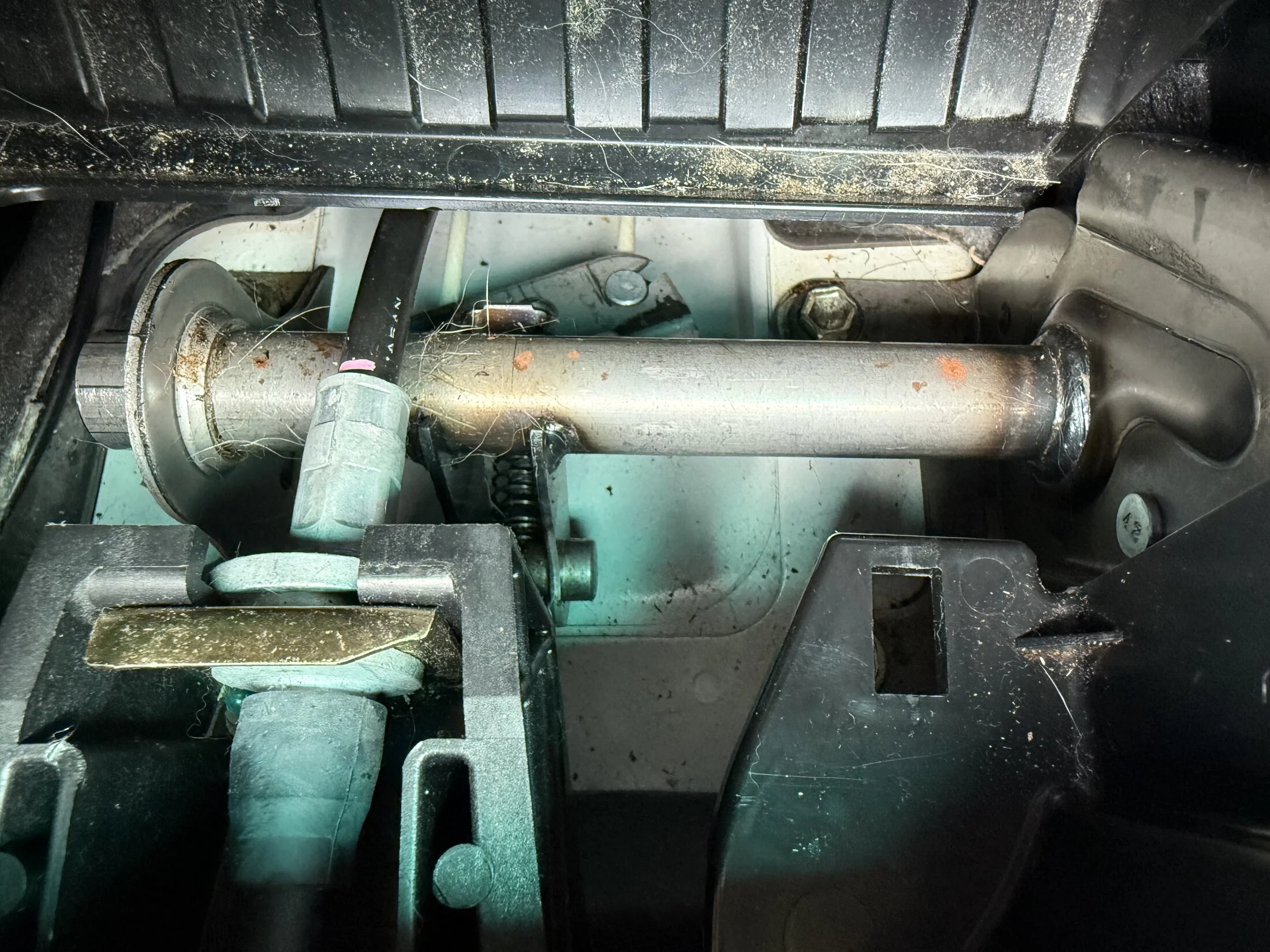

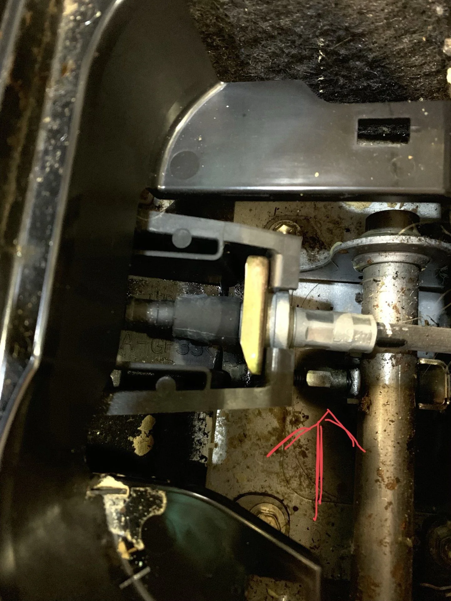

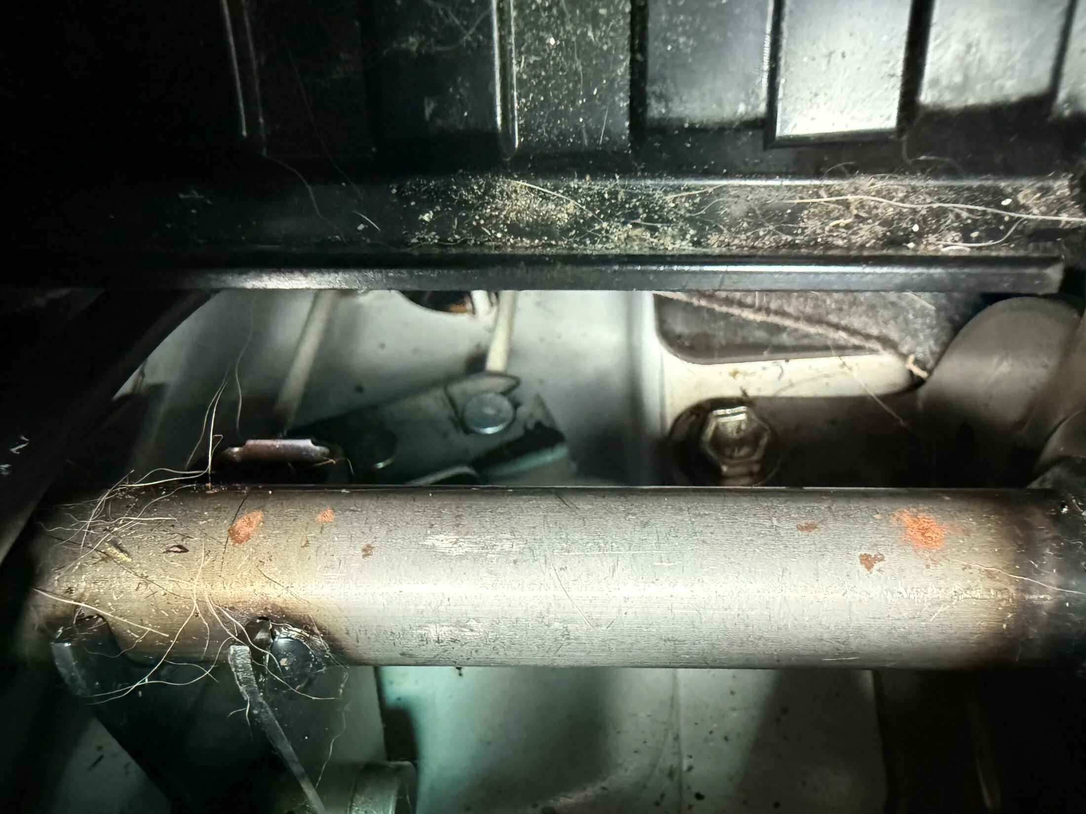

Sometimes the tension on the e brake will come loose as well and you need to take up slack. To do that you can pop out your cup holder (just pull straight up) and there is a nut that you will turn clockwise to take up slack. I tried the option previously posted but maxed out my star nut and the e brake still wasn’t working. After tightening this nut under the cup holder it solved the issue.
this might be a stupid question, but do you tighten this nut with the parking brake engaged, or disengaged? Also, does the transmission need to be in neutral or park?
parking brake is a tad loose. Since I’ve just got street parking where I live, I’d like to try this before finding a parking lot where I can put the rear end on jack stands and make adjustments at the wheels.
Disengaged is easier to tighten.
Tighten disengaged. Crank adjustment until it completely stops all motion. Back off 2-3 clicks. Job done.
Thank you, Dan and Taymar. That was an easy fix and the parking brake feels way better. Took like 10 minutes.
