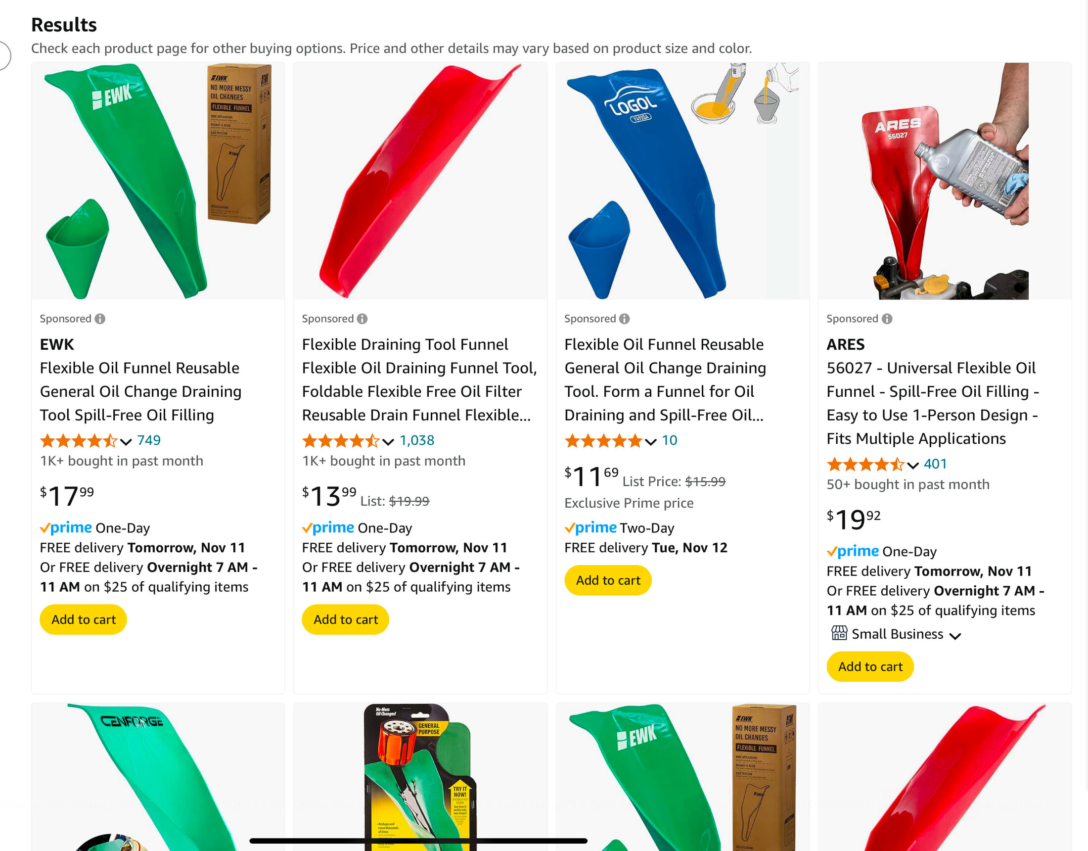

You guys take away all my fun... 😆
I have a funnel that attaches to the oil filler threads, best technology out there, also a fumoto valve will help underneath, I put them on all my cars.
I don't fully remove my front skid in either the GX or 4Runner, they both have ARB skids, so i jam a cut 1 gallon bottle up there and it catches everything in both trucks when I change the oil filter and then dump it in the drip pan. If I did remove the skid then the form a funnel would be great.
