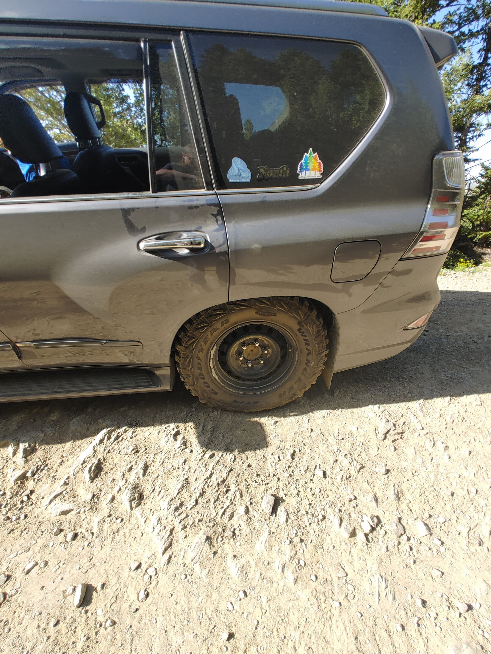

This is a 17x8.5 -8 with 285/70/17 P-rated Kenda Klever AT2 at stock height. Certain tires are bigger (P vs LT, brand to brand), so fitment varies but that's roughly what it looks like.
I did not need a BMC for my 33x10.5s or 285/70R17s, but I run oem steelies with the least amount of poke possible to maximize tire size. I cycled the rear more than front.
