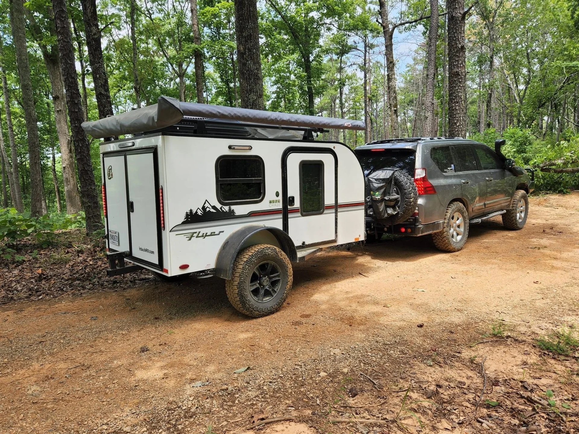

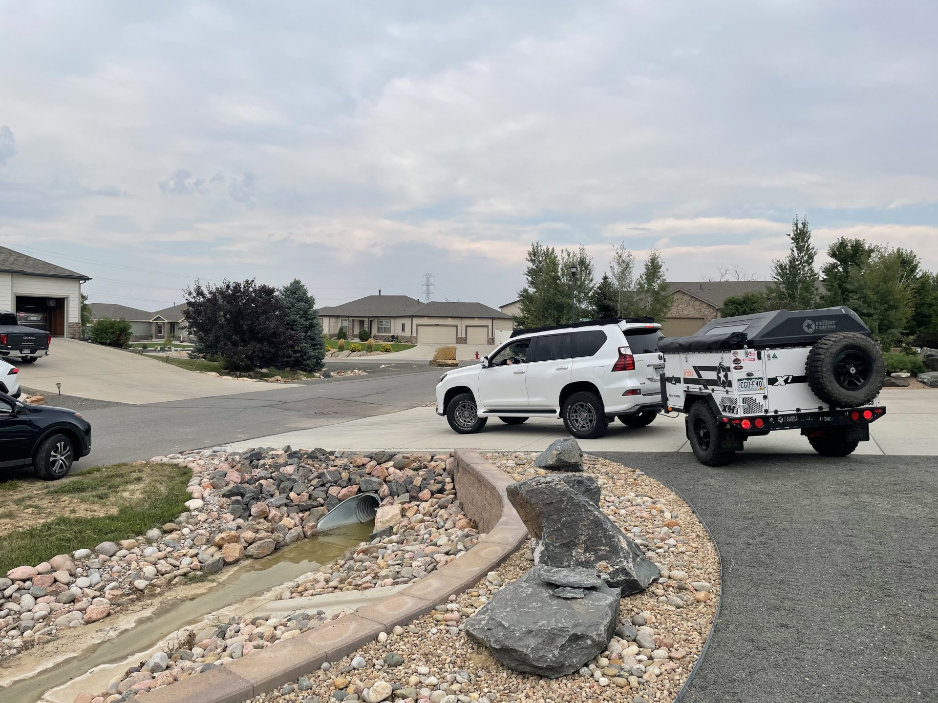

Following this has produced a safe and comfortable experience in the GX. I tow a small off road camper trailer that weighs 2500 lbs dry and is probably 3000 lbs wet and loaded. MPG is about 13, down from 16… I will say though, that if I had anything larger, like 4000 lbs, its Tundra time.
Love the trailer!
@URJ150L dig the whites out on the K02s - nice
thanks… do the same thing with my Tacoma.
