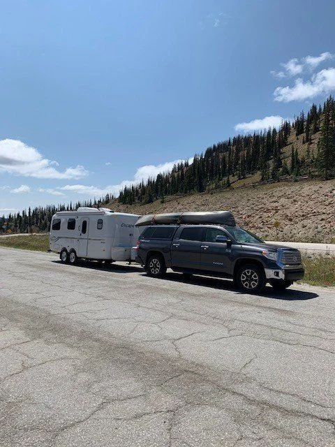

I tow a race car a number of times a year, usually around a 1-200 mile round trip. Total weight is about 4300 lbs plus some gear in the GX. I use an E2 weight distribution hitch/sway control and brake controller. The GX tows it well with no drama. There's a couple of steep mountain passes that it slows down on, but they are less than a mile long so I usually tuck in behind a semi truck that's going as equally slow up the pass. Besides the steep grades it is very capable at towing.

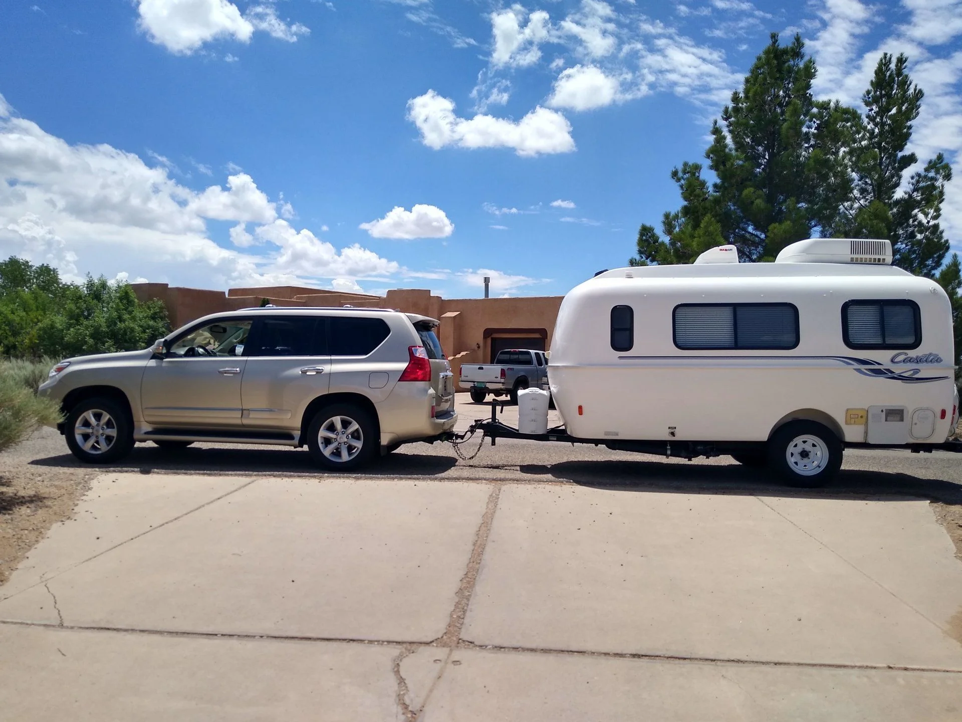

We have a 2010 Casita 17ft travel trailer that I tow with a 2012 GX. Trailer doesnt weigh as much as your Escape but tows very well. I just have a sway control too, no WDH and it handles it fine. I have a Redarc brake controller that is mounted in one of the unused switch panels and is just awesome. I'll upload a couple of pics.
I like how seamless the Redarc controller looks in the dash. Casitas are great little campers! We had a Spirt Deluxe Casita before the Escape which I really liked.

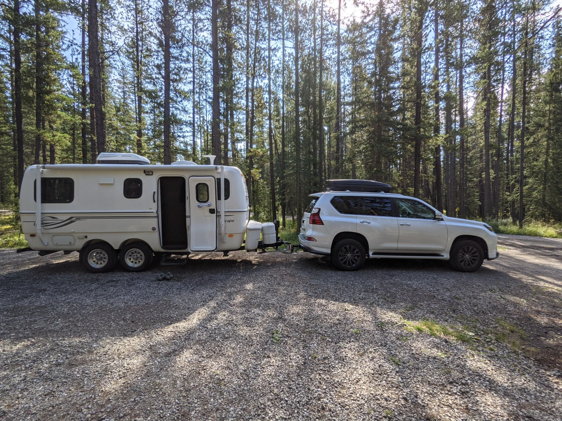

I know this thread is several years old but a good reference. We have a 19' Escape that fully loaded weights 4200 lbs. We had been towing it with a V6 2008 4Runner which was OK but definitely underpowered so we upgraded to a 2021 GX 460. The additional power from the V8 is noticeable. My other concern was the side swing rear door which ended up not being a problem at all.
Looks very similar to a Casita.

How does the Escape compare to the Casita?
The Escape being heavier and having the tandem axles you know you are towing something. It is extremely stable when towing, even with strong crosswinds and semi trucks passing. I use an Andersen Weight distribution hitch and Redarc brake controller, both which I really like.
I tow at 100 kph (60 mph) and average between 13-13.5 mpg towing, even towing through the mountain passes in the Canadian Rockies (vs 18.5 - 19.5 mpg combined city highway).
