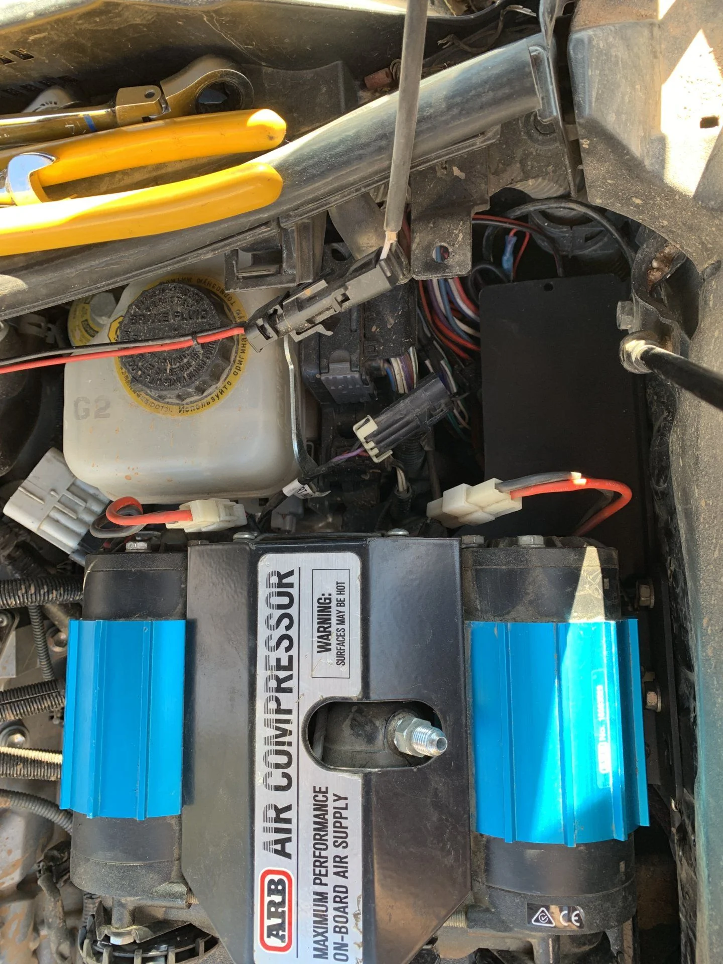

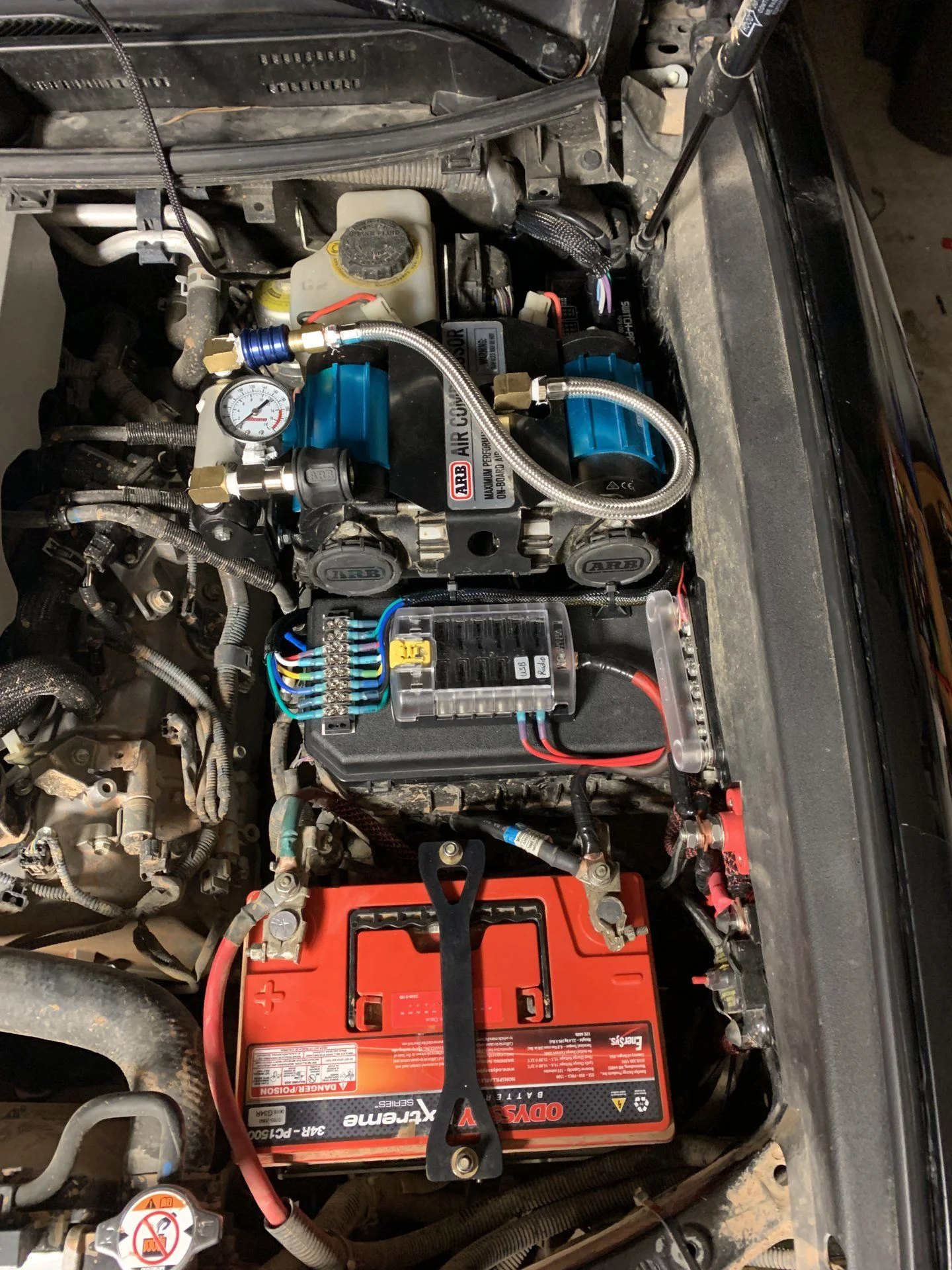

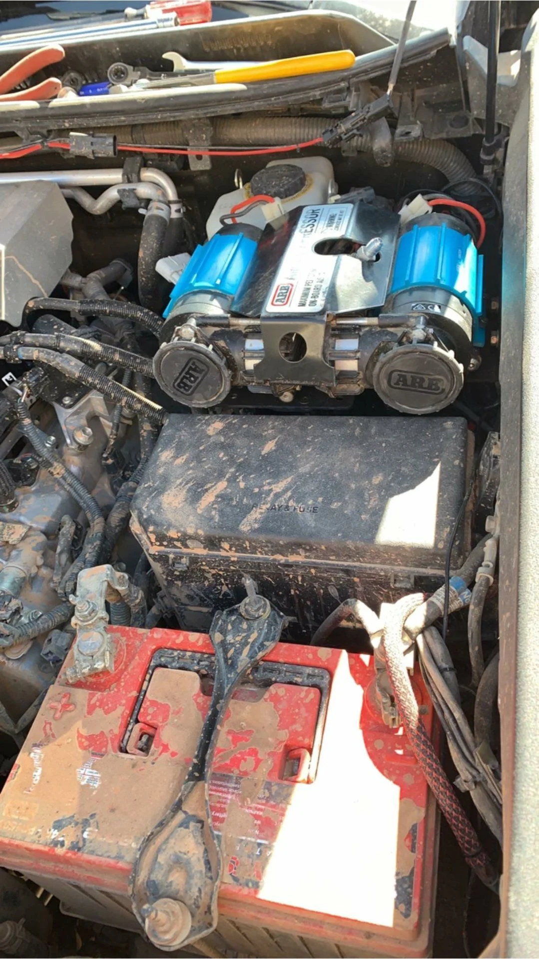

I am working on getting the ARB dual compressor mounted under the hood. This is requiring me to do some reworking of the electrical that I have already done. When I went to Rago Fabrications so they could use my vehicle to design the 460 ditch brackets Mario gave me the prototype mount they used to design the 5th gen 4Runner compressor mount. This weekend I pulled out the fuse panel I had installed previously and test fitted the compressor mount.
I found that everything lined up perfectly. Last week I got a sweet deal on a switch pro that will allow me to remove the fuse panel and light controller I have currently. The Rago mount is designed to mount the switch pro directly to the mount in the back near the firewall. All I need to do now is figure out where I can mount a new bluesea fuse box.
The guy that I purchased the compressor from had removed it from a GX470, so he sent it along with the slee 470 mount and the manifold for adding lockers. I plan on adding lockers here in the near future when I change out my gears. I cut off the manifold mount from the slee bracket and welded it to the Rago mount. All I need now is the switch pro which should be here this week.

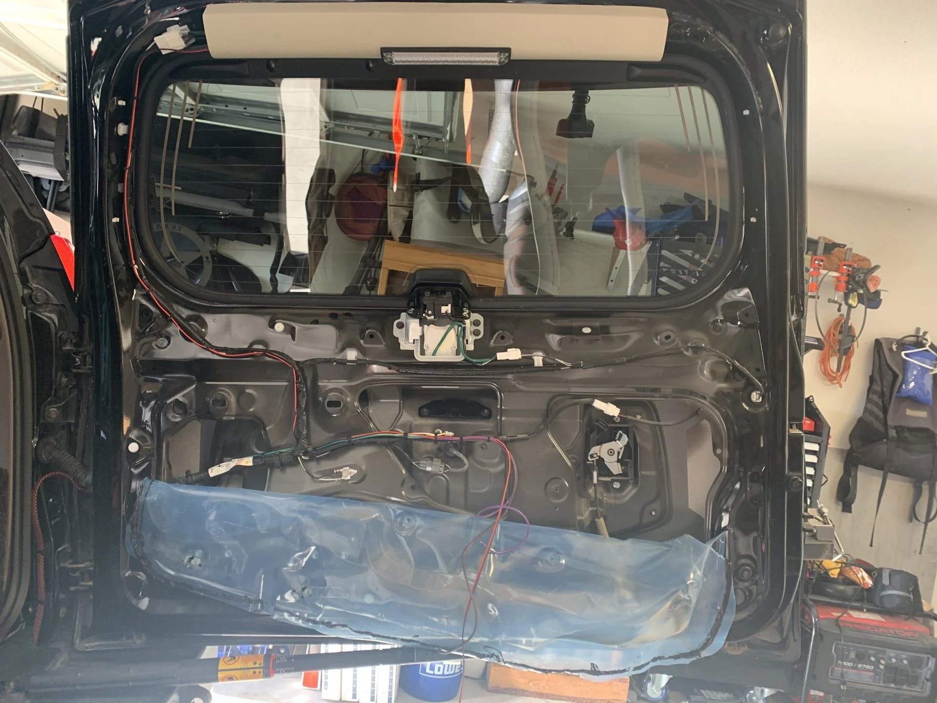

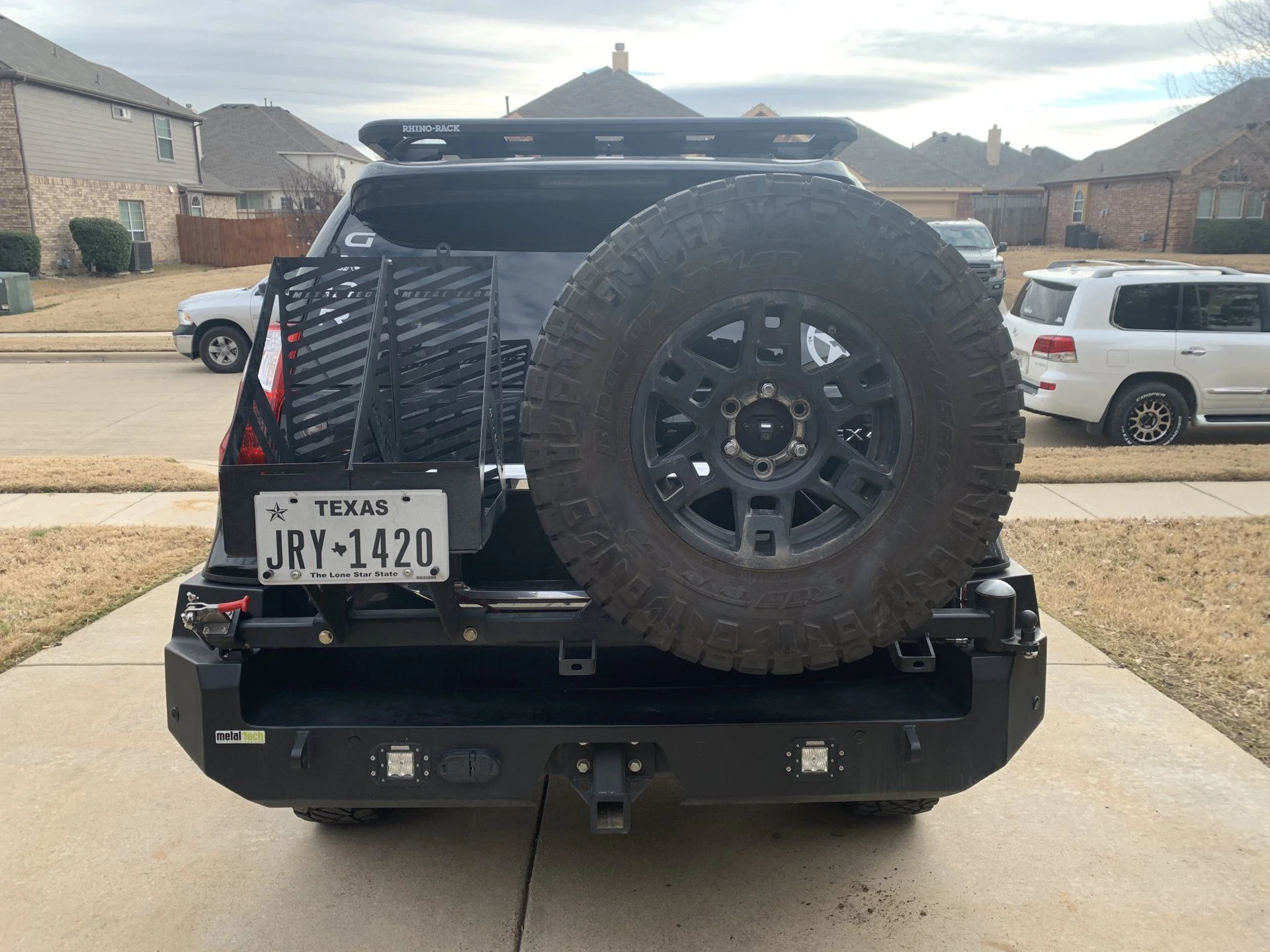

looking good man! what kit did you go with to relocate the rear camera?
HitchCrack, you and I are on the same page with what you're doing! Except with a minor twist.
I too only see my spare tire and just a peek of what's behind me.
Since I have the same rear bumper as you with the same features, you'll know what I'm talking about.
I plan on adding a small bar to where my HAM radio antenna mount is attached so it extends to between the spare tire and my jerry can racks. I plan on mounting my camera to to that. I've also considered maybe using an aftermarket camera that has the delineation lines for distance.

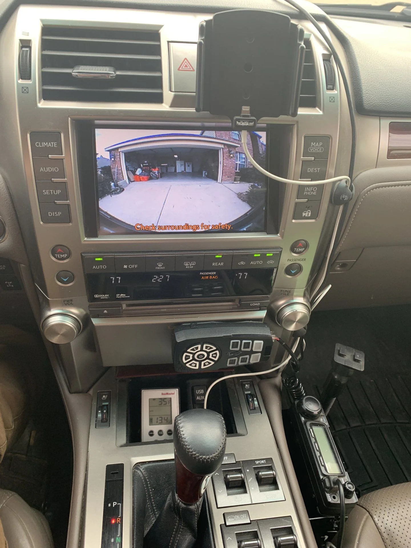

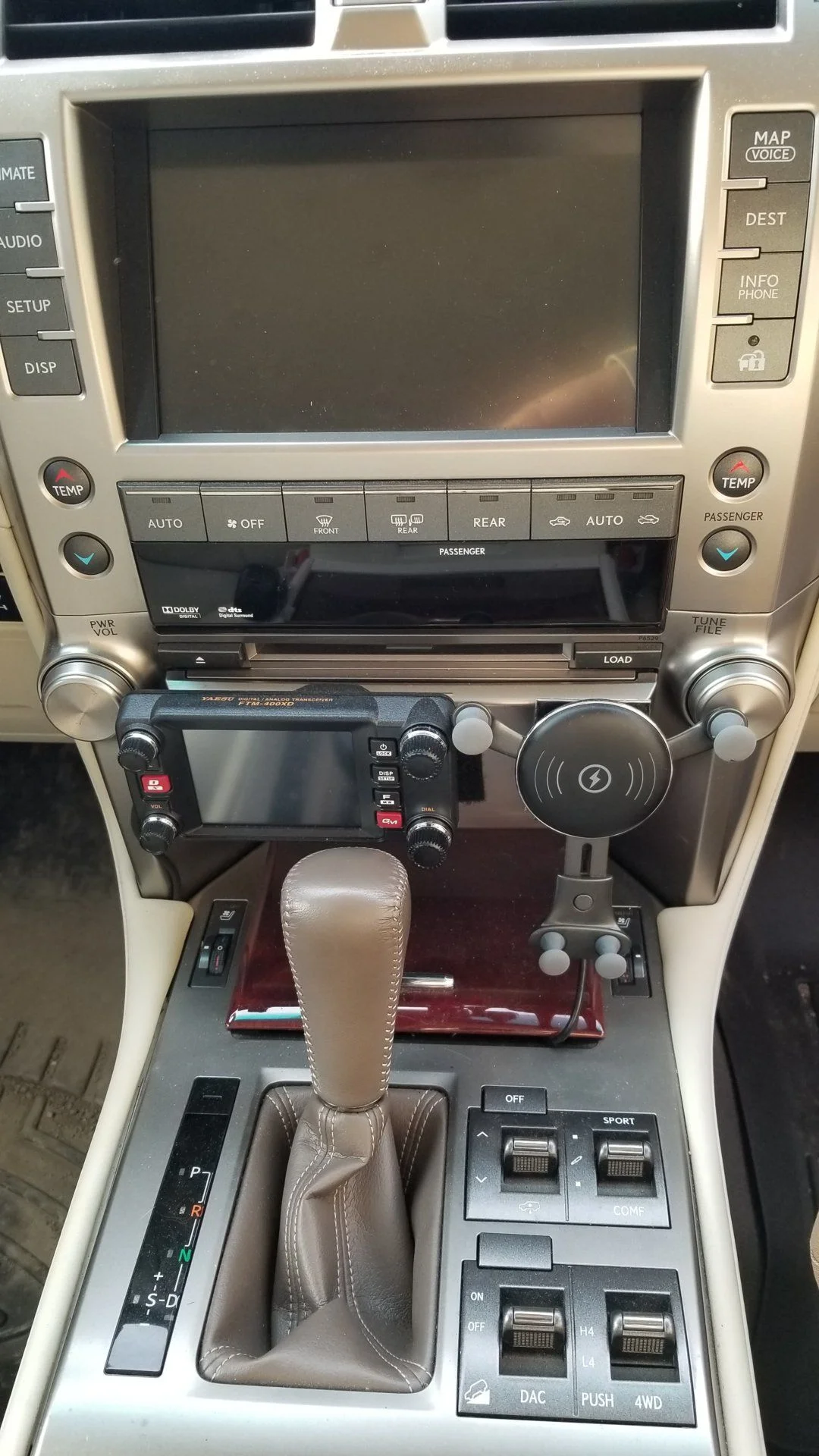

Also, since you did a little show-and-tell of your console, I thought I'd share what I've done with my center console:
The left is my Yaesu FTM-400XD HAM radio and the contraption-thingy on the right is my wireless charging phone holder. Since I never use that useless (my opinion only) slide down audio controls, I just mounted them on that with double back tape. Works awesome! Easy to read, out of the way and not intrusive or too ugly (that may be relative).
Thanks for the heads up! The charging cable is pretty darn thick.
Also, as a side note, I love this charger because:
  • I can just set my phone in and remove it with one hand. When the phone rests on the bottom bumpers, it causes the sides to move inward and clasp the phone on the sides. When you remove the phone, unweighting the phone from the bottom bumpers allows the sides to open up again. Easy-peasy!
  • I never have to plug it in! Just drop it in and it starts wireless charging.
  • It's the fast charge design (5amp) so even if I'm using Google maps and streaming music via Bluetooth from my phone, it will still charge and hold at 100% when it's topped off.
If anybody is interested here is what and where I purchased it: https://www.amazon.com/gp/product/B07DZRPZQN/?tag=ihco-20
Note: I just used the heavy duty double back tape (usually used for mirror squares) to mount it. It's very sturdy.
