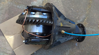

You can locking difs in. Same as you'd have to do with a '40.
https://plus.google.com/photos/112245478940579893987/albums/5958880503646346945
