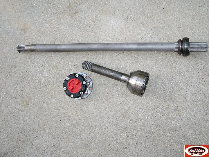

Longs sells chromo long side elocker axles as an alternative to stock. Check him out for price.
Only for a full 30-spline set. You've got to upgrade all the way across, but the price is not bad for what you get.
Mudrack has a few of the chromo replacement that's 30 long splines at the locker end and 27 spline (right?) at the birf end. He wants around $200 for them.
