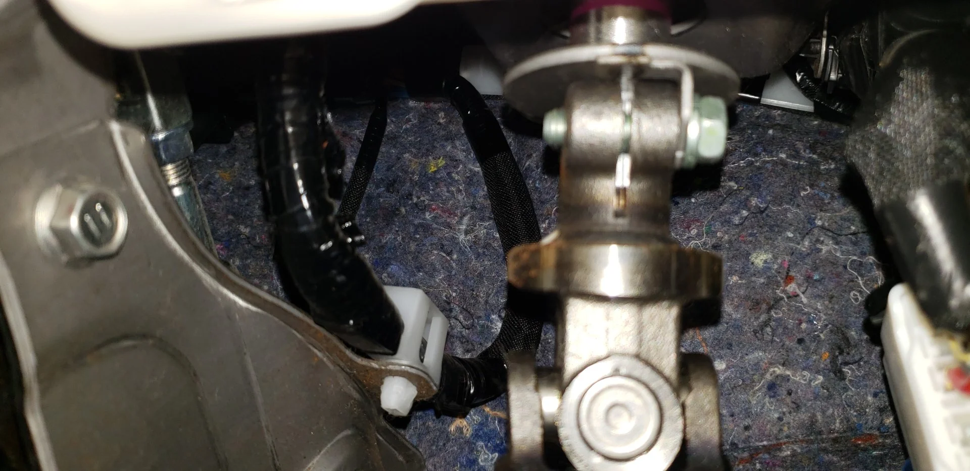

Yes, and after a little more inspection and putting my head down near the gas pedal, the noise seems to be coming from the rubber boot near the firewall inside the cabin

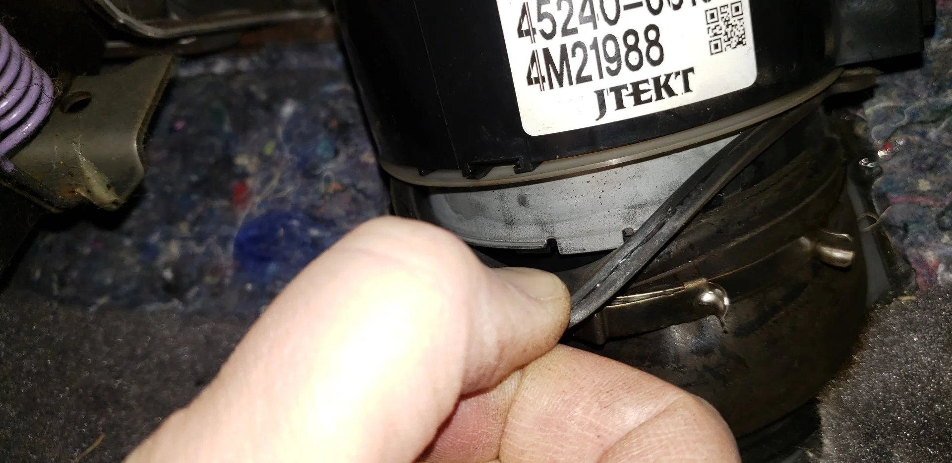

I put some silicone spray into these two places (see pictures; pulled back the rubber boot and also sprayed the knuckles) and it seems like the noise is gone. Will let you know if it comes back.
US market 200s have a variable ratio steering adapter on the shaft between the wheel and the steering rack. It is inside the passenger compartment.
What you hear could be this module doing it’s thing.

My truck makes a low pitched squeaky sound when turning the steering wheel while parked or at very low speeds, particularly when cold. I've sprayed silicone lube under that rubber boot a few times (as best I can) and it seems to quiet the noise for a few weeks or maybe a month or so but then it comes back. Since mine does it while parked it was easy to put my head by the brake pedal and turn the wheel with my hand to find the general area of the noise. Agreed it's inside the cabin and definitely not the power steering pump (at least in my case)

I had my mechanic evaluate it yesterday. As others have noted, he says it's coming from the intermediate steering shaft (my part number is slightly different from the one above; mine says 45240-60100). It does look like an expensive part ($1,700 - $2,700 online).
His recommendation was to leave it as-is for now. He was concerned that if we sprayed in lubricant, it could affect a sensor.
