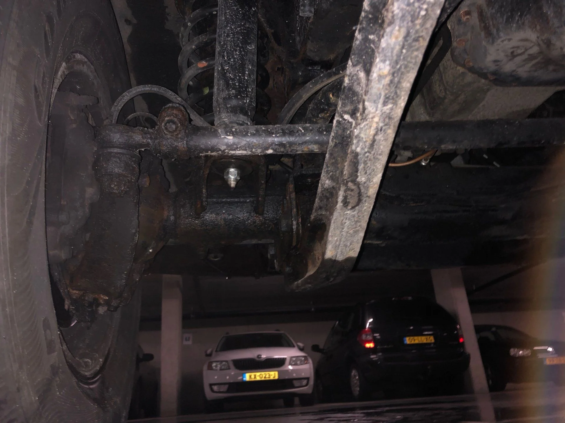

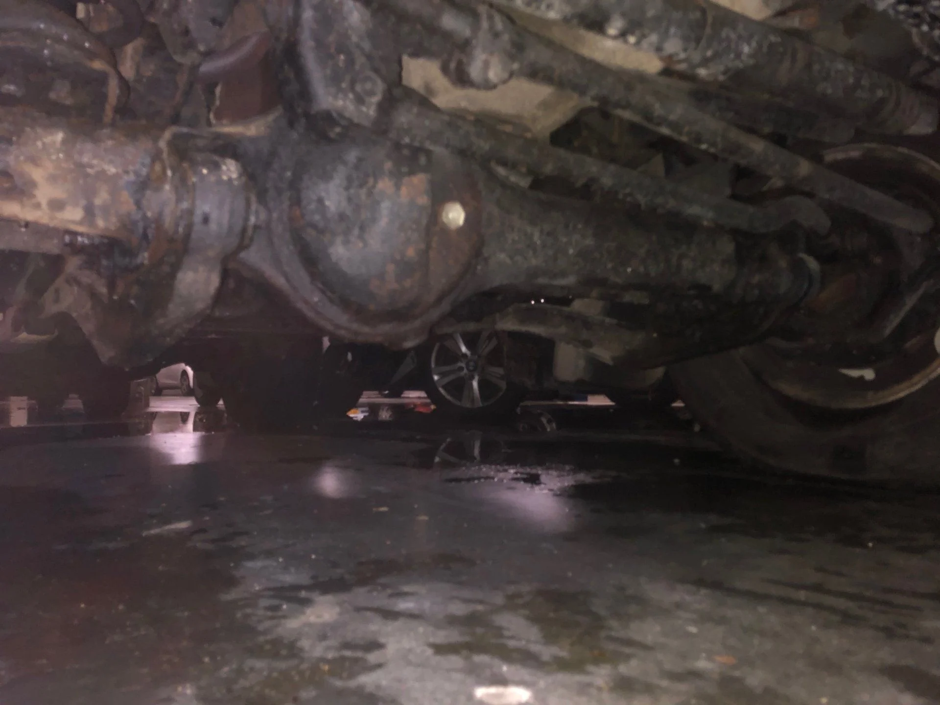

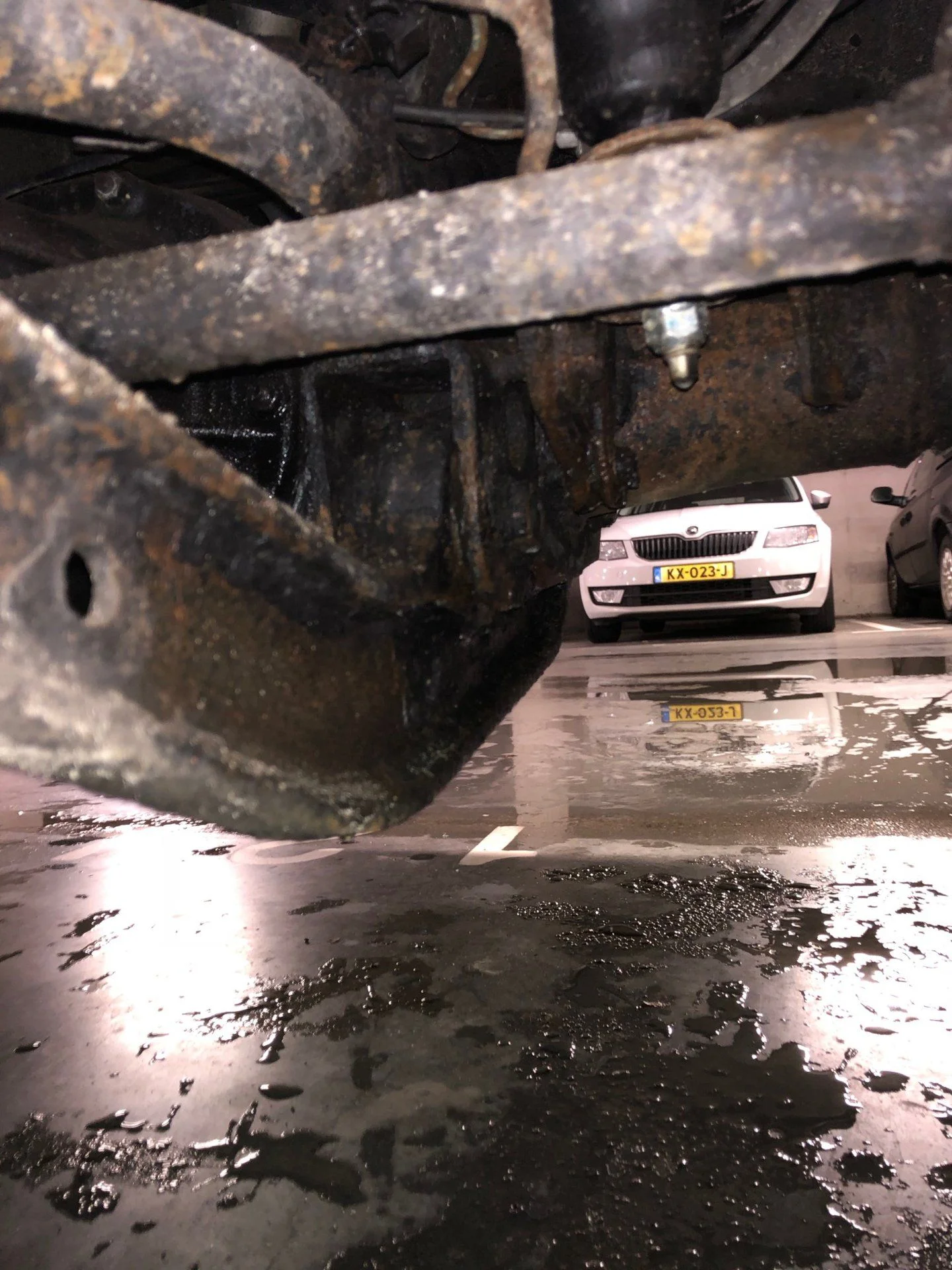

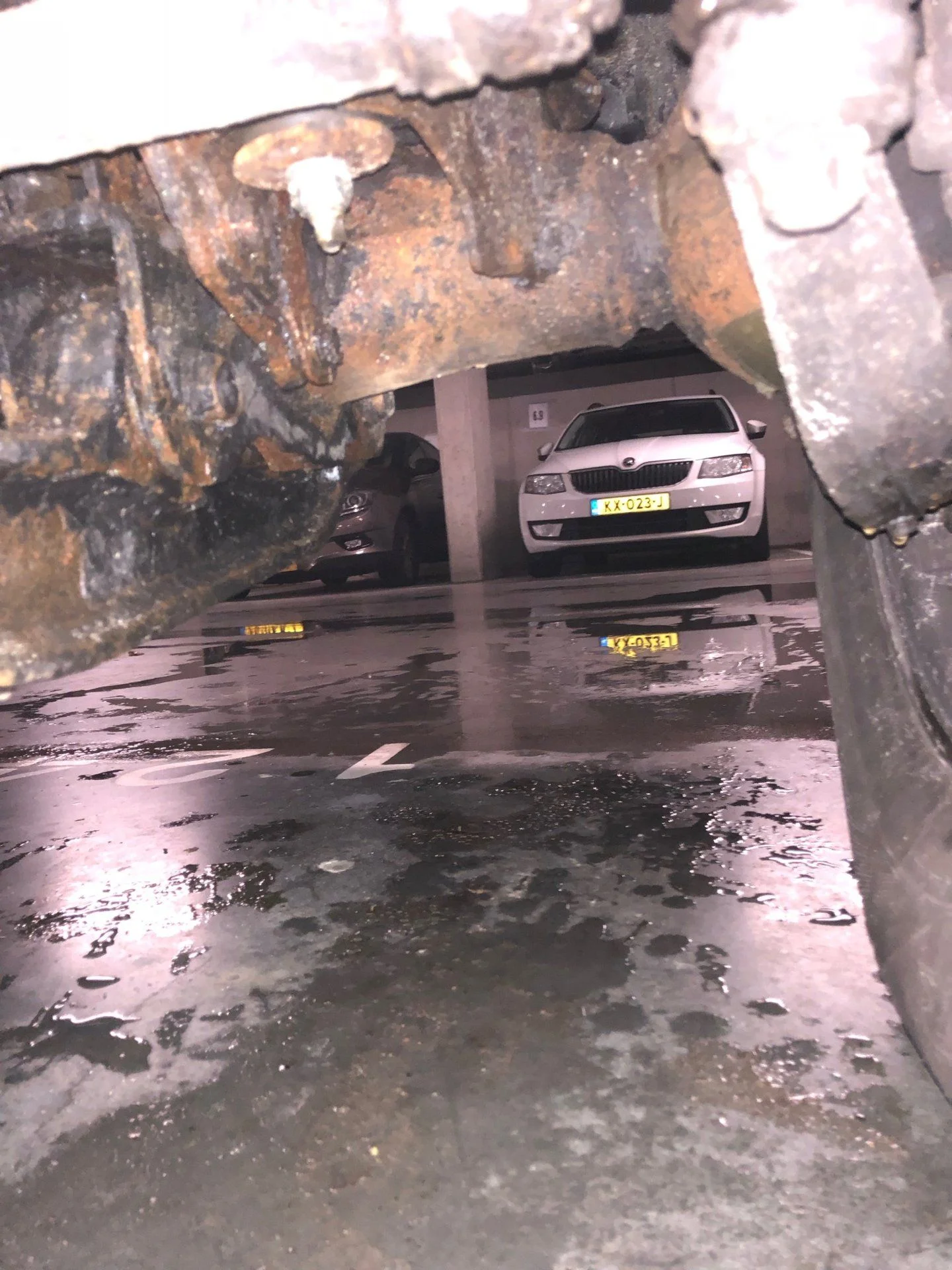

I checked the front callipers, all tight and bolts in so they aren't the culprit. I don't think it was them anyway because truck does move forward and backwards, and also the grinding noise (when it happens) can sometimes continue for a couple of seconds after the truck has stopped, so I guess it's more of a driveshaft/gearbox issue... I had a look at the steering knuckles and they are NASTY. covered in surface rust which is flaking off. I think they were basically junk axles the previous owner took off is truck and put on this one and took the good ones for himself.. pictures for your amusement.

Looking at your photos, your front axle looks to be way over due for service. I'd get the parts, along with a copy of the FSM, and spend the weekend doing a service on your knuckles. While your in there you might also find out what's causing your grinding noise. Here's a link to a great source of parts to rebuild your knuckles. Cruiser Outfitters This vendor is located in the USA, but As far as i know, this company has no problem shipping oversea's.
