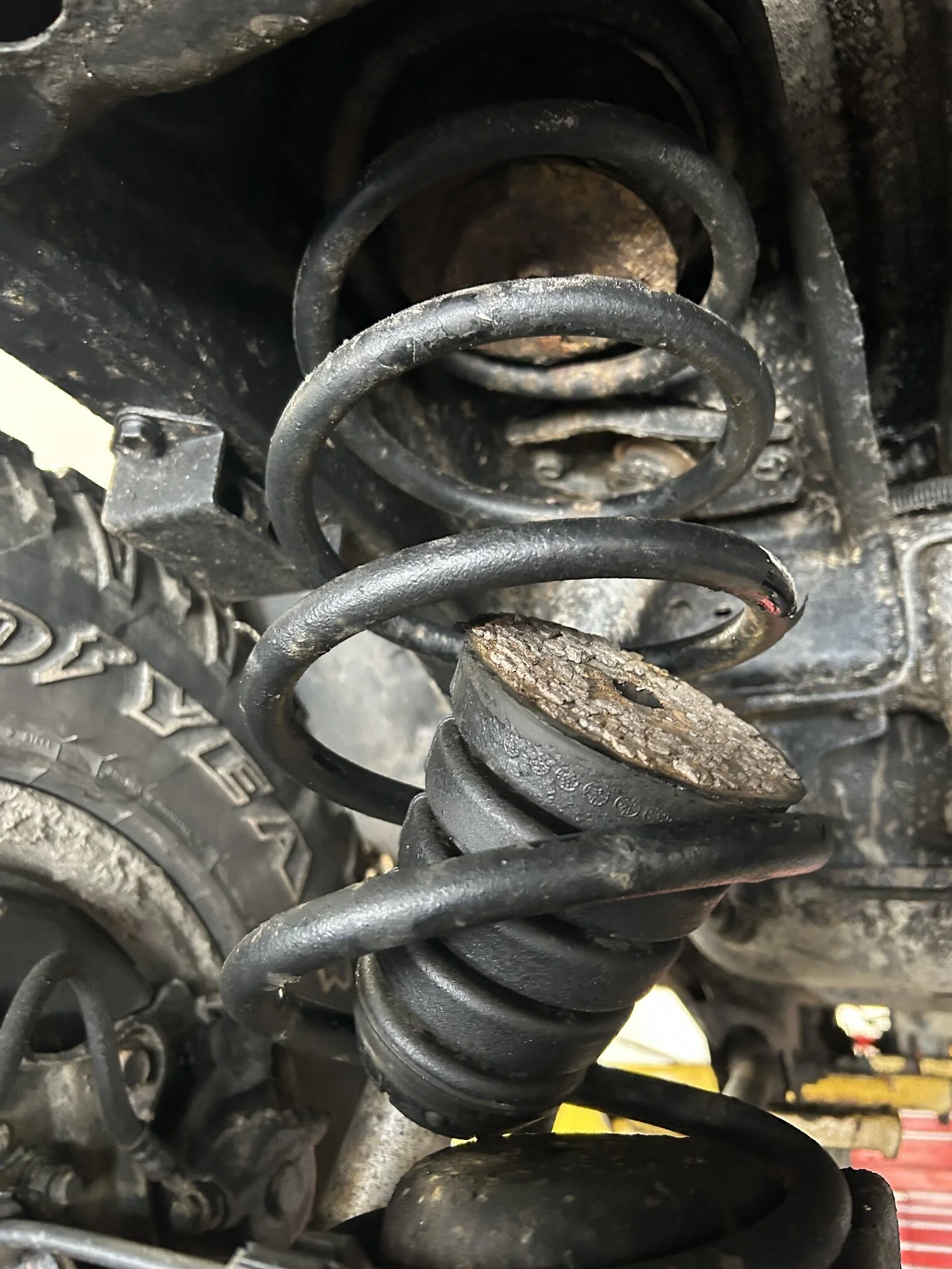

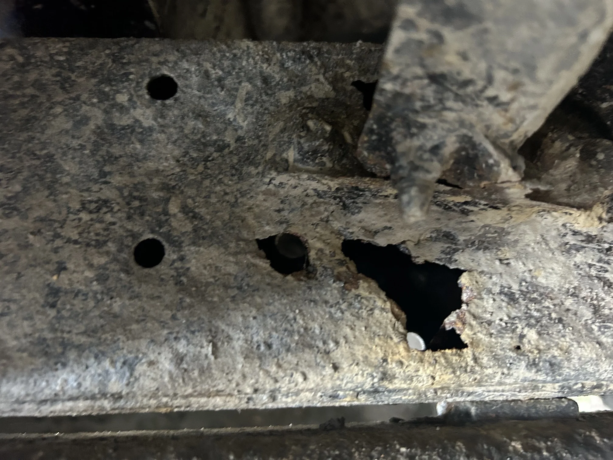

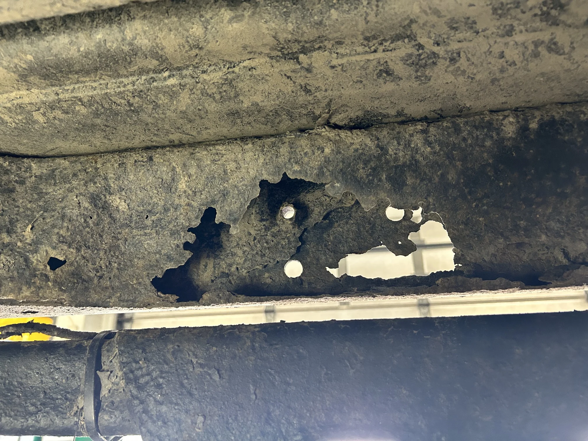

That's what I thought too, until I got it back from the shop (second opinion for suspension/steering issue) today. It has rust holes in the frame rail, and the left rear spring coil tower is rusted through. I knew it had some surface rust mostly around the wheel wells and a couple holes that I was told didn't affect structural integrity, but had no idea the true extent. I'm taking it to Main Line Overland for yet another opinion on Monday; I still want to save it if it's worth the $$$
OOOOO that's no bueno! The good news is light truck frames can be welded. You can grind off the paint and...stuff... and rebox that area if you choose. The rear frame member can be replaced with a bumper.

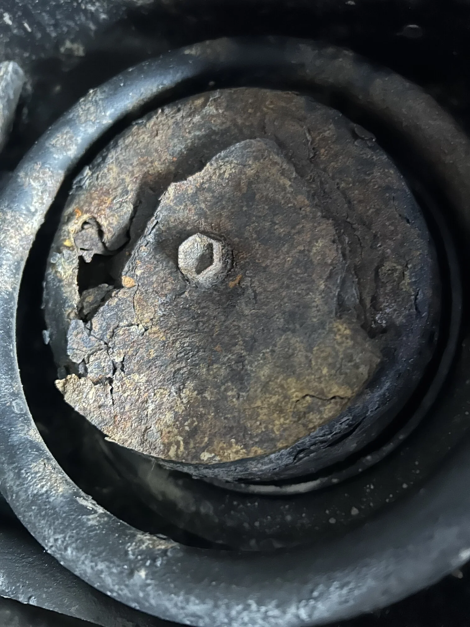

Even the spring tower? This is my first time dealing with this, but I've been chatting about this with ChatGPT Land Cruiser Part Checker, which told me that would be more involved than the frame rails, and all together likely to cost over $10K. How much do you suppose it will run me?
Is it just bump stop mount on the spring tower, or the entire spring tower compromised? The bump stop mount is fixable, but I am not sure about the entire spring bucket.
They didn't say. Can I tell without getting it on a lift?
You can poke the spring bucket with a long screwdriver to see if you find weak metal. I doubt it is compromised.
The bump stop pad rusts from the inside out when the drain holes get plugged.
I replaced both my rear bump stop mounts with OEM. Looks like Rusty already posted the part number.
