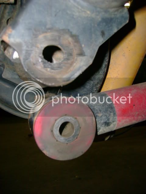

I climbed under and see that the bolt seems to be sliding back in forth in the rear control arm bracket. Hmmmph! I am supposed to go wheeling this coming weekend and now I'm not sure if things are safe for even daily driving.

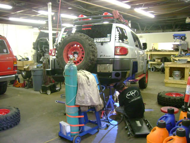

So I decided to send Daniel an email with the picture and see what he thinks. He replies that same night and says to come on by after work the next day (last night) and they'd be happy to take care of me before the trip. So they stay late and we drop the rear control arms to have look. And sure enough, the bolt has reamed out the hole in the bottom bracket. We discuss the options and decide the most solid solution would be to reinforce the bracket hole with some grade 8 washers. Brian grabs his MIG welder and centers the washer on the outer side then lines the bolt up inside the bracket and welds the flange nut on the inside of the bracket. They go ahead and do both sides of the axle just to prevent it from happening on the passenger side too. PERFECT! No clunking and it feels like it should when I hit the gas, solid.
Oblong hole with about 1/4" of slop

These are aftermarket LCA's (All-Pro Off Road), so doubtful TEQ would bother with it. The current theory is that the red poly bushings that came with the new LCAs are too stiff. I am considering reusing the old bushings (if they will fit) or looking for a softer set of aftermarket bushings.
This sort of wallowing can happen if the bolt wasn't tightened properly. There is always some play between the bolt and hole and if it's allowed to shift it will eventually damage the hole. The fact that you had stiffer bushings means that the factory torque specs would probably not be enough to hold the bolt secure and it would shift.
Those bolts are a Class 10.9 and I get down there and use my legs to tighten them up. It's not like you're going to break them.
