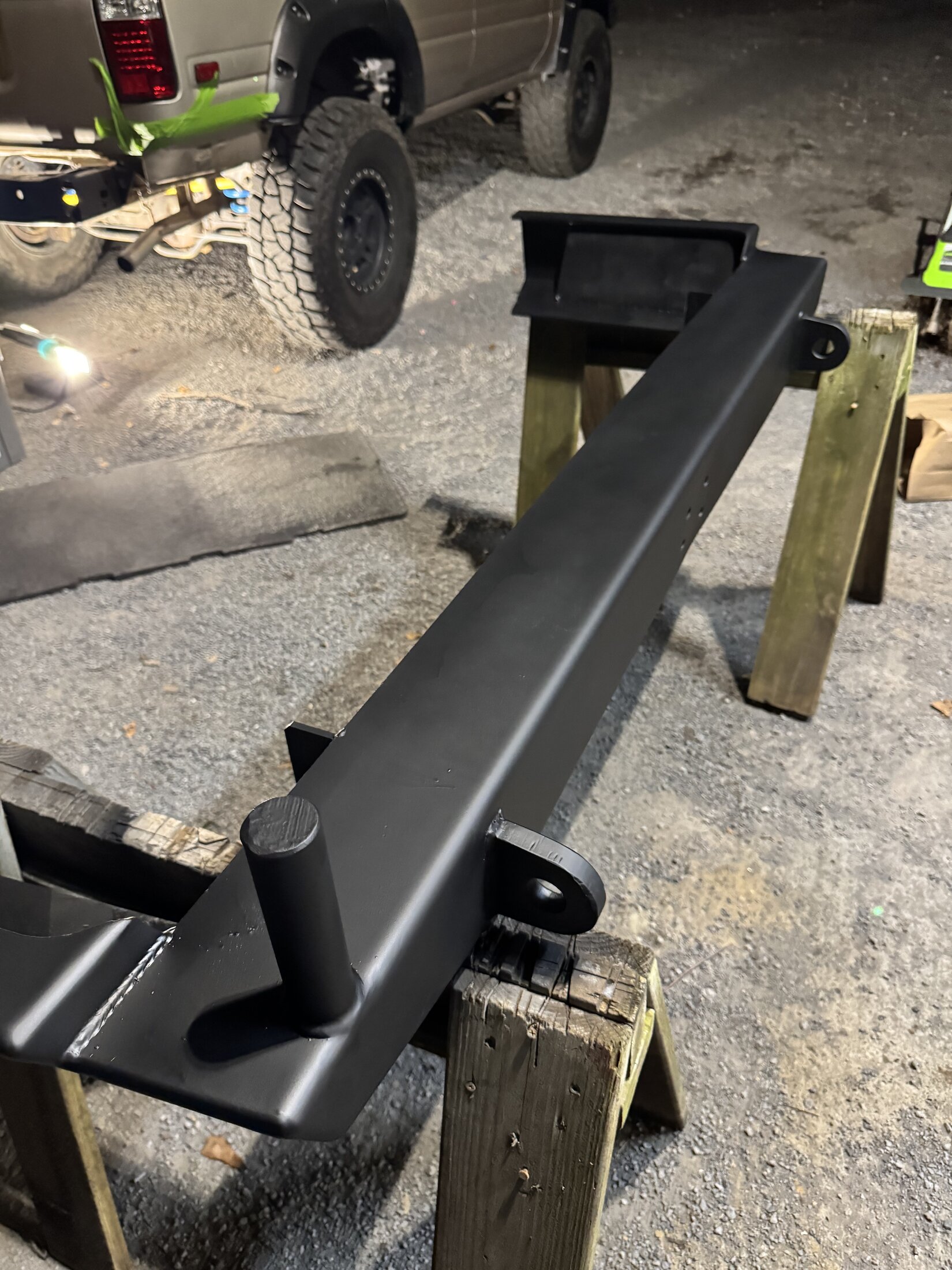

Hey guys, picked up this bumper off marketplace for Gray’s 80. Anyone familiar with who makes it. Really stout bumper. Hope to see who makes it so I can source a swing out tire carrier. It doesn’t have a regular spindle. It has a round piece of steel sticking up. TIA
Put Gray to work with the pressure washer and

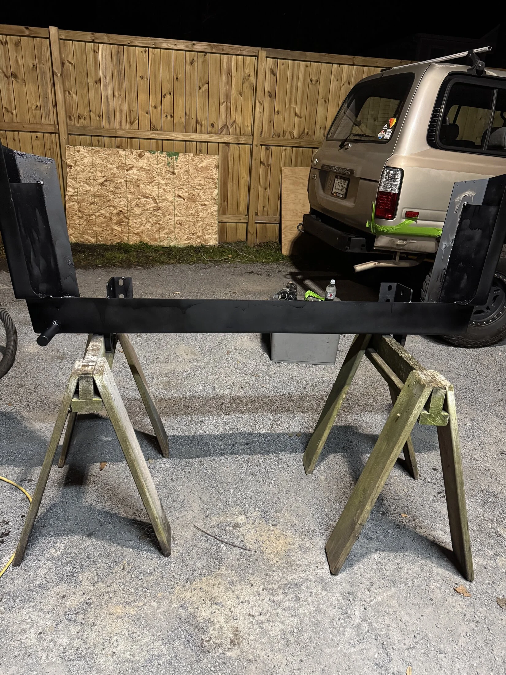

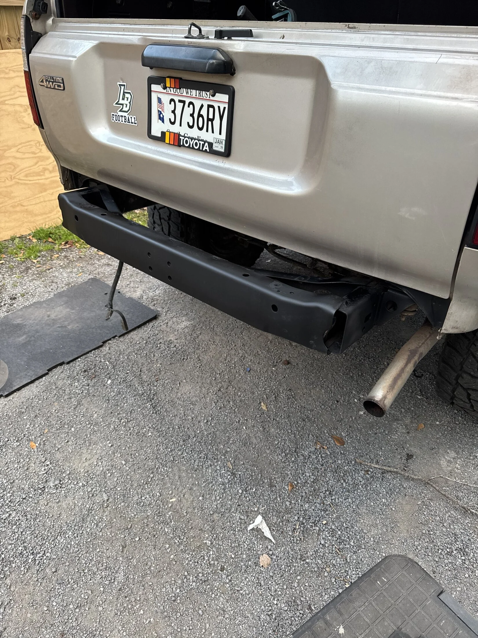

wire wheel. Cleaned up the factory cross member and hit it with rust converter and a couple coats of the professional Rustoleum. Did the same thing to the bumper after using the hydraulic press to fix a little trail bite. I like that this bumper slides over the factory cross member so I didn’t have to cut anything off the frame.(except the mounts for the factory plastic) Bolts through to the factory pintle bolts and uses the captured nuts in the frame on the side plus a through bolt on each side. All 8.8 hardware.
