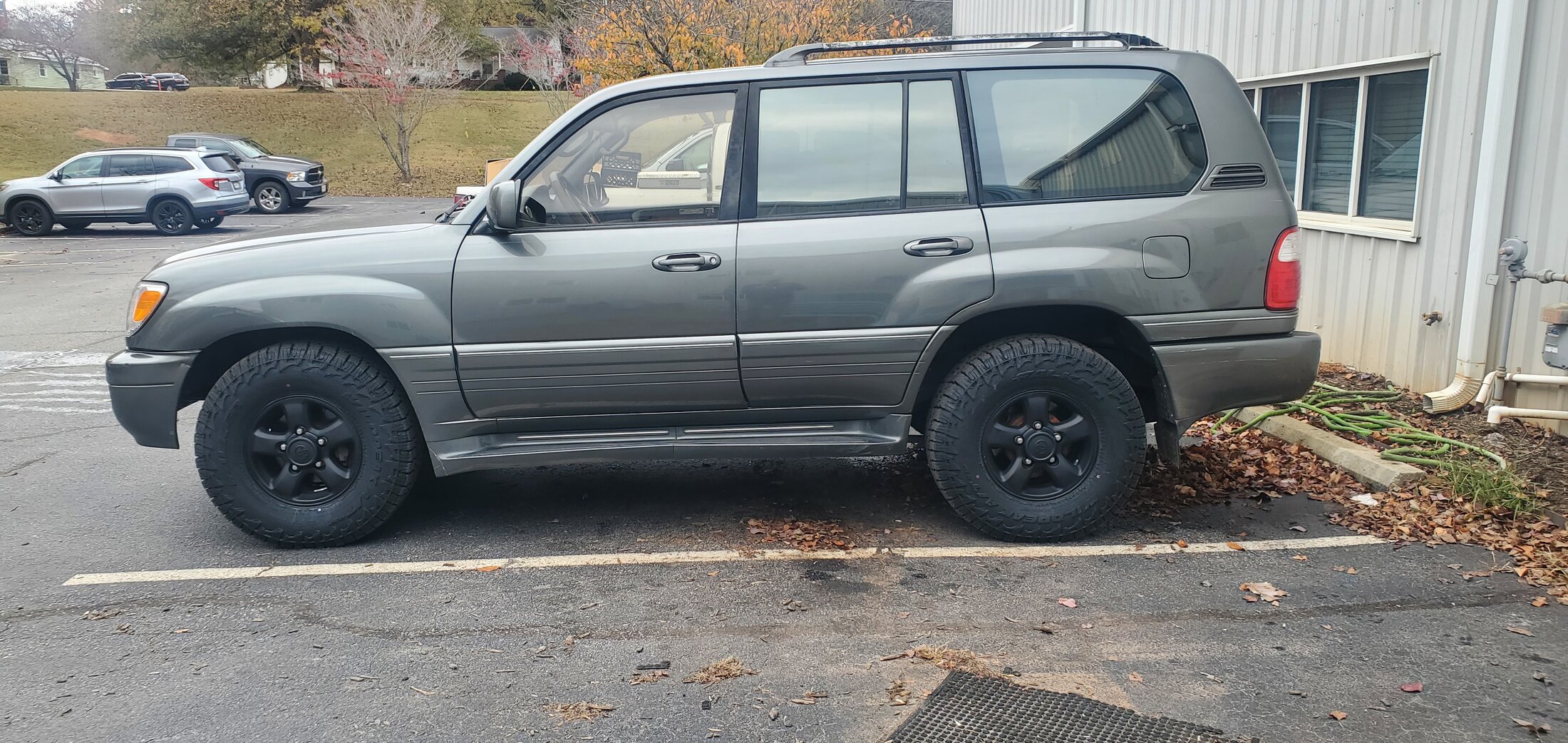

New tires and painted my old LC100 stock wheels matte black.
Removed the front hitch.

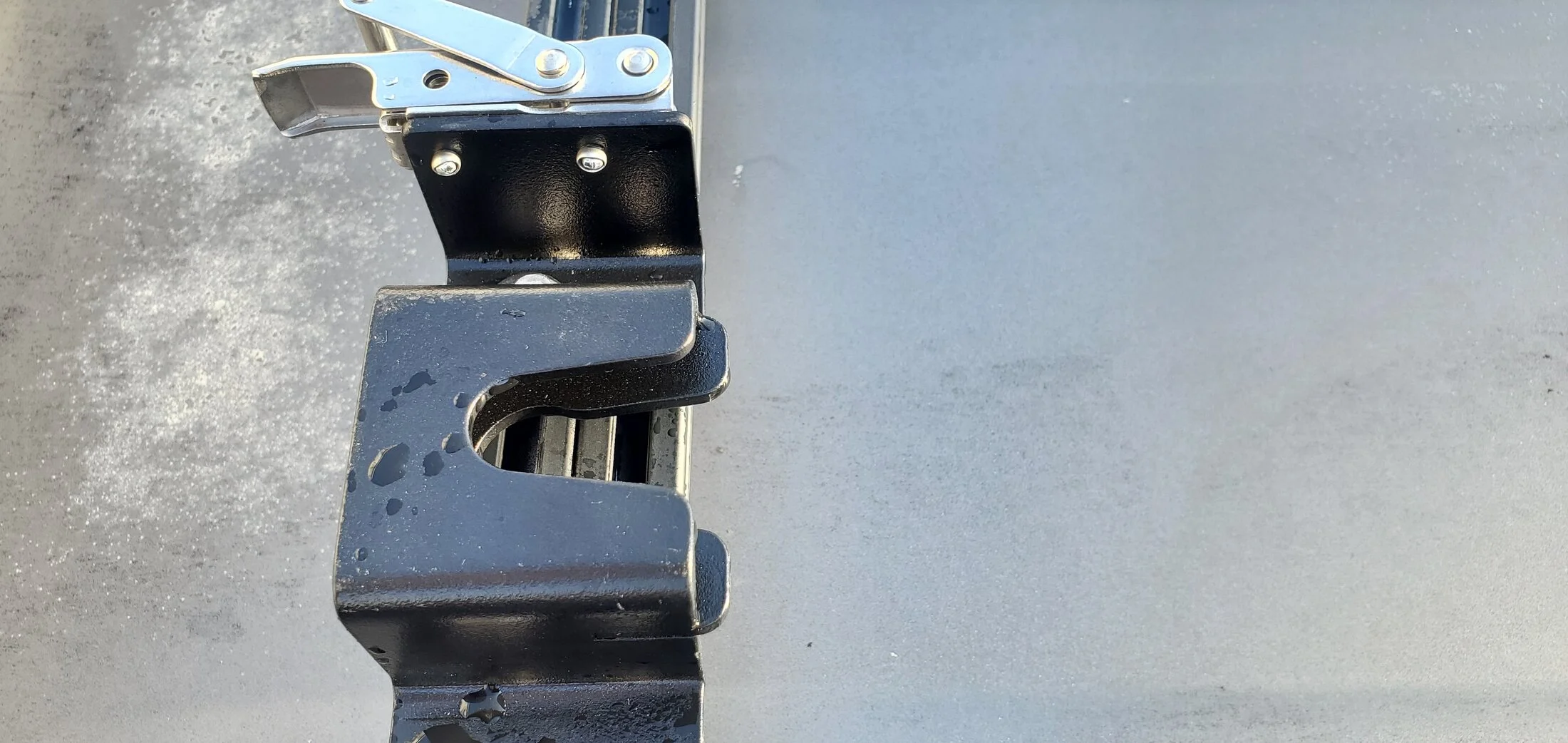

I started on the roof rack a couple of weeks ago. Here's a photo with the Gamiviti feet installed, minus the upper halves:
I know 1" square aluminum extrusion is strong enough, with enough cross bars, but I'm currently rethinking my approach. The ability to square them up is not working the way I hoped. My thoughts were to build a full rectangle with the cross bars inset to the outer frame.

I have a large RTT to install, using Front Runner Quick Release Tent Mounts. Currently have four of them. Thinking about adding two more on a 3rd 1" x 2" extrusion bar to distribute weight better.

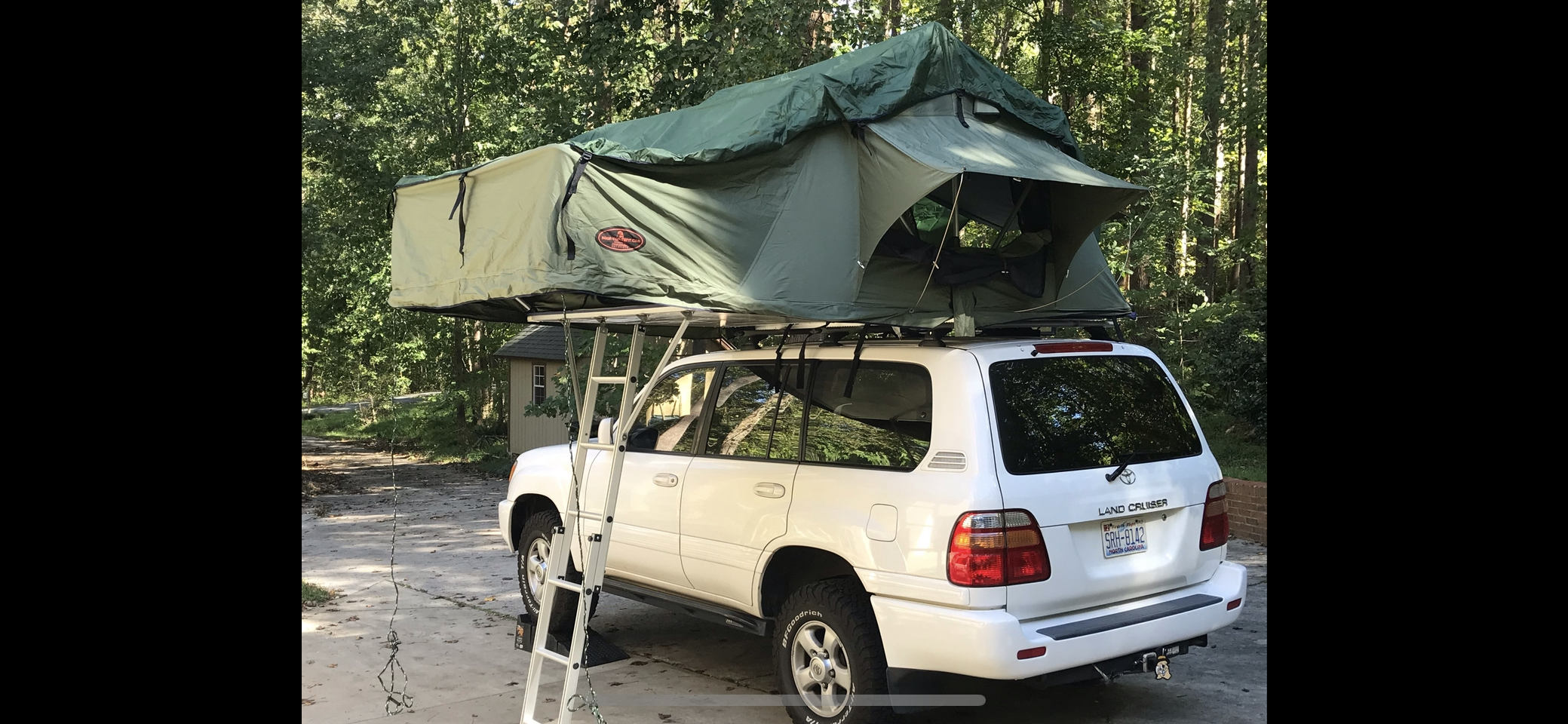

Here's a pic of the tent on the previous owner's LC:
