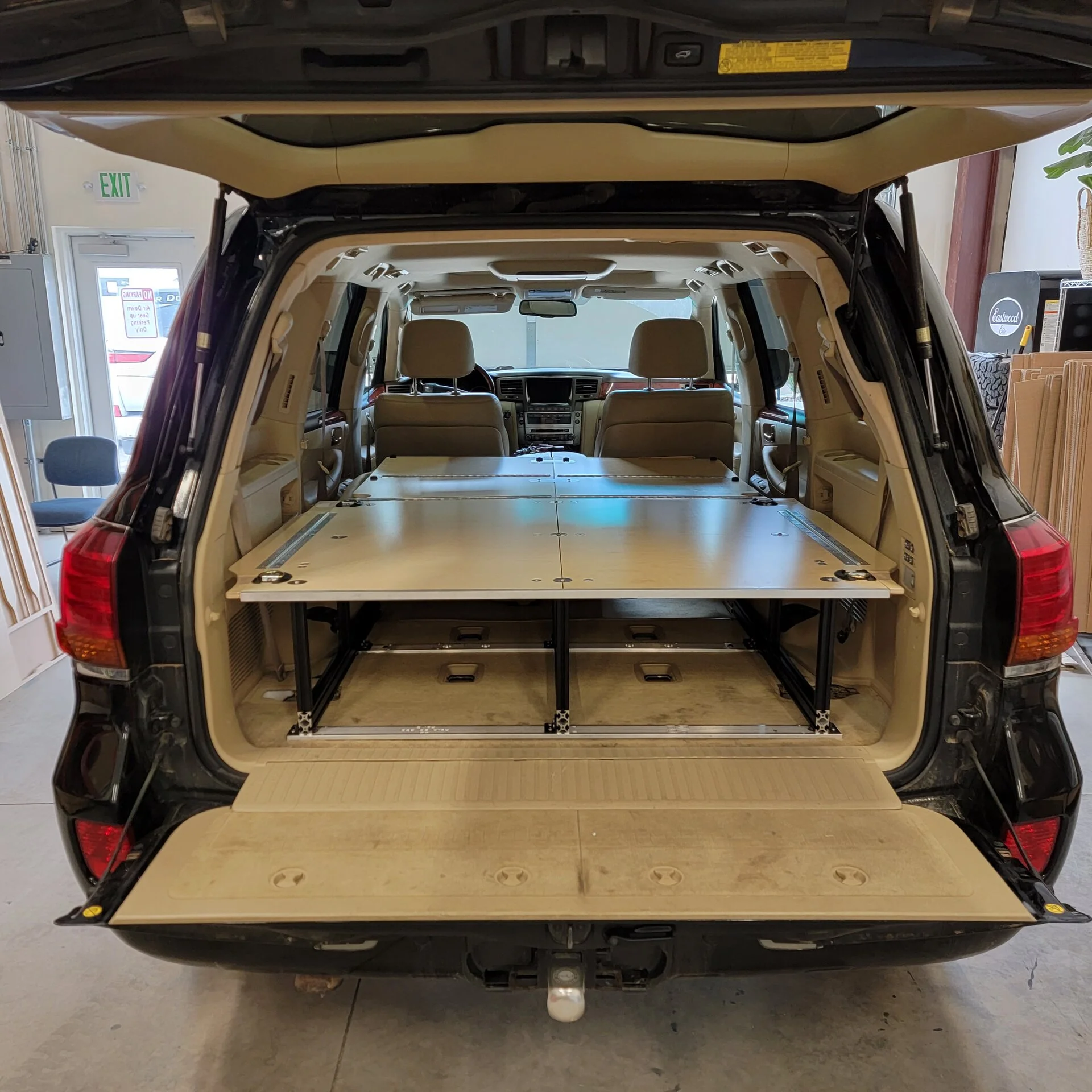

Many builds had them before goose gear. Here is mine from 2010-2011
Nice…

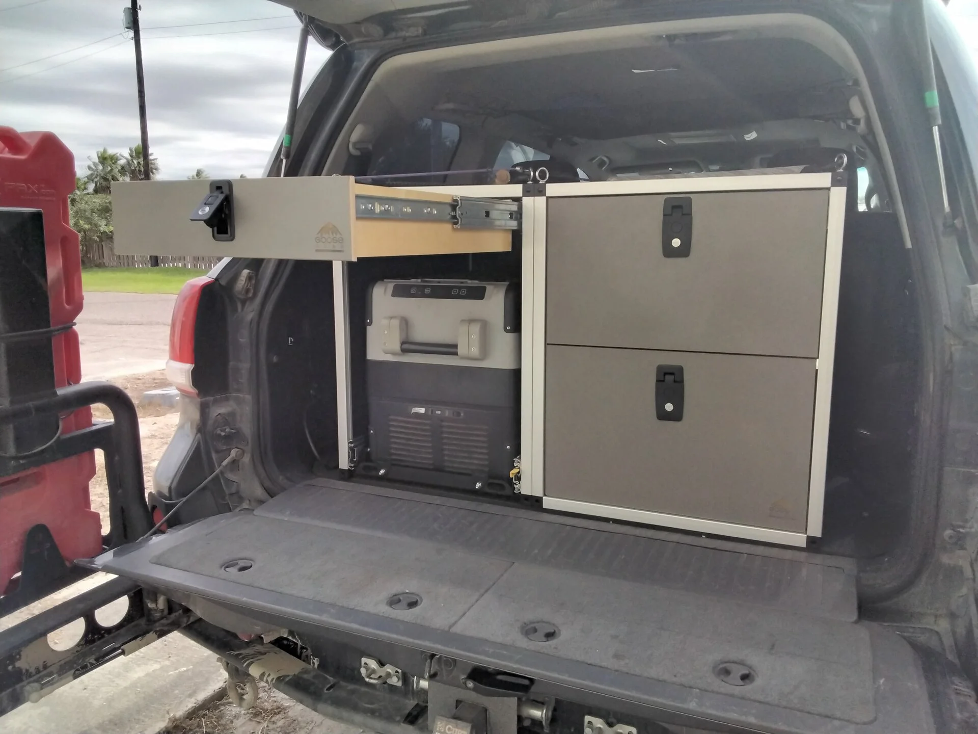

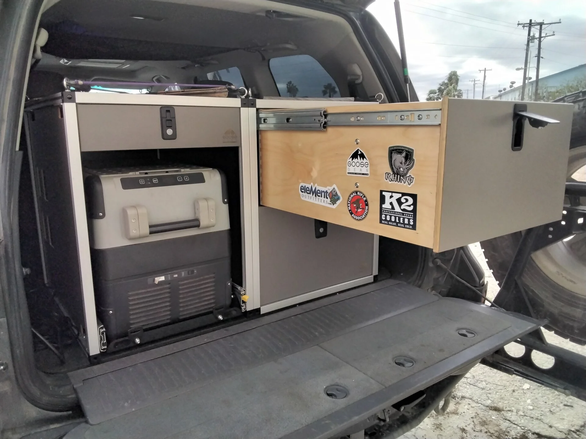

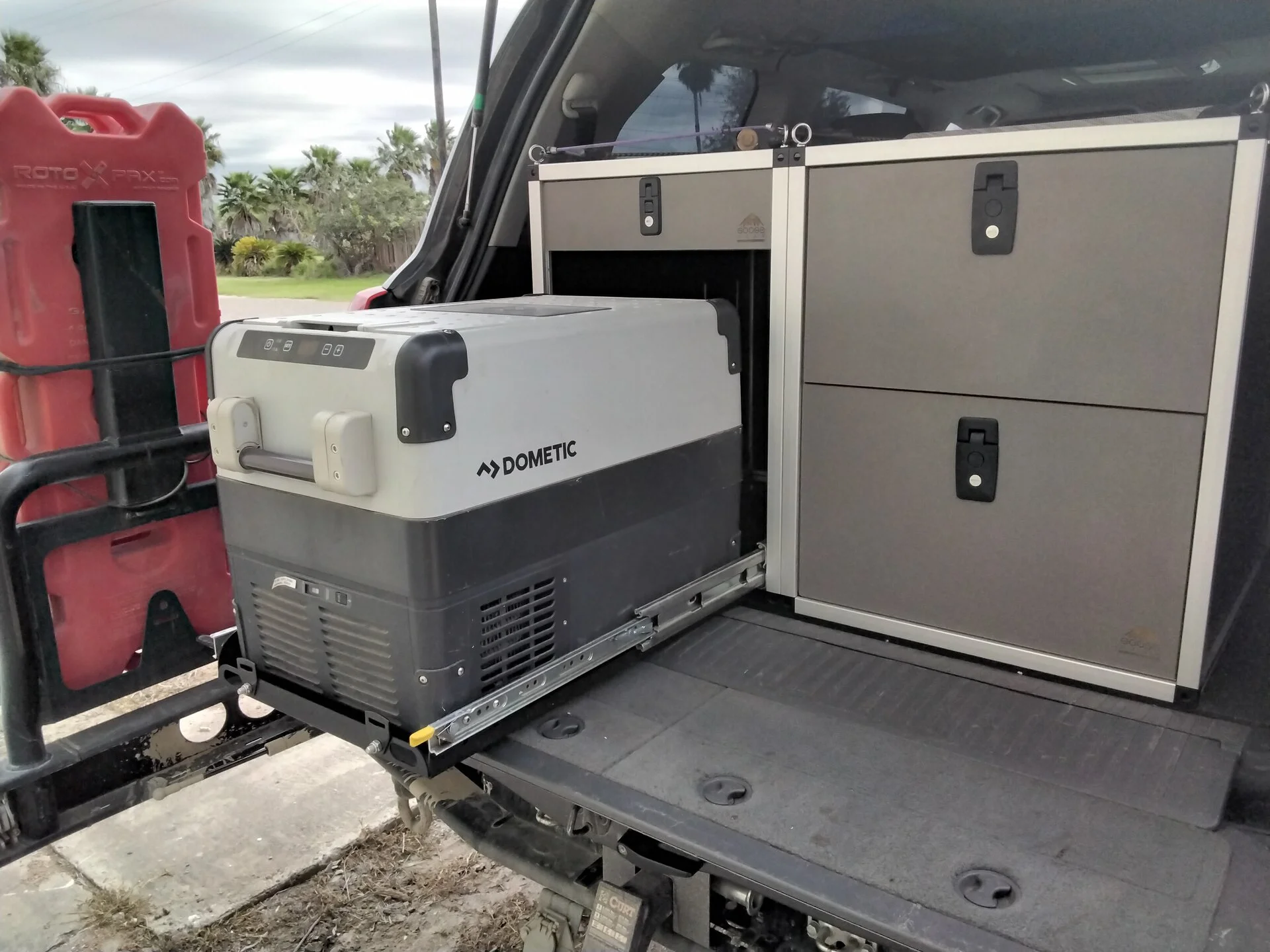

There's been some conversation here about anchoring with the M6 holes from the cargo D-rings, so we wanted to share our 2 cents in regards to the Air Down Gear Up anchoring. In order to keep a common anchoring system between the 3rd row Landcruiser and Heritage Editions (and evidently non-US 2-row variants!), we attach into the threaded M6 holes of the D-rings which are in a preferrable location along the side rails of the system where loads tend to be high. Our system utilizes a full Aluminum frame, all the way from the attachment points up! We use a metal standoff between the vehicle's sheet meal and our solid aluminum 'anchor bar', which the system then mounts to. This allows the system to be hard-mounted to the vehicle and 'floated' above the carpet,which allows preservation of the jute padding and carpeting; preserving their noise reducing characteristics. This also results in 0% modification to the vehicle.
We have put these systems through some serious torture testing - including the Dempster highway in a 200 specifically - and have found this to be a very robust solution. While we can't offer any experience mounting a piece of plywood directly to the floor, our metal-on-metal-on-metal approach has proven plenty robust on those M6 cargo points.

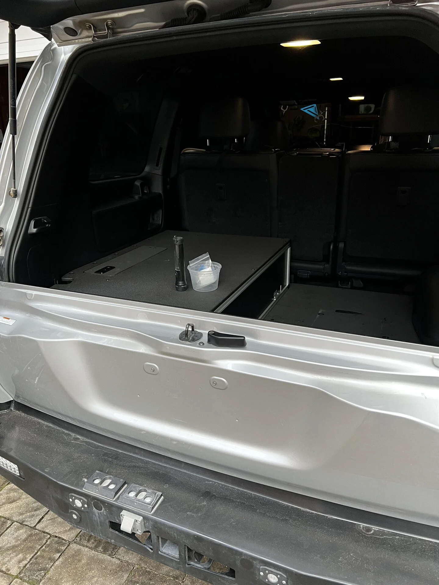

Just to follow up with my install in case anybody following is contemplating installing a goose gear system.
See my posts above for my installation of the base-plate into my 2021 Heritage where I used the plate to find the two hidden, threaded holes to further secure the plate to my vehicle - as well as using the 4 tie-down bolts.
After the plate was installed, installing the drawer is pretty quick work. It took me about an hour.
It would have been quicker but I first tried to install it without removing the top of the drawer as I had seen in some non-Land Cruiser install videos. But there is no way to get far enough inside the drawer opening to get to the far bolts to secure the drawer casing to the plate without removing the top plate.
So I had to take the top plate off, secure the frame to the base-plate and then reattach the top plate. Reattaching the top plate is a bit tricky because some of the metal clips that slide into the rails can move. But it’s doable with some perseverance.
Pictures below.
As for my overall review after driving about with the drawer in for about a month now:
I like it! No rattles and it’s great having a lockable storage compartment back there.
And it’s wonderful being a bit more organized.
I would say I could remove the drawer in about 20 min if I needed to transport something large. And then 20 min more to replace it in the LC.
I do think the design of the plate is lacking in that I can see no reason why the forward edge, the one up against the back seat, is free floating. There is a build-up of wood there, like they meant it to be support, but it’s not nearly thick enough.
So I advise adding to that support like I did in the pics above (though maybe do it in more of a professionals method than I did).
Also, I am glad I put in the dynomat under the plate. After using for some time I think it’s slightly quieter. Moreover, I think the bass has become louder or more pronounced. I’m not a big bass guy, so I had to fiddle with the bass levels some to lower them, but it’s still nice to have more bass when I want it.
