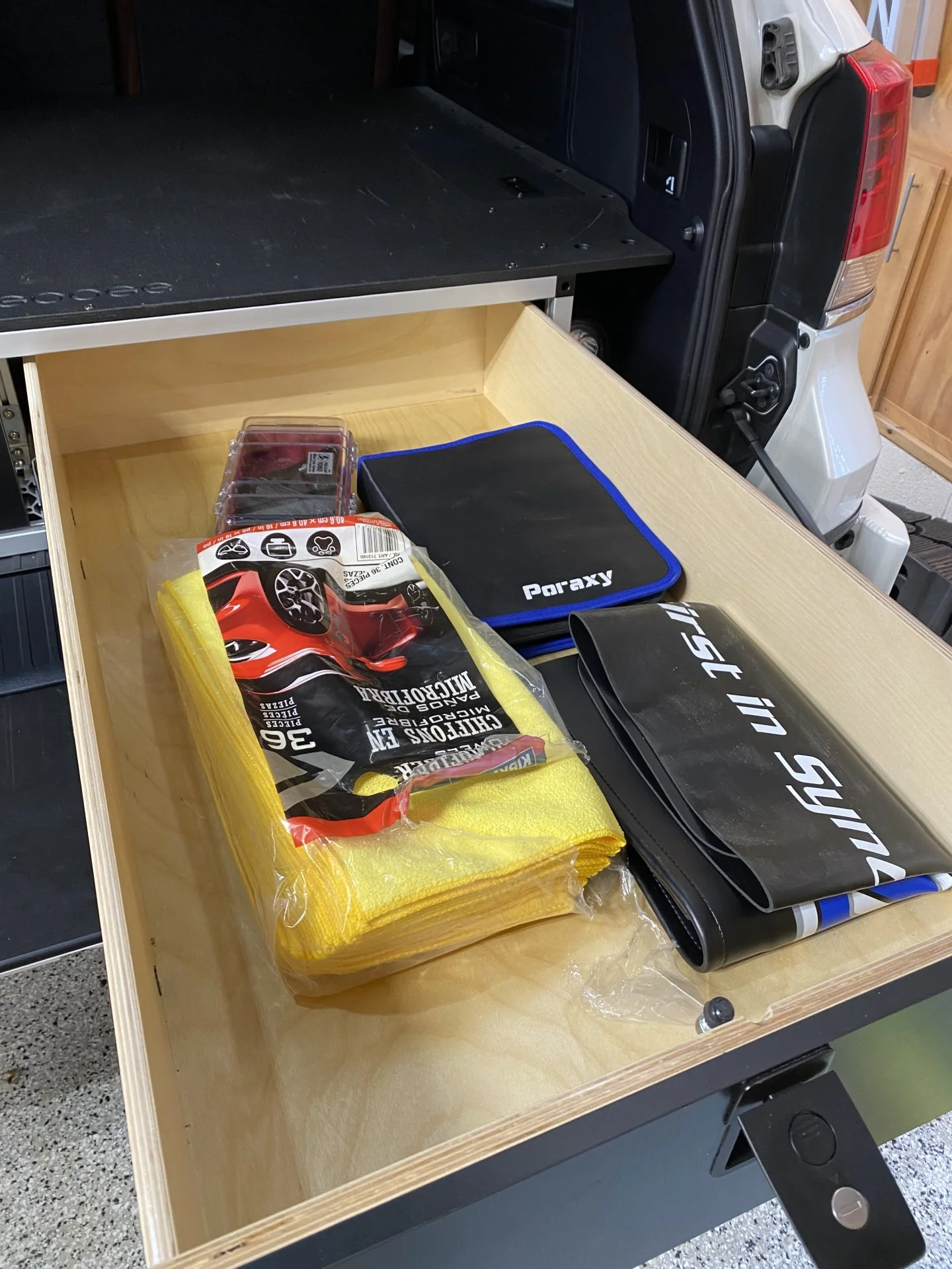

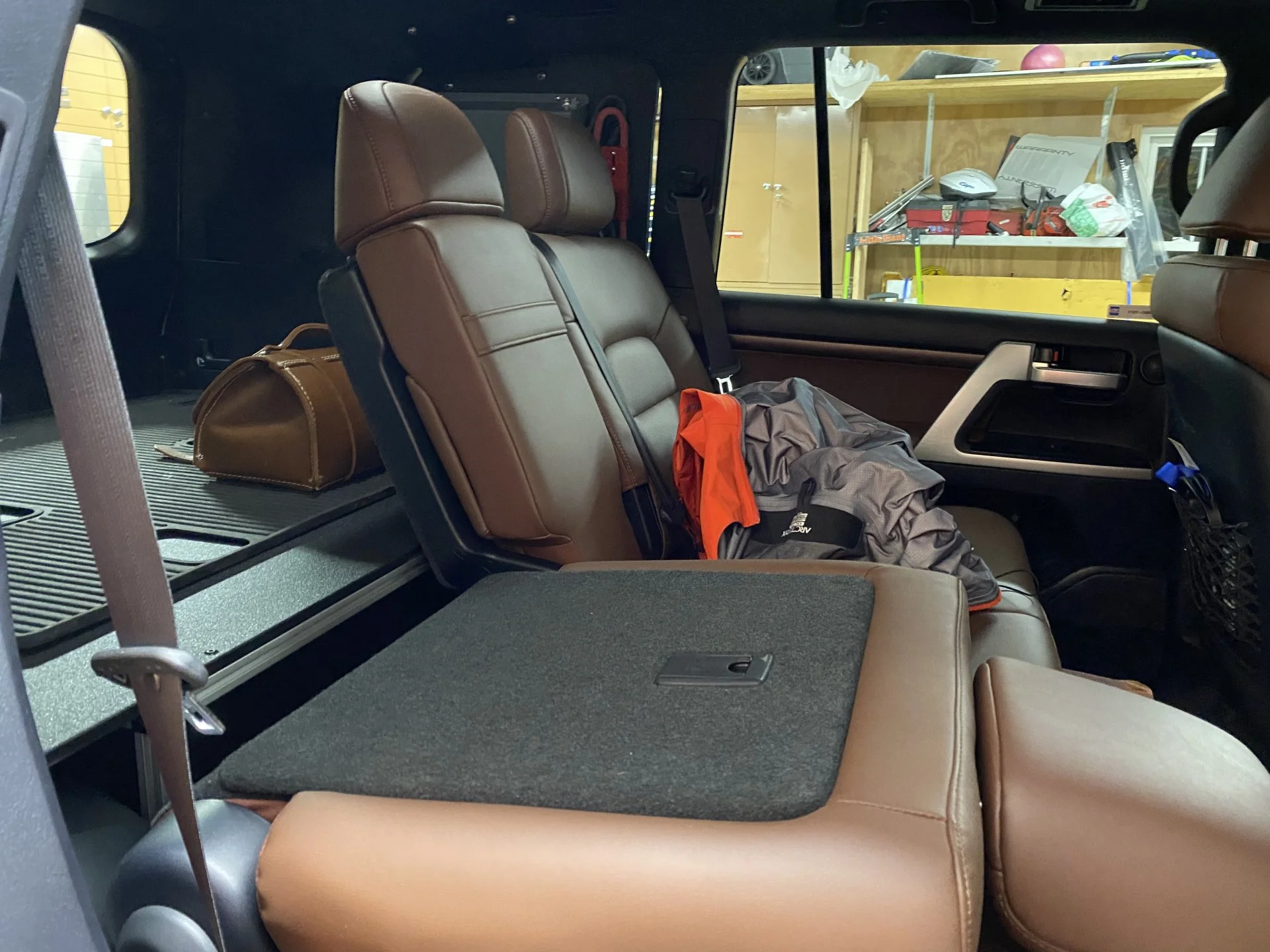

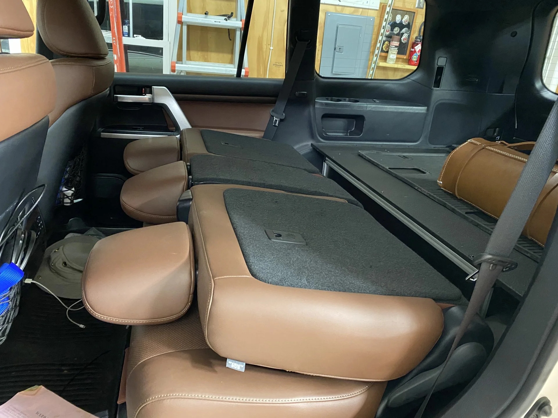

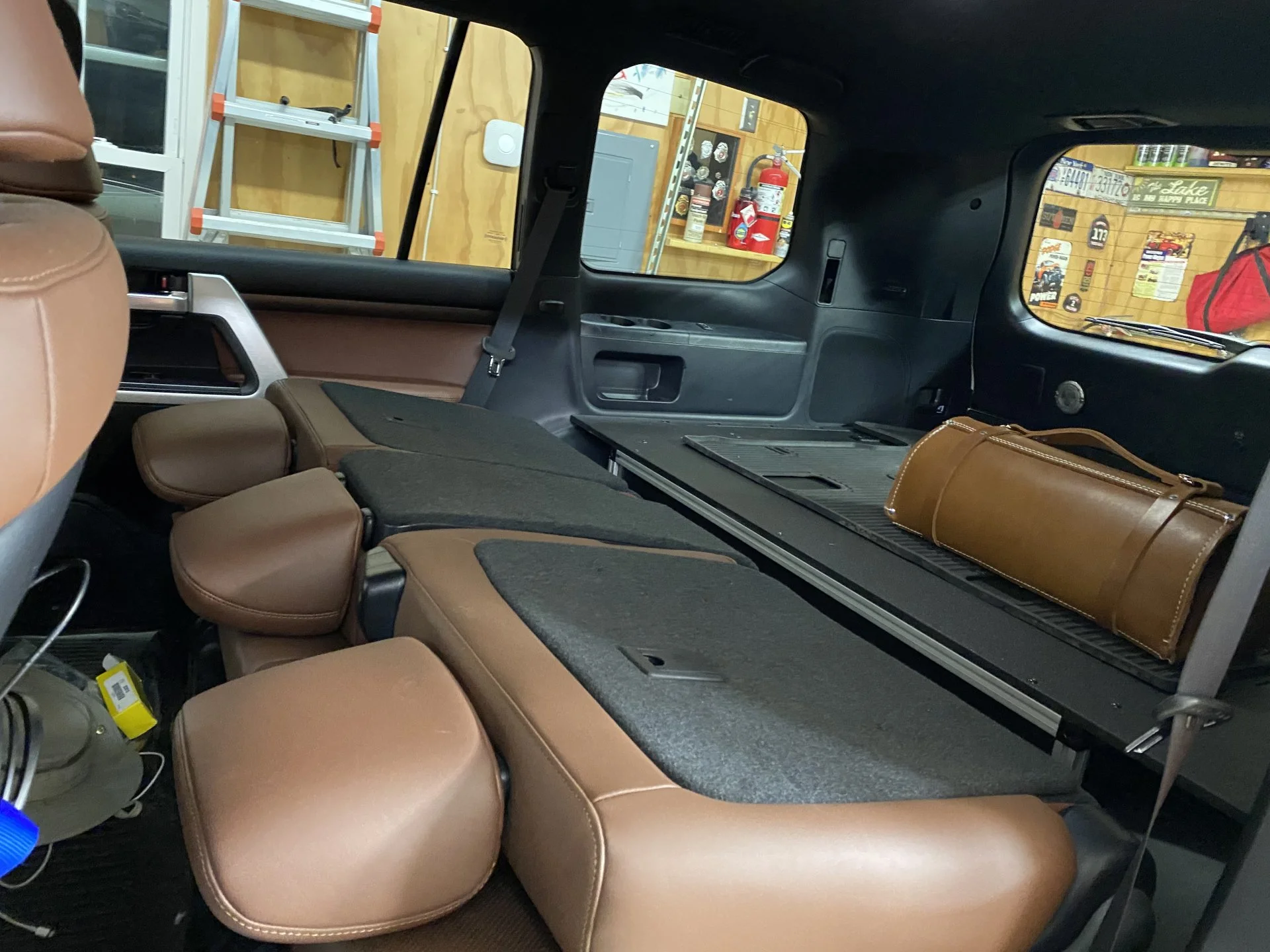

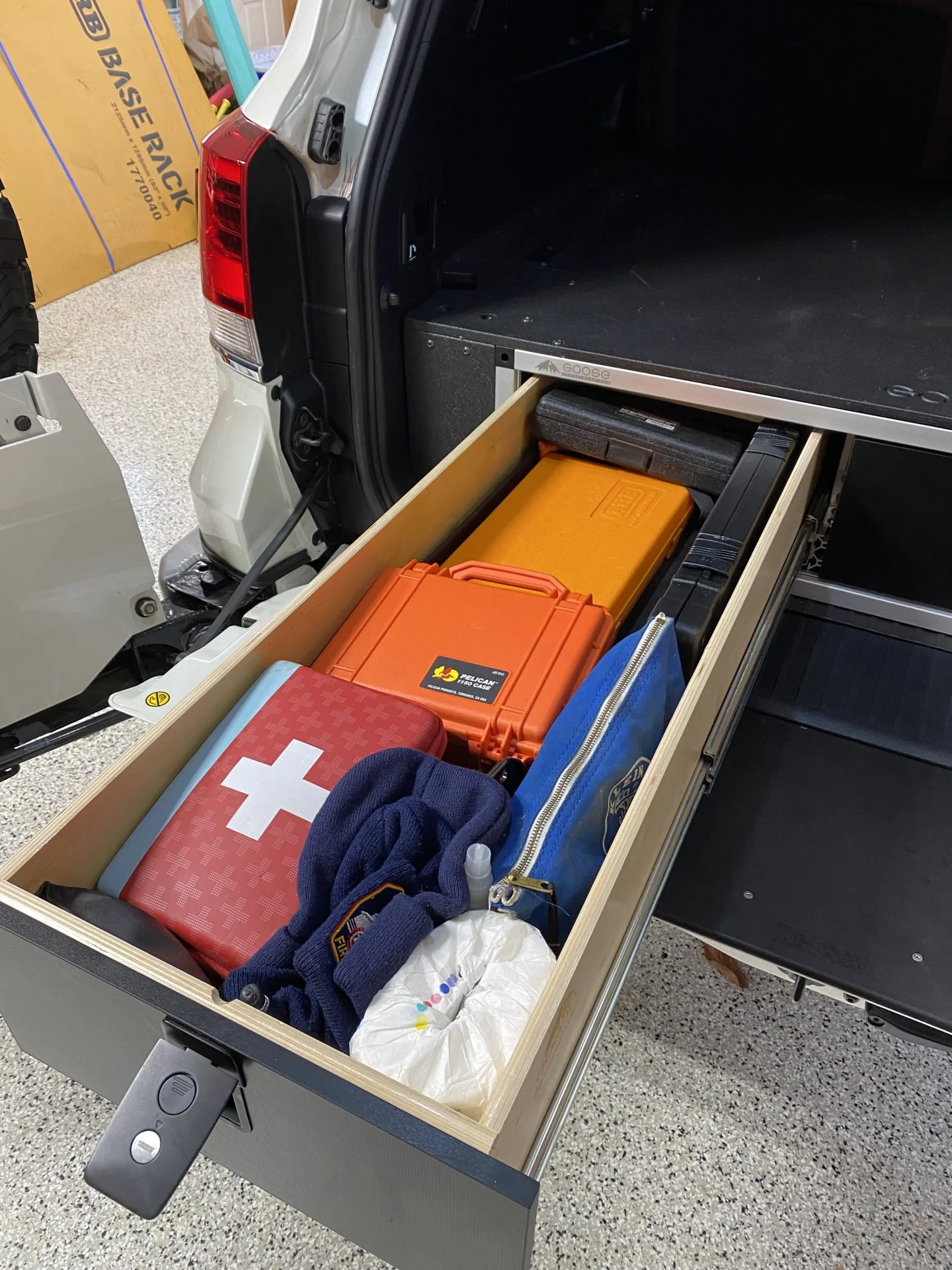

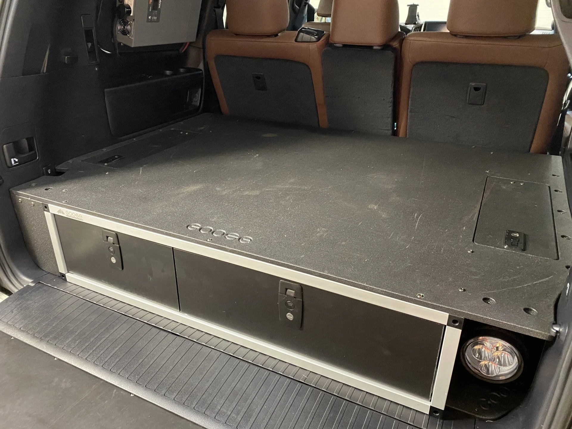

I have it. I will upload some photos tomorrow. The floor plate fits perfectly. It is confirmed wood, coated on one side. Uses oem bolt points, so no drilling. I added the full dual drawer system with a 1/3 2/3 40” deep drawers. Provides cubby storage behind the wheel arch. Tip, remove your jacks and put it in the drawer. It’s darn difficult to get it out otherwise.

Looks really good. How do you like it so far?
I like the quality and fit. The only down side and it’s specific to me, is when I go to my cabin and have to bring a trash can to the transfer station, it won’t fit standing up. So the mini van gets trash duty. I also was driven nuts by the clinking of the lock cylinders in the handles. A little silicone on the back and it stopped the rattle. 40” drawers hood a bunch of kit.
Is there a GG plate underneath the drawers?
Yes. That is the required base. I had carpet removed and dynamat installed for noise reduction under the plate. The plate uses existing threaded body holes.
Ah, I see it now, by the second row. Any photos of the base plate going in, before the drawers are in place?
