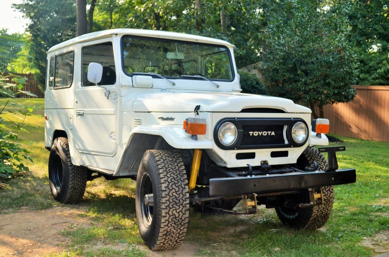

Jeff and I washed the truck this afternoon. I took a few pictures with Kristin's fancy camera. She's coming over tomorrow night and we'll see if we can make them meet the specs that Todd wants for the ad. I have to get the pics to him by Saturday.

This is the pic I took for the Trails and online website ads....

I don't have any of those things. But the picture looks GREAT!
Good job Sourbeer!
