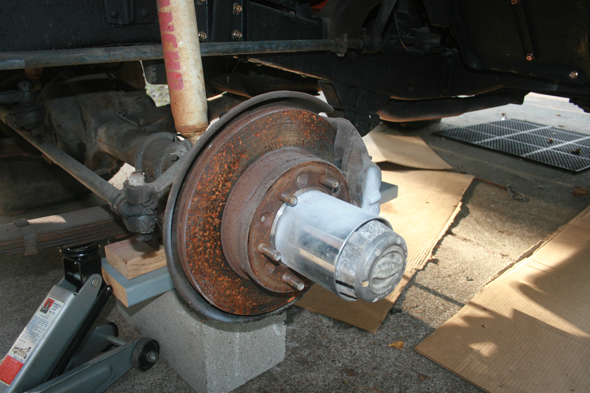

Rotars, still some good metal there

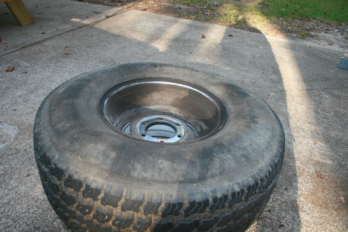

My current Tire/Wheel combo

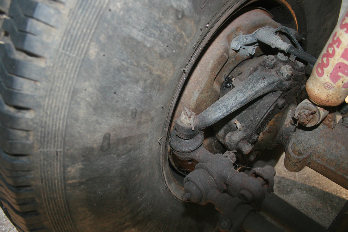

Not much room, this needs to be fixed
Funny, I just went through buying a set of new wheels and tires a while back. I thought that I found more options for tires with the 15 inch wheel. :meh:
I could be wrong, but the main reason for going to 16 would be that touching of the steering arms and wheel, unless ya'll thick that the backspacing can solve the problem..??
Should be fixed with appropriate backspacing. A 1/4" spacer might work too, but depending on rims it could require longer wheel studs.
Looks like if you backspace another 1/4 inch or so, you will clear your arm and boot. I have a spacer, but will replace that with a backspaced wheel when I have a little cash...
okay, so I'm assuming that Discount will be able to look at the pictures I tool and measure the current BS and know what to do? Am I adding "more" backspacing or reducing backspacing by a 1/4"?

Increasing diameter doesn't necessarily mean it'll clear your TRE. I have seen wheels that have enough of a bump of some sort on the inside of the wheel that still hit. I think you have a backspacing problem, more than a diameter problem.
16" wheels tend to have better load ratings (rather, 16" tires usually are rated a full grade more than 15" tires), but I doubt you can haul a ton of stuff in your 40 anyway--it's just not that big.
Search, but IIRC the factory wheel had 3.5" backspacing.

I don't mind ordering off line, I just don't know what the correct BS should be, the video shows the BS I measured. What I need to know is am I adding more backspace or reducing it? In otherwards, is the 4.25" I measured suppose to get larger or smaller?
