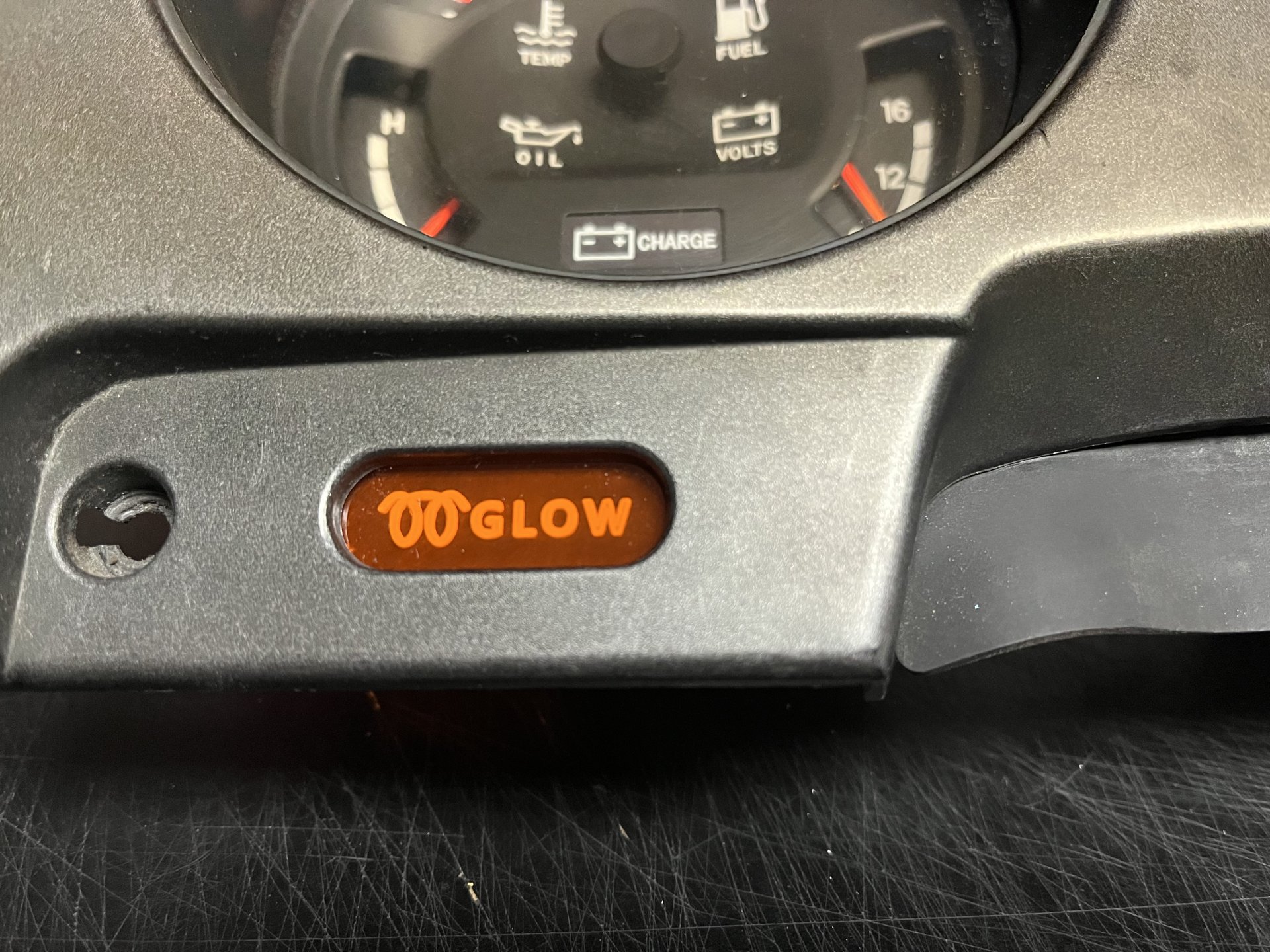

Just wanted to show you guys what I've done to have an OEM style glow indicator on my dash for my diesel swap.
After finishing all the mechanical work, I had to wire up the sensors and accessories on the
engine to make it all work.
I figured I'm not going to need the CEL indicator for an all mechanical diesel engine ( no ECU ) so I've made a factory style box with an amber lens and engraved the glow symbol in it.
After installing it I didn't like that the 4WD indicator wasn't matching the new glow indicator
so I made a new one.
Let me know if you guys have any questions about these indicators or the wiring for the glow plug relay and the indicator.

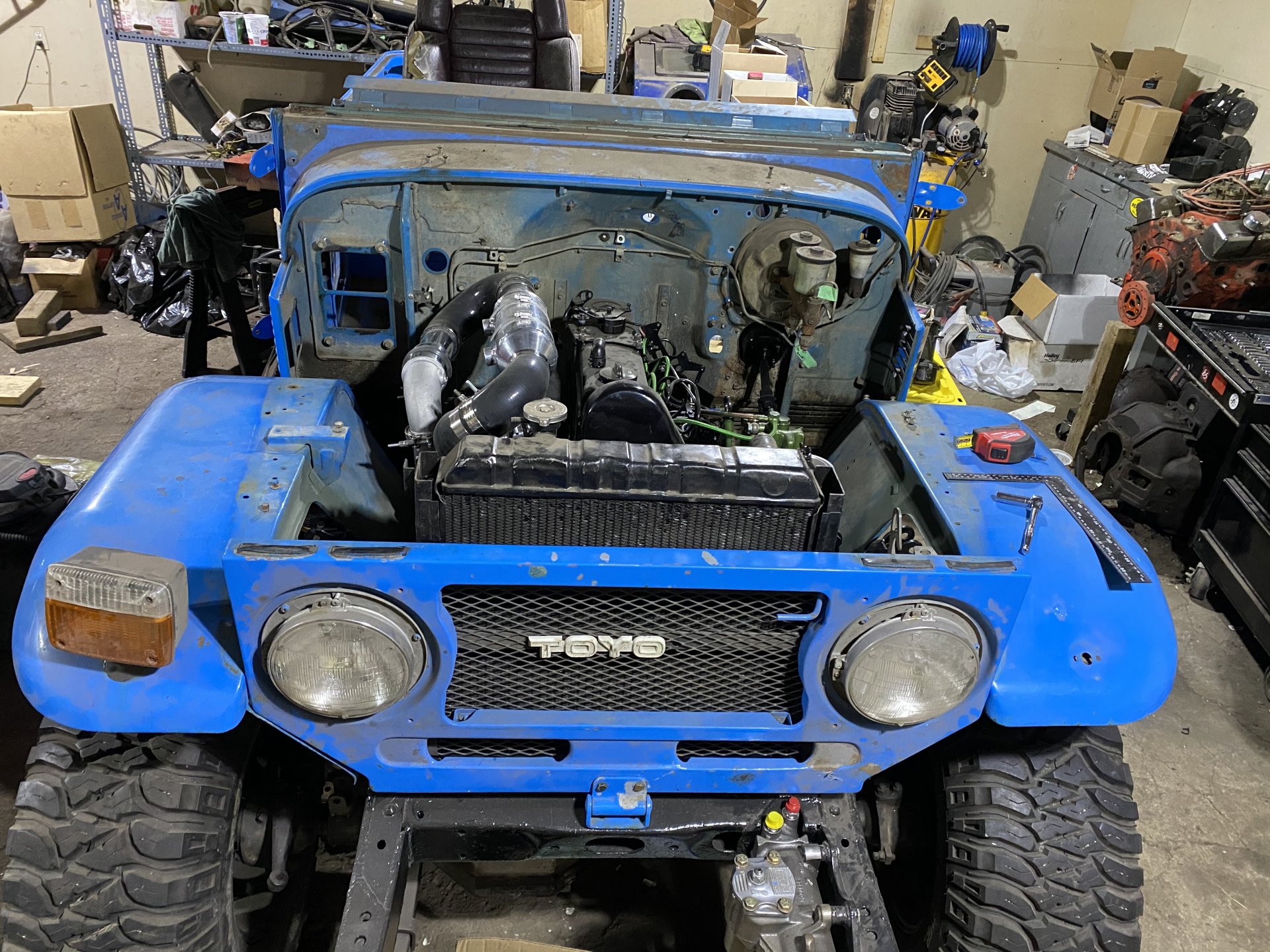

@LA Z i believe has an OM606 there. mine is an OM617 in my 40. it’s not running yet so i don’t know. i have a dieselmenken pump and holset hx30 so it should make more power than stock by about 30%. that’ll of course drop mileage. i drove the car it came out of which is 700ish pounds heavier than the cruiser and could get 30-35mpg with five full size adults in it. i’m hoping with the plywood like aerodynamics and larger tires it’ll get low to mid 20s. still better than the 14 i was getting with stock engine before it seized.
i’ve heard the OM606 is better suited to the bigger 60 series. mine i think would be a little under powered (stock anyway)

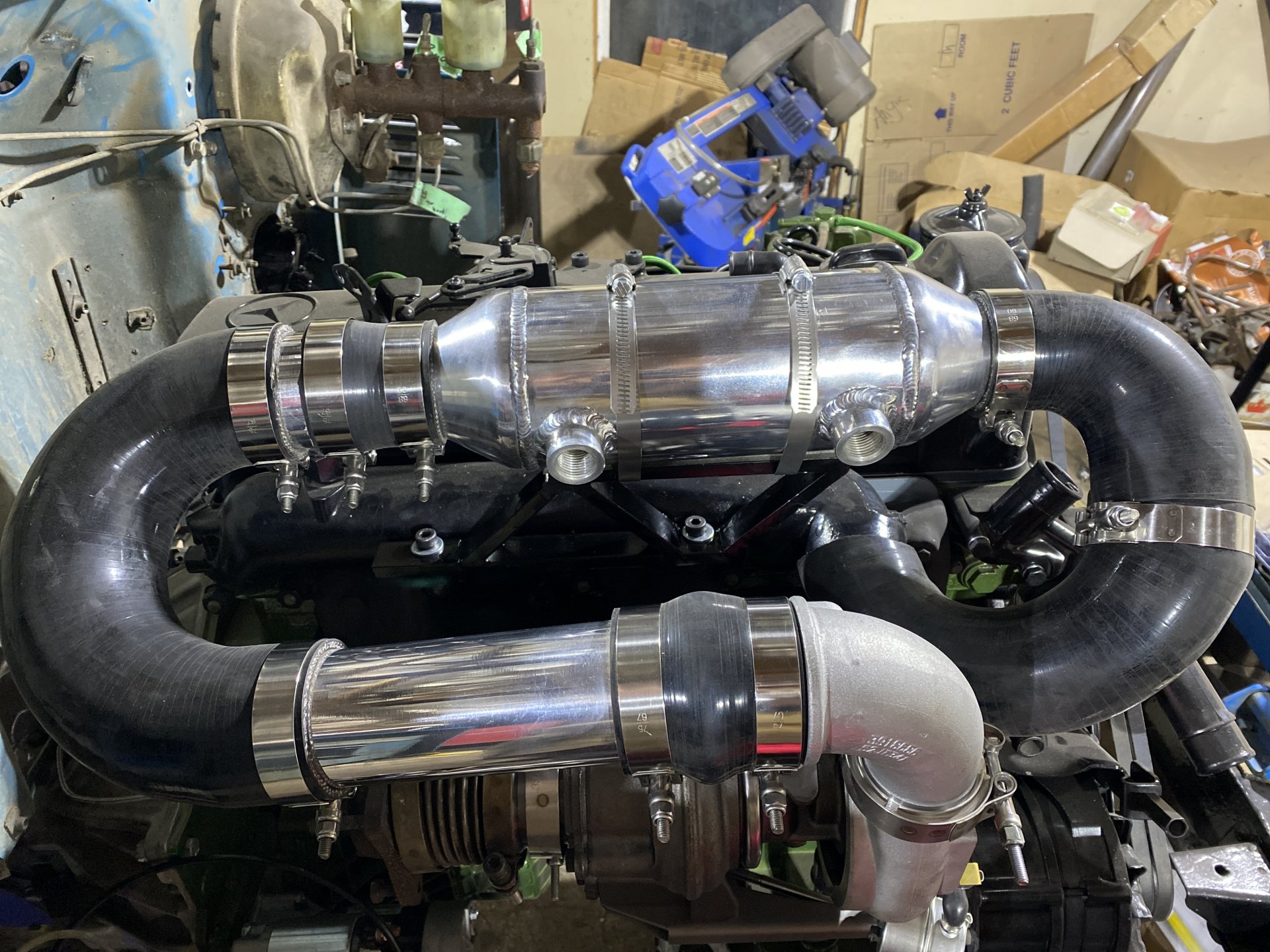

i’ve gone that route too! this is the other diesel project i mentioned to you i’m working on. View attachment 3113821
I've got an OM617 in my 40 also. It's a really nice engine for the 40s.
I like your inter cooler setup.
thanks. i don’t have room up front for an air to air intercooler so went with the air water set up. fits pretty well. still have to makes some space for the heat exchanger and hopefully an air conditioning heat exchange. it’s been on hold while i built a new house. hope to get working on it again this winter.

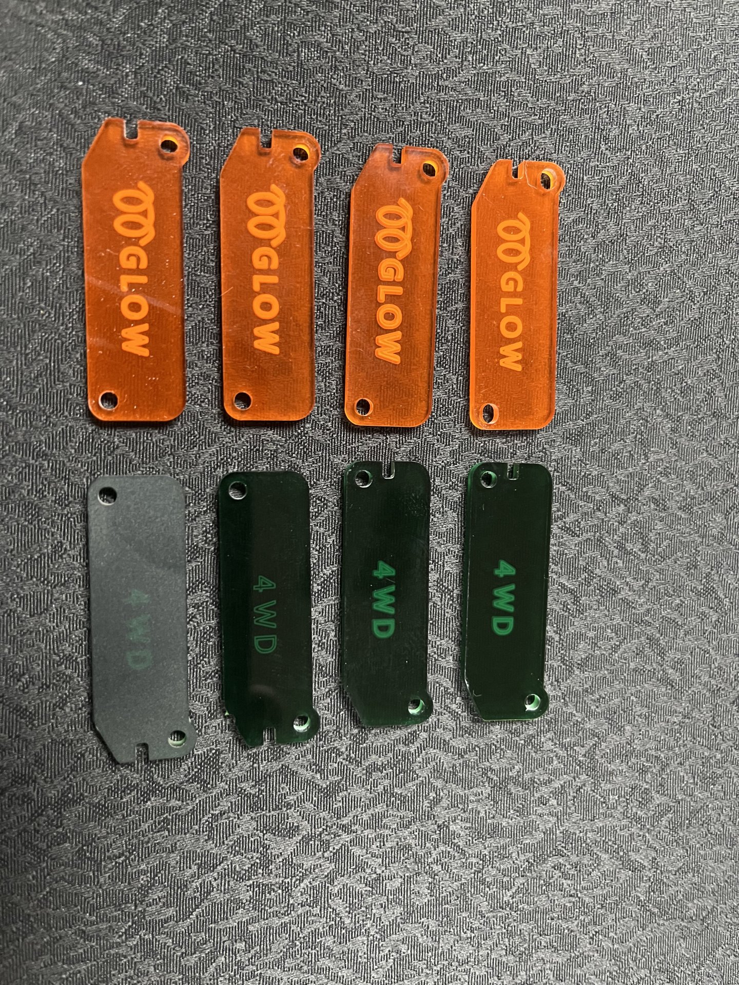

I've made some replacement lenses for the 60s cluster, that would replace the CHOKE indicator
with the one for GLOW.
And of course the 4WD
I got a couple extra lenses up for grabs
I did sandblast one of the 4WD lens to see how it would come out,
just wanted to match the OEM lens satin finish.
