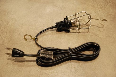

Mine work too, and there is a 2 pin source for a Toyota lamp.
