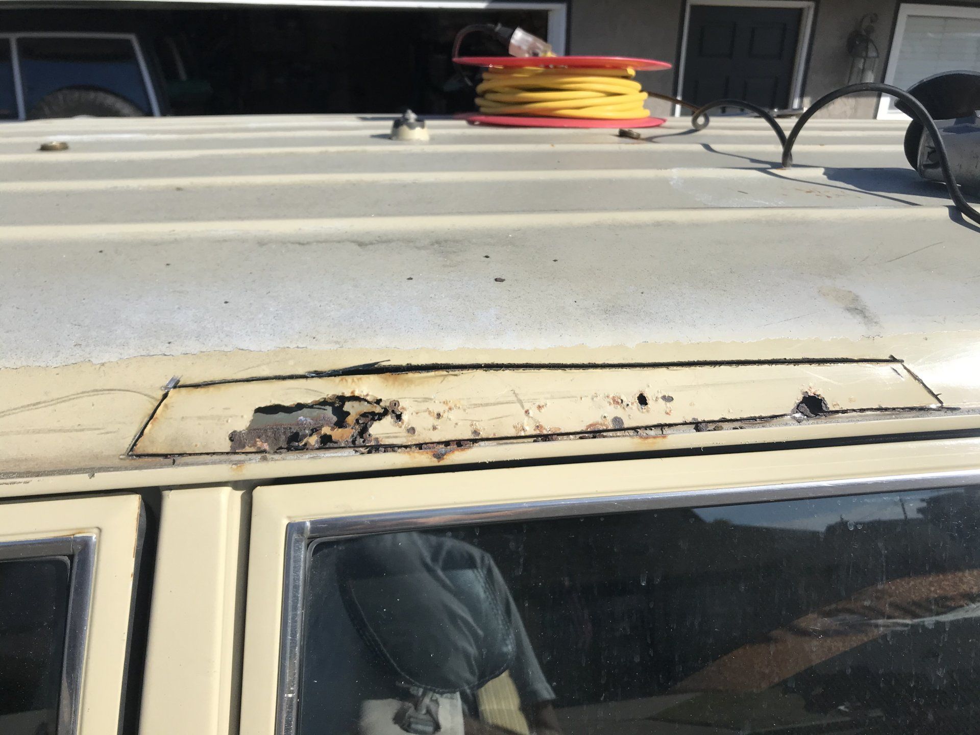

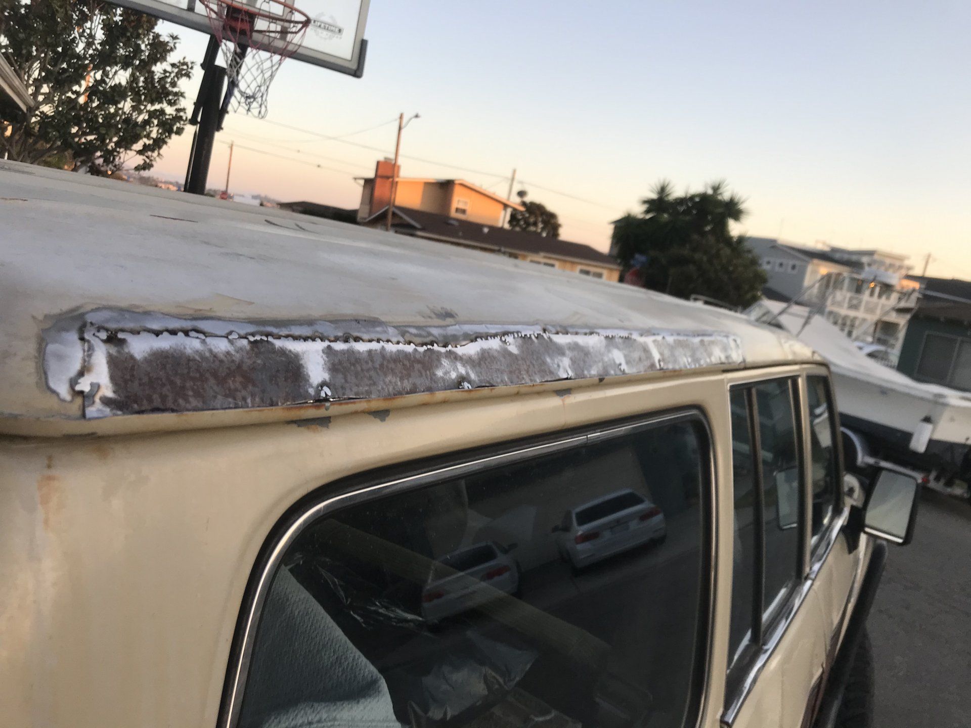

Looking good! I’m in the same boat and learning as I go tackling 60 roof rust.. it’s actually fun to make patch pieces. Keep up the good work!!!View attachment 2506715View attachment 2506716View attachment 2506717
You are doing the stuff I did on the previous project...well the project that is still in my shop. Those areas on the roof can be a real bitch, since there is actually a very slight curve in the piece in that area. If you are ever feeling bad about the rust on your rig, read this, and know that it can be so SOOO much worse. In fact looking back at some of the pictures I question my own sanity.

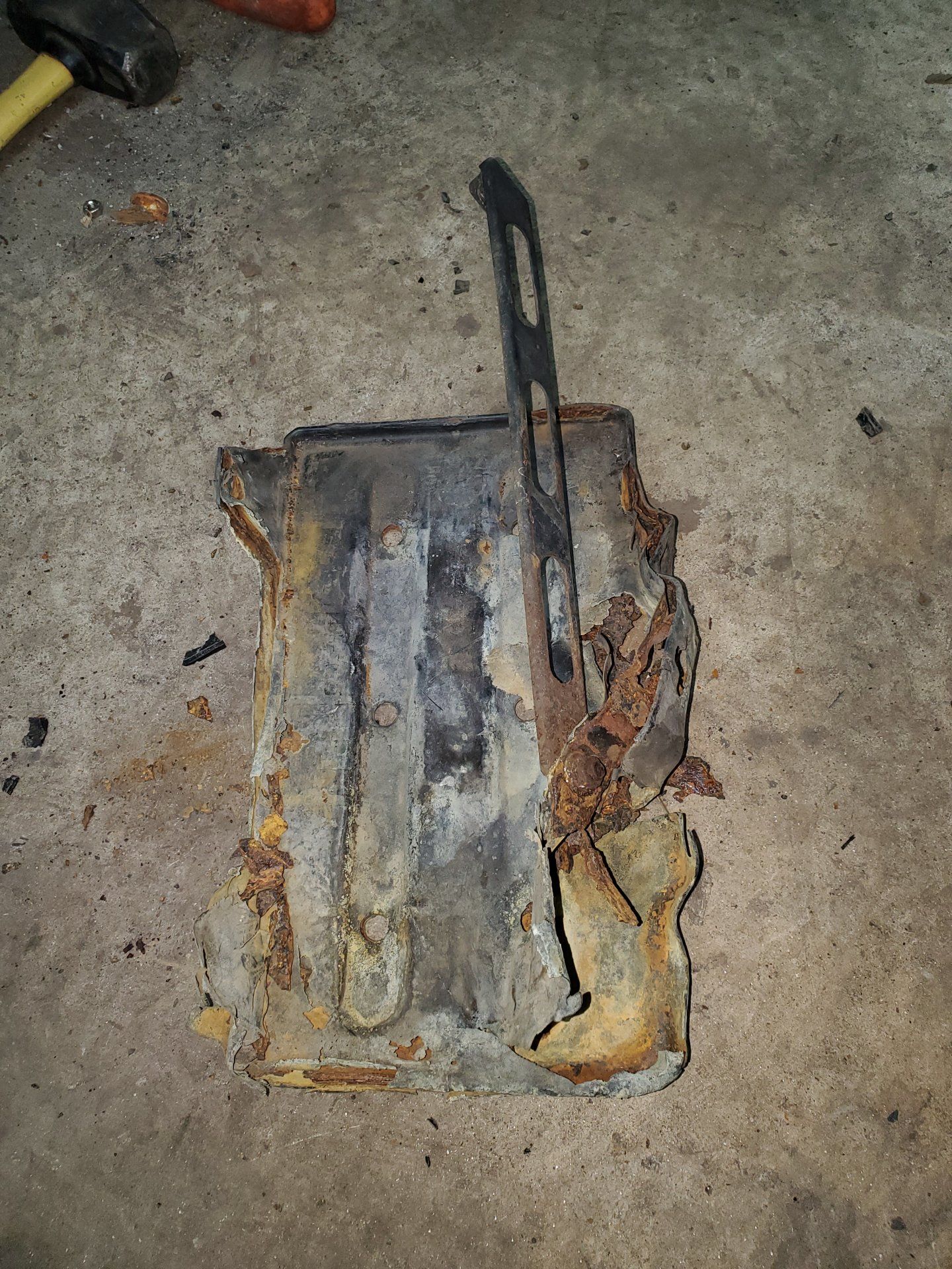

So I was looking at the battery and noticed the tray was a little crusty, and upon further inspection and removal I am considering replacing the battery tray. I hope I'm not being too hasty.
It appears a battery vomited and no one neutralized the acid and it did its thing
Luckily I have a good inner fender I can swap out, but it occured to me that now might be a good time to prep for a dual battery setup. I did a quick search and didn't see any dual battery trays for the 60 series. Would this required gabbing up a dual battery tray, or what? Should I just go with a stock tray and find a spot for another battery later?

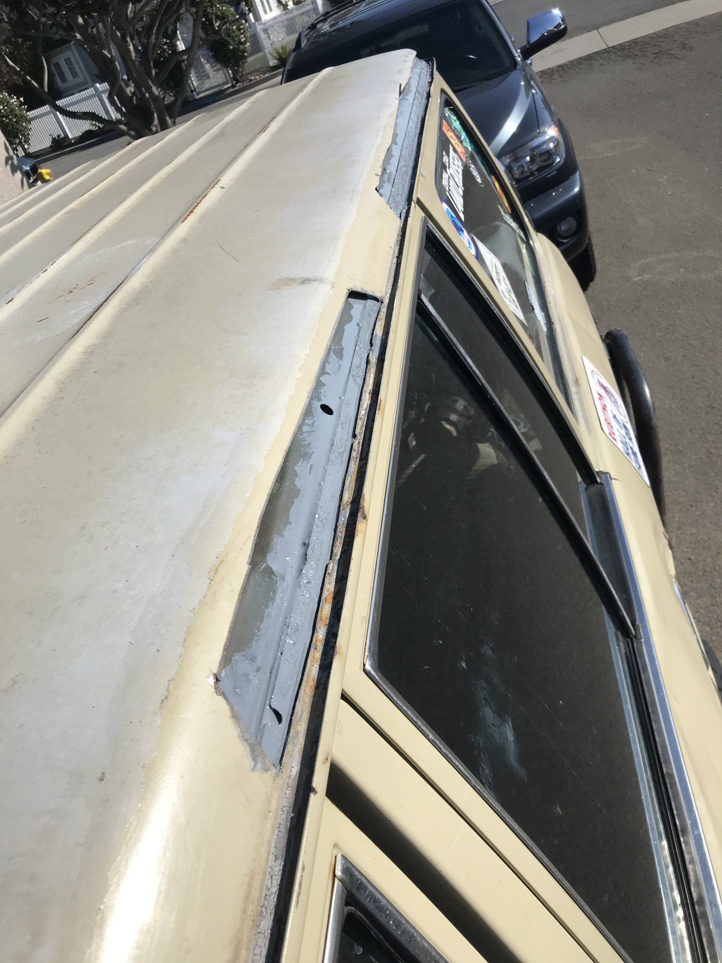

Focused on the last bit of rust I've found, under the rear quarter window gasket. I got the window out and could see that it's likely someone had the window out before and it looked like there was just red primer under gasket for the most part. Doesn't see like something the factory would have done to me. Also found a couple more spots that were starting to get a little cancer and nipped that in the bud while there.
