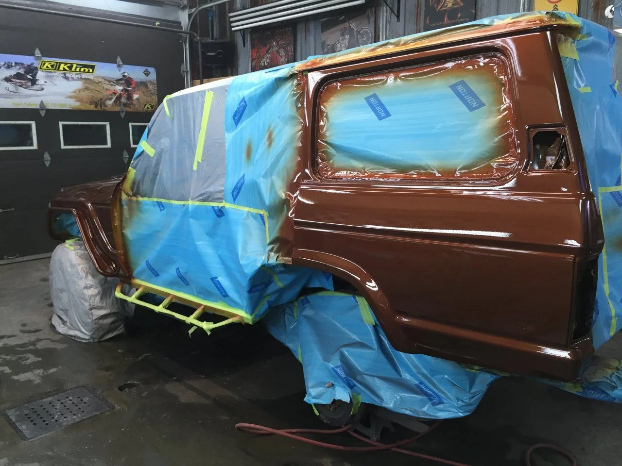

Did you pick this paint up online? If so where? Or from a physical store? Looks to be great quality
Automotive paint store, its a division or lower end product of the PPG line, but still very good.

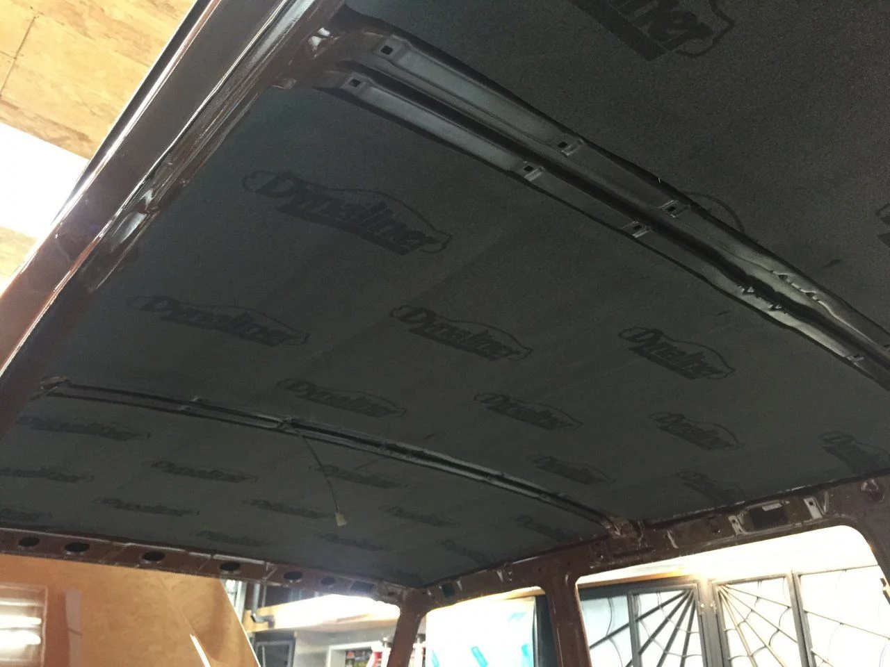

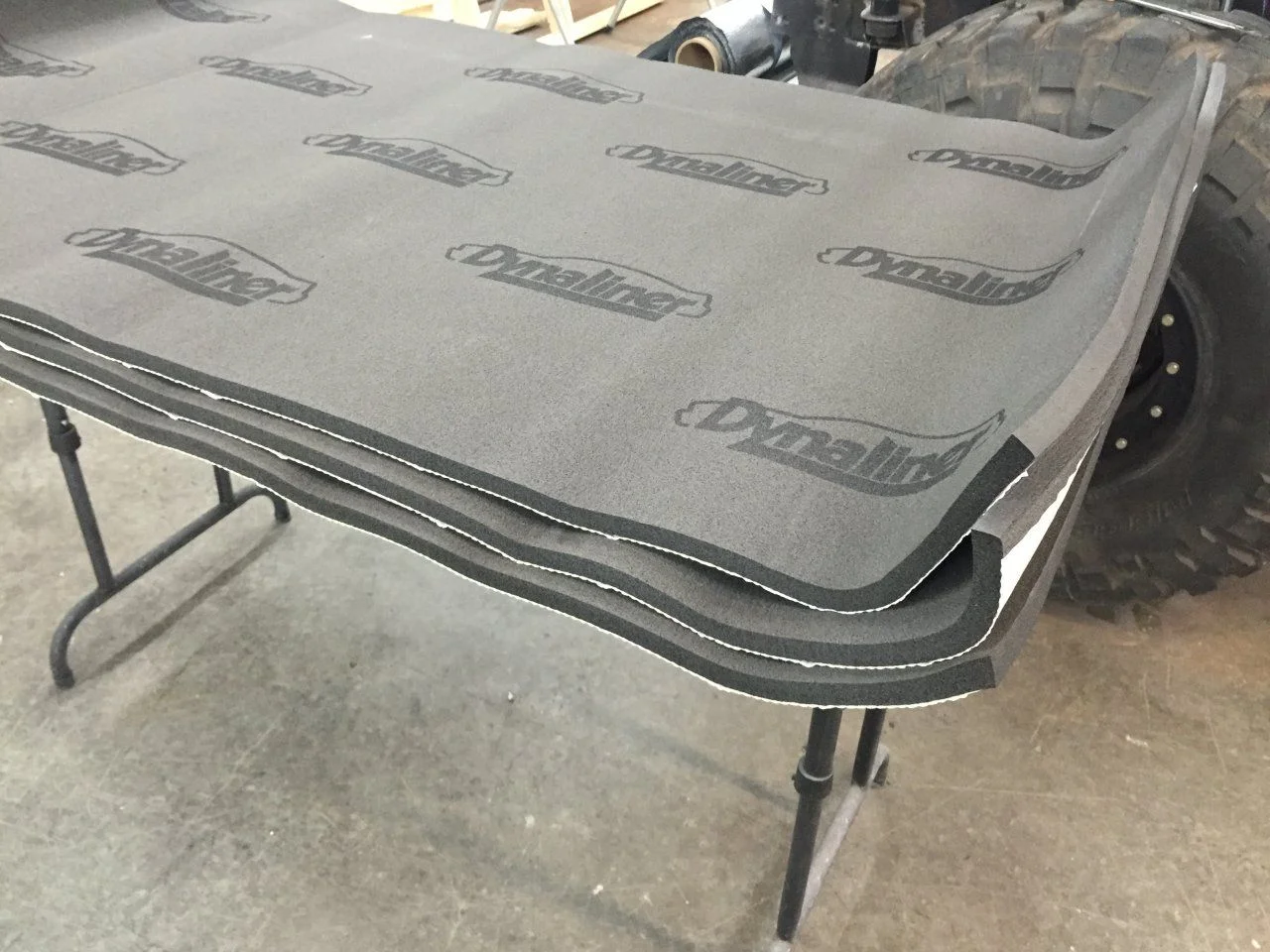

Now a question for you guys, before i put this stuff up.. ( won't let me put more pics again ) so.. I have Dynamat insulation for the roof and plenty of cruisercrap left, should i put some up before the dynamat ???
I think it is too heavy. With the heat + weight = sagging or possibly loosing all purchase and falling off.
@mmw68 might have a better insight to this.
J
Your correct... The 80mil is heavy, and I don't recccomend using google on the roof. I have had people use my 50 mil in the roof, but I still don't recccomend it. I would roll on a bead liner to deaden the vibrations of the metal, then use a light weight heatsheild. I have a heat shield product I like, I'll dig up the link for you later today.

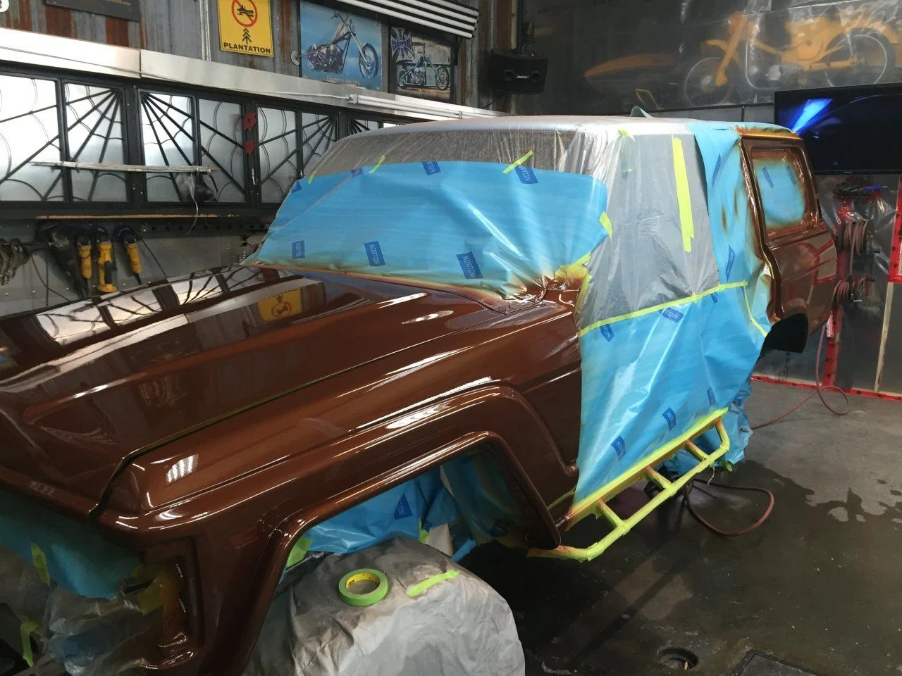

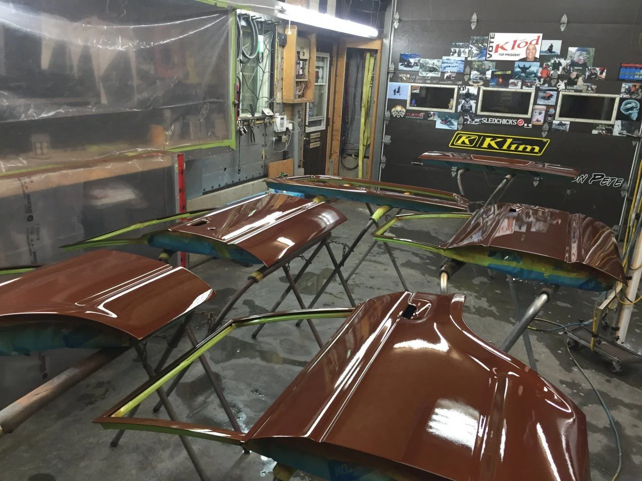

Waiting for the paint to get hard? well... i can understand that.
And it looks incredible. Remind me, what is your color?
474 copper poly, and thank you !! :beer::beer:
