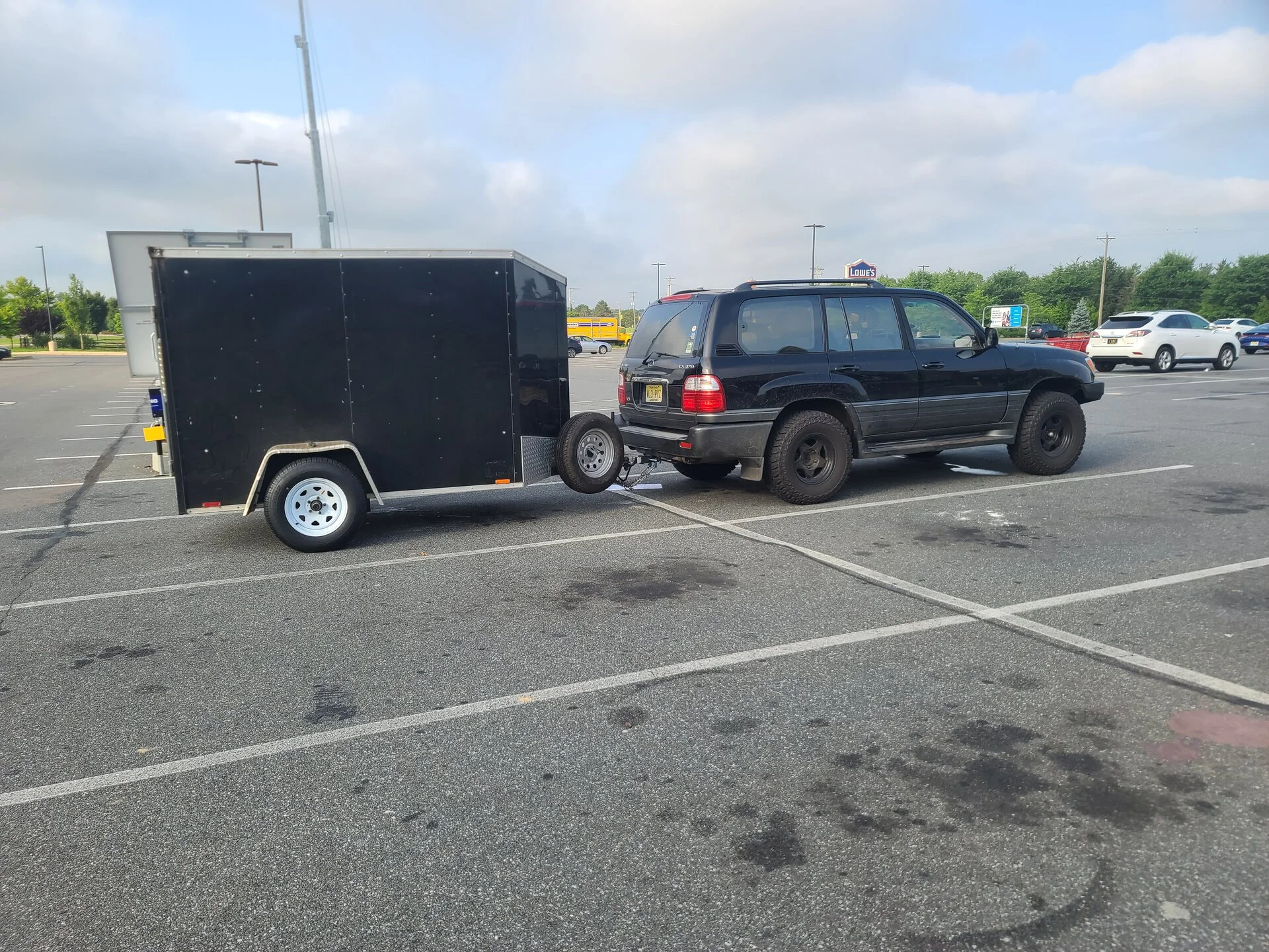

I bought a 5x8 enclosed trailer to help with my move a few years ago. It's been so useful, I ended up keeping it. I only wish I got a bigger one with a side entrance too. Recommend getting some airbags to help keep it level. I dont have them in this pic. Only reason I'd change to a pickup would be for more towing capacity.
+1 to all of this. I have a 6x10 single-axle and I feel as if I need airbags when loaded/towing, but it's plenty of pulling/stopping power for what I need. Keep the load balanced (10-15% tongue weight) as the Hundy doesn't seem to like too much weight on the hitch.

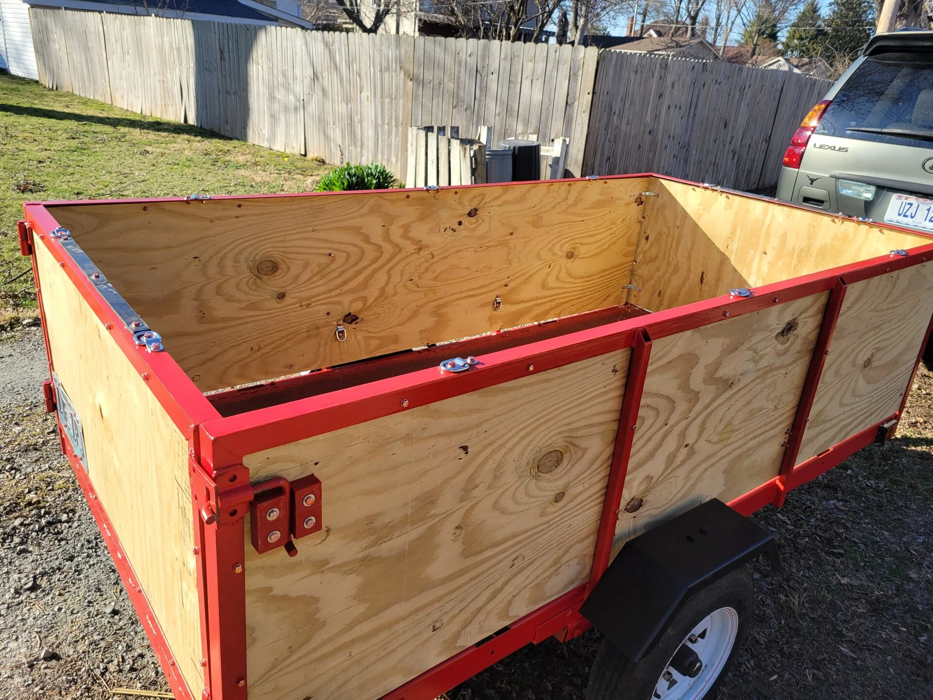

I bought the non-folding one of these in 2015, when HF still had 20% off coupons. It cost around $250 and I spent another $250 in plywood to give it 2' sides.
It proved to be very useful and was towable behind a Subaru Forester and is not really noticeable behind my GX. It has been great for hauling lumber, limbs/debris, mulch, etc. I've also used it to haul tools out-of-town for various projects and made it water-resistant by draping a 6x10 tarp over it. It's held every tool I needed to rebuild a deck and then a covered deer stand. I've never needed a truck. It's also a light enough trailer that I can easily un-hook it and move it by hand when it's unloaded. It makes it very easy to move around and put it in a out-of-the-way area.
The plywood eventually rotted out due to me leaving yard debris in it a bit too often. So this past winter I rebuilt it with a diamond-plate steel floor, angle-iron sides, and a swinging rear door (along with extending the tongue by around 4"). This probably cost ~$400-500 in materials but still beat buying a new/larger utility trailer.

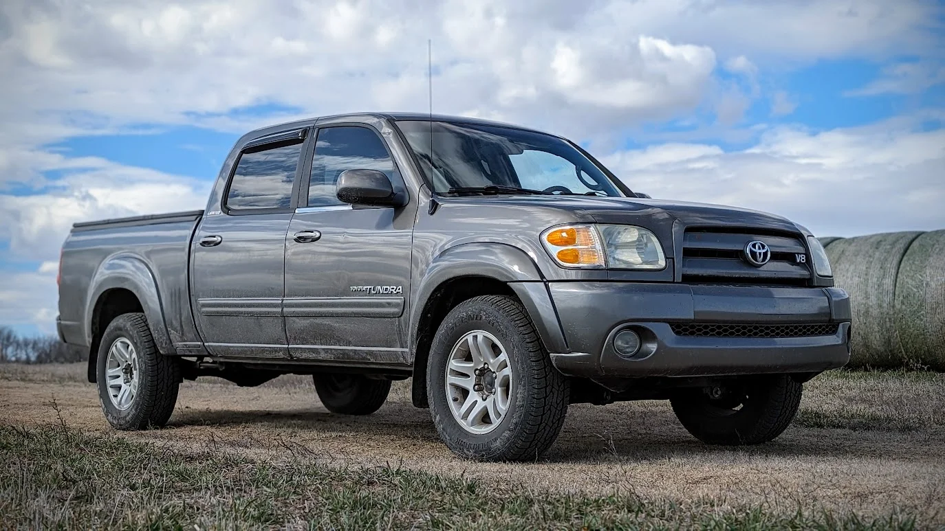

I added this best gen Tundra to my fleet at the beginning of the year. It is sooooo much easier than dealing with a trailer. Now when my wife and I go to town we take the Tundra if the haul will fit in the bed. The form factor is smaller than the 100 (or 200) + trailer and easier to manage. That said, the trailer is far superior to the truck when it comes to moving yard waste (primarily limbs).
I am growing very fond of this truck. It drives smooth like the 100, but feels way more peppy. At 277k miles I have dropped a lot of new OEM parts into it to keep it on the road. The 4.7 required no new knowledge to maintain so it's been easy to work on.

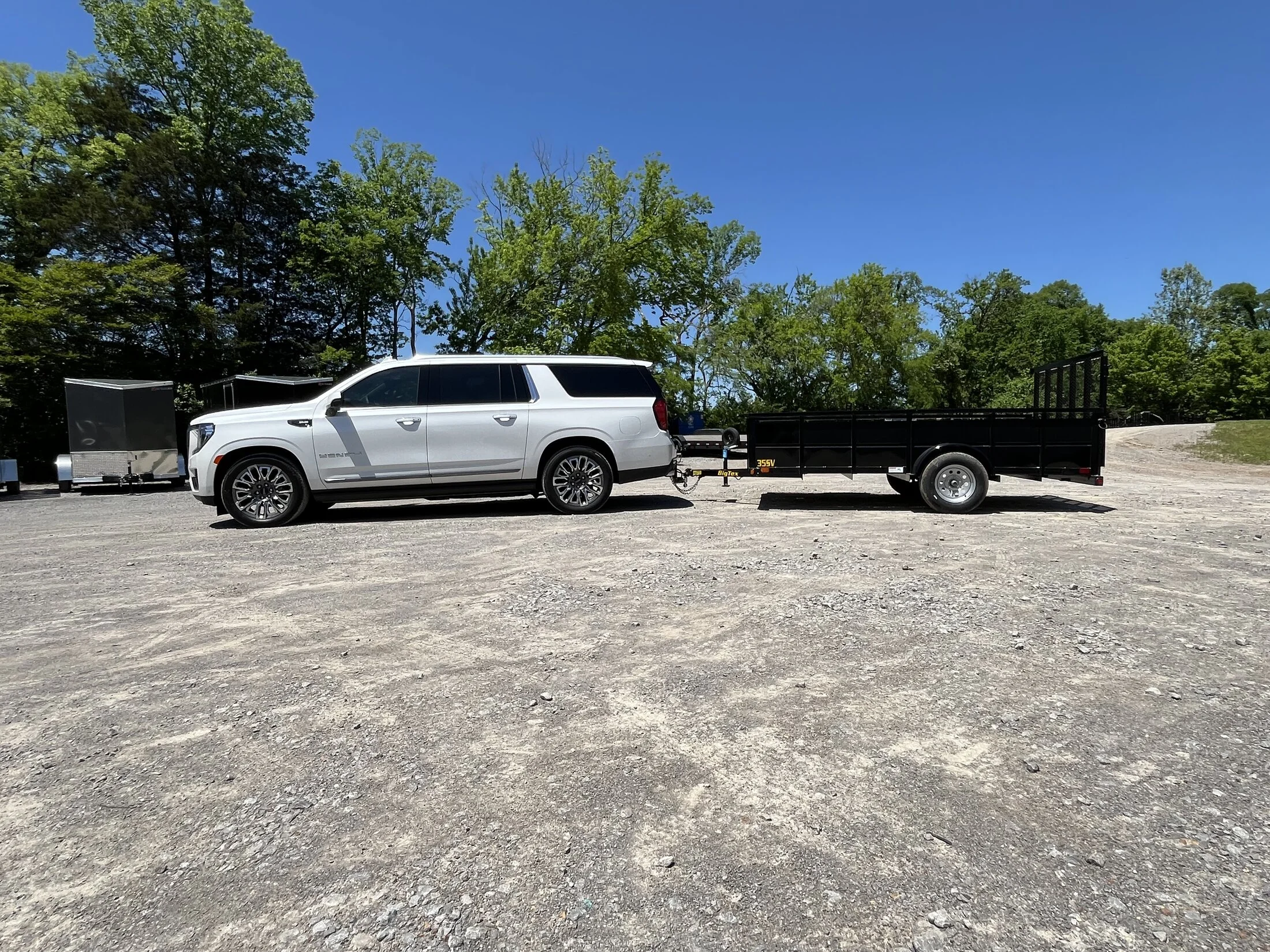

While the tow vehicle changed I went with a 77” x 12’ single axle.
Love the concept and will update my experience of an SUV + trailer combo.

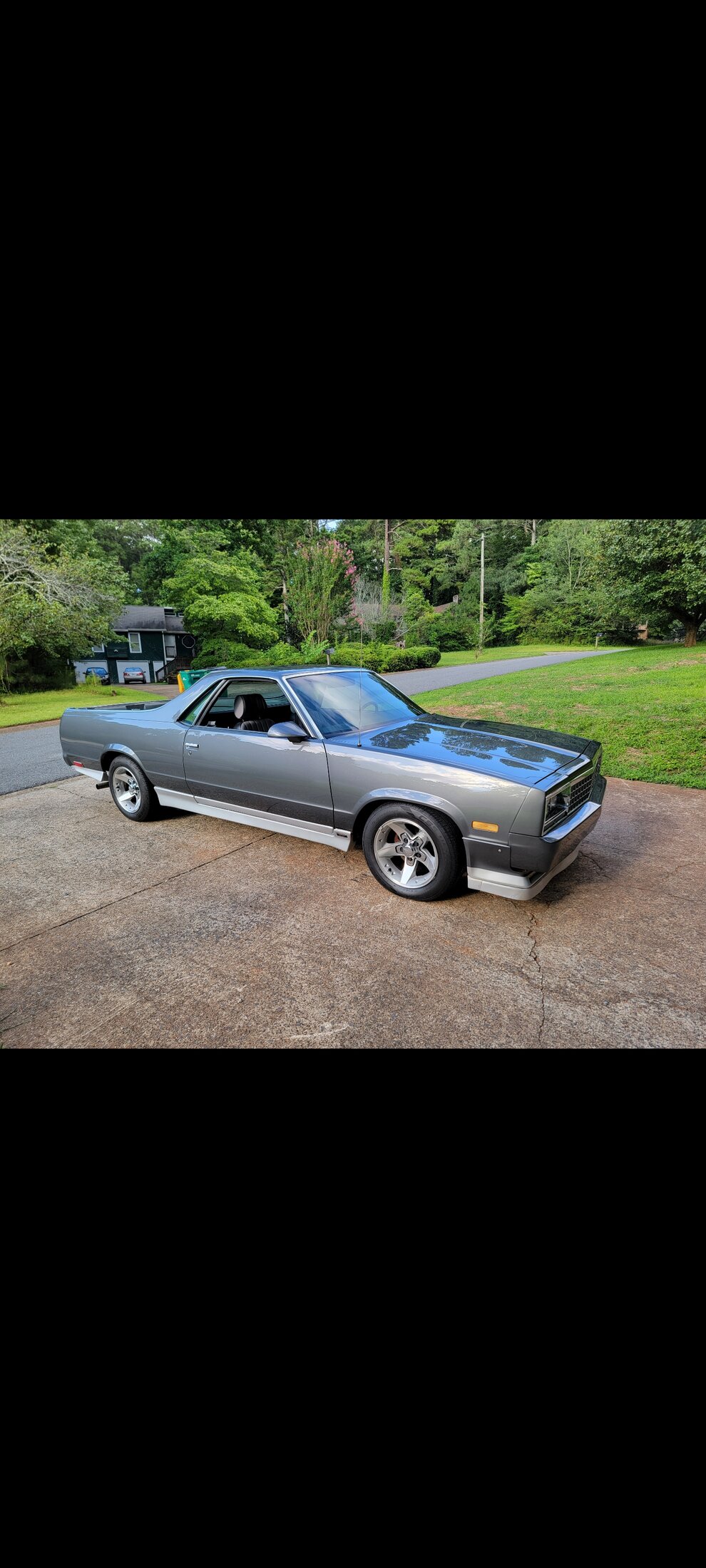

Please post a pic of the El Camino !!!
